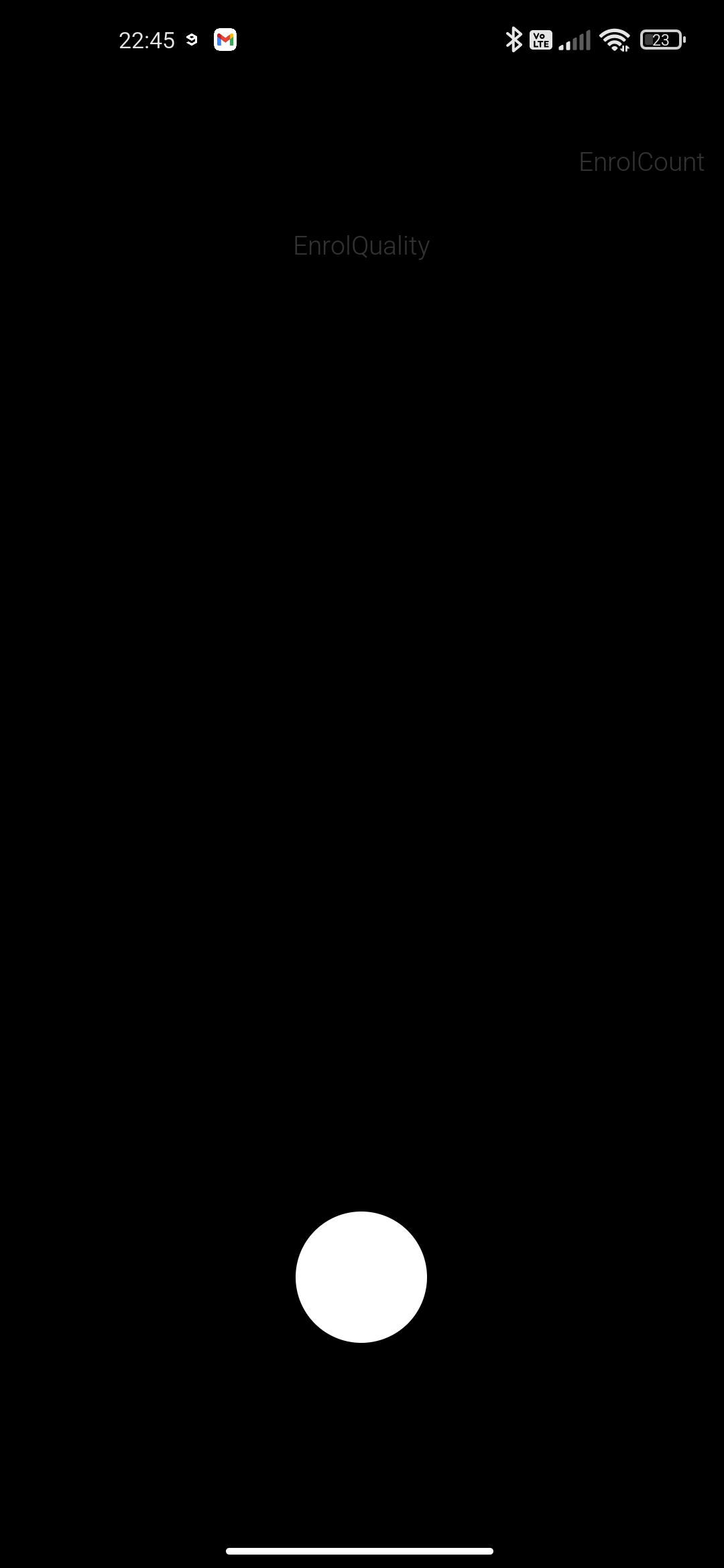

Hi i tried it but on White circle it just stays like that
