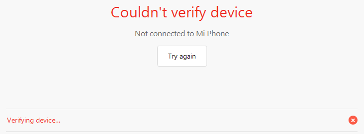

Hello, I 'm trying to unlock the bootloader of my redmi 3s Pro already have asked the code but when I use the My Unlock program I get the following error. : Any recommendation?
Edit: i have unlock succefuly, was a problem of my pc with the drivers intalation.
Glad to hear you sorted it out.
