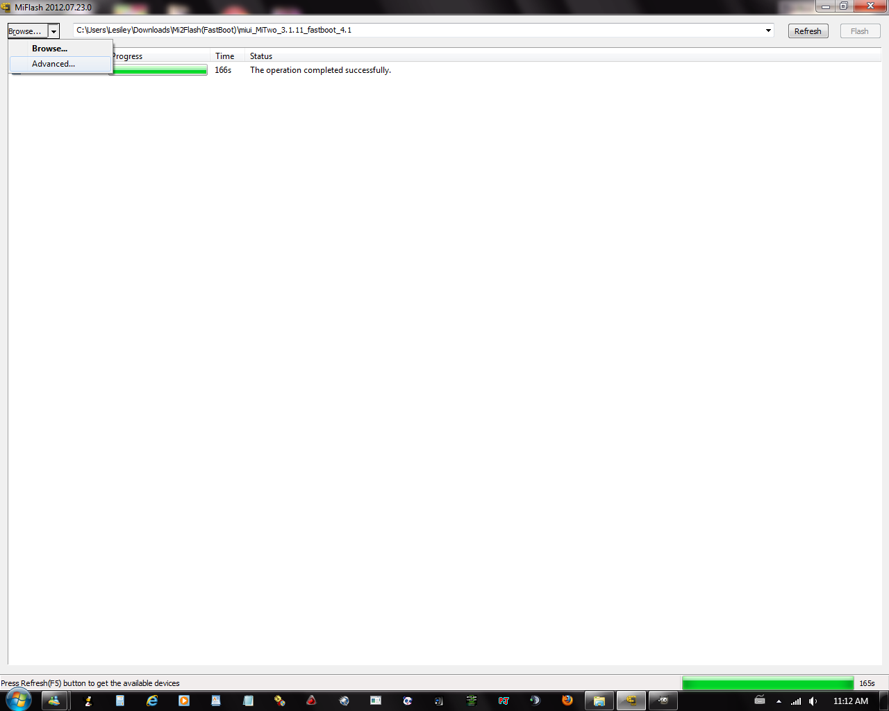

to set the script press the little arrow next to the browse button and click on advanced

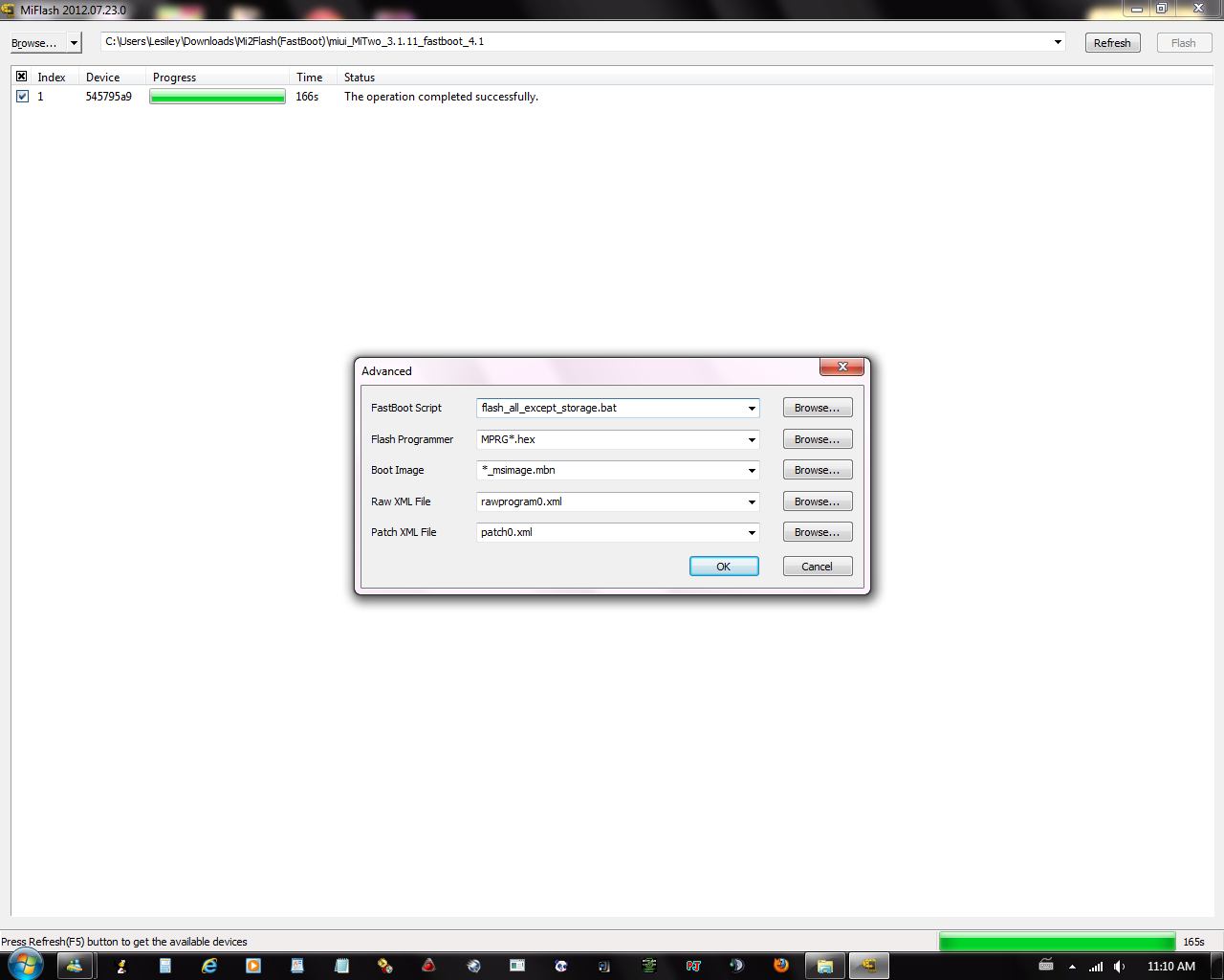

in the new window enter the name of the fastboot script you wish to use like so
