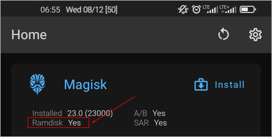

If ramdisk shows "yes" only patch and flash boot.img, not recovery.img

you only have to do this if you dont have a ramdisk:
# fastboot flash recovery magisk_patched_recovery.img
If you have a ramdisk:
# fastboot flash boot magisk_patched_boot.img
does the Mi 9 Lite / Mi CC9 not have a ramdisk ?
Reactions: Birraque
Thanks!
I added a disclaimer now, I didn't do so before because I assumed that with the same device and rom ramdisk would always be the same.
Not sure if it is, but it's better to disclose it.
Reactions: katerpanne
