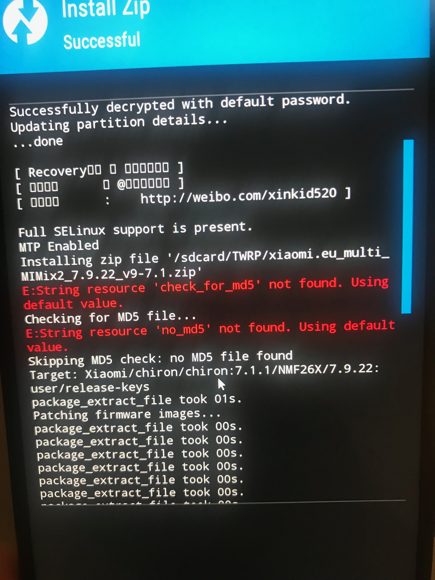

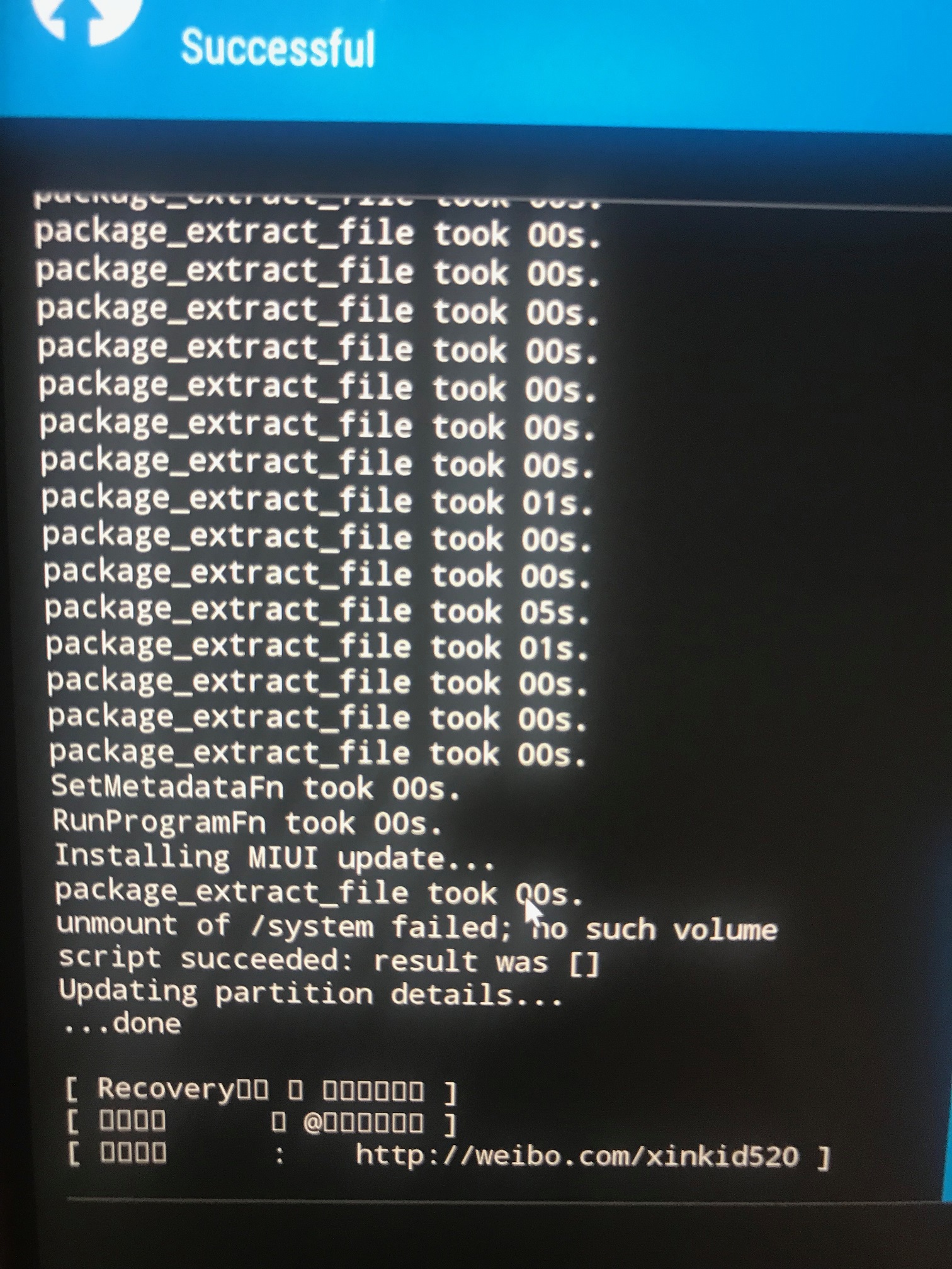

i wipe data folder but i think i got "bootloop" when I reboot after installing rom i still see mi mi.com powered by android.
Could you help me?
Could you help me?
Follow the instructions. Go to the wipe menu, there's a further box you can click to FORMAT DATA. Do that and you won't have bootloop.
