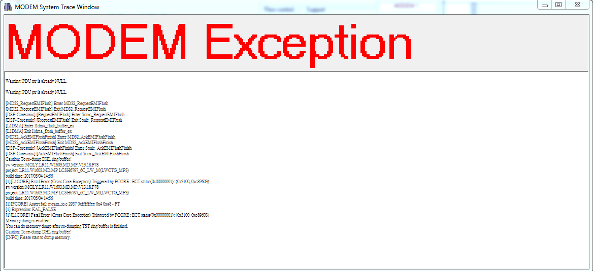

I try to restore my IMEI with "Maui META" but i have a error:
MODEM Exception
Warning: PDU ptr is already NULL.
[MD32_RequestEMIFlush] Enter MD32_RequestEMIFlush
[MD32_RequestEMIFlush] Exit MD32_RequestEMIFlush
[DSP-Coresonic] [RequestEMIFlush] Enter Sonic_RequestEMIFlush
[DSP-Coresonic] [RequestEMIFlush] Exit Sonic_RequestEMIFlush
[L1DMA] Enter l1dma_flush_buffer_ex
[L1DMA] Exit l1dma_flush_buffer_ex
[MD32_AckEMIFlushFinish] Enter MD32_AckEMIFlushFinish
[MD32_AckEMIFlushFinish] Exit MD32_AckEMIFlushFinish
[DSP-Coresonic] [AckEMIFlushFinish] Enter Sonic_AckEMIFlushFinish
[DSP-Coresonic] [AckEMIFlushFinish] Exit Sonic_AckEMIFlushFinish
Caution: To re-dump DHL ring buffer!
sw version: MOLY.LR11.W1603.MD.MP.V13.18.P78
project: LR11.W1603.MD.MP LCSH6797_6C_LW_M(LWCTG_MP3)
build time: 2017/05/04 14:56
[1][L1CORE] Fatal Error (Cross Core Exception) Triggered by PCORE : ECT status(0x00000001): (0x3100, 0xc89603)
[1][PCORE] Assert fail: nvram_io.c 2937 0xffffffee 0x4 0xa8 - FT
[1] Expression: KAL_FALSE
Memory dump is enabled!
You can do memory dump after re-dumping TST ring buffer is finished.
[INFO] Please start to dump memory.
Who can help me?

Flash stable rom with SPFlashtool,IMEI might be restored.I've read something on this forum Will post link when I can find it

    I use SP flash to re-flash an old version of the Chinese stable official ROM v8.0.1.0 and use the DB files from that version in SN Writer. Remember to use SN Writer v1.1648

    Thank you very much JRedmi!!
    Finally I did with your method.
    I tried with Maui Meta but didn´t work because gives my error loading the DB file. I did flash again with format and download and then use SN Writer v.1648, how you said, and the I got to repair imei.
