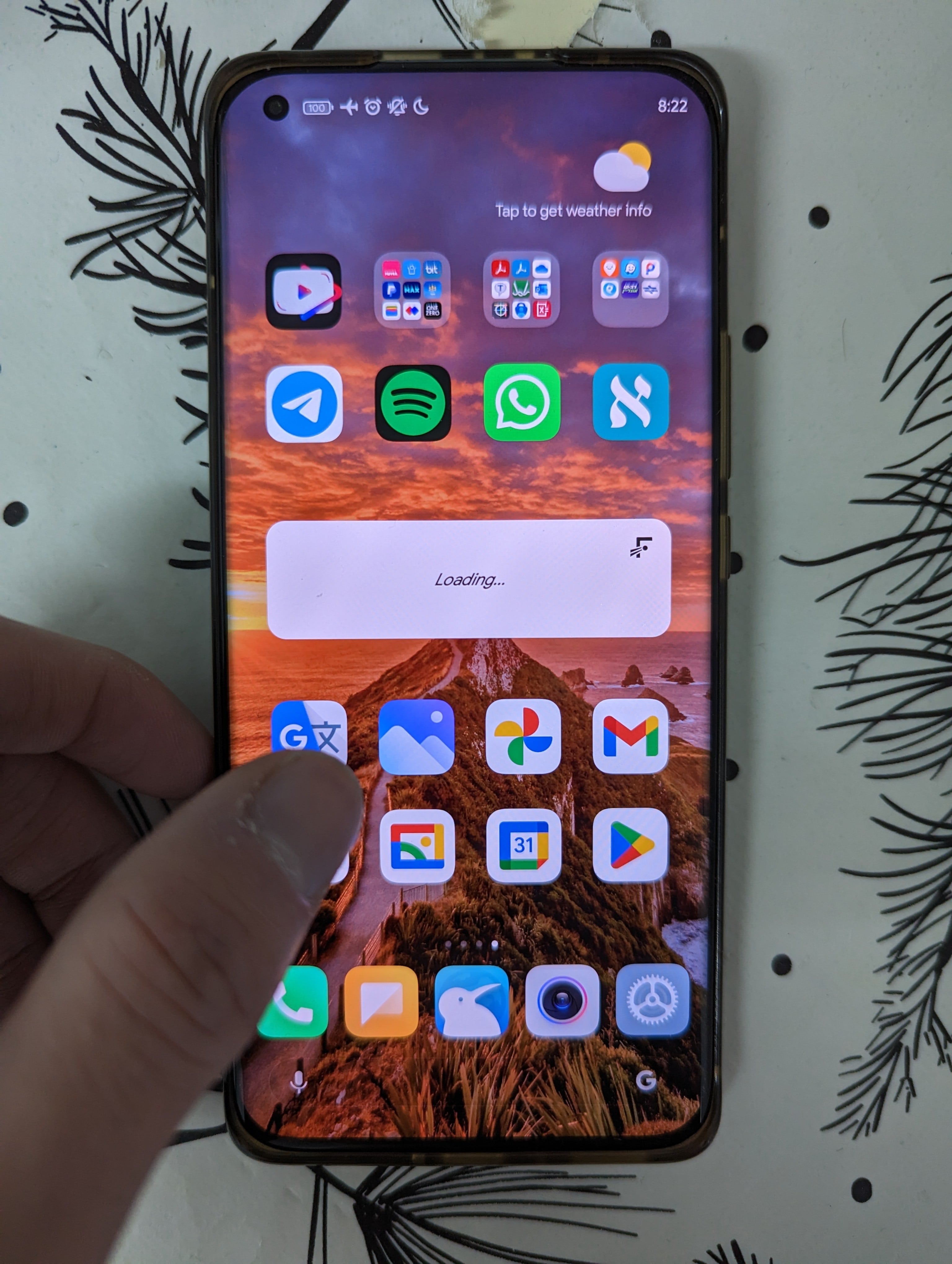

The device turns on today! I have no idea what his problem is, but he is alive. What reason does he have to get stuck on Edl mode, and then decide to turn on normally?

No idea but at least it's back working and it wasn't as bricked as you thought.
