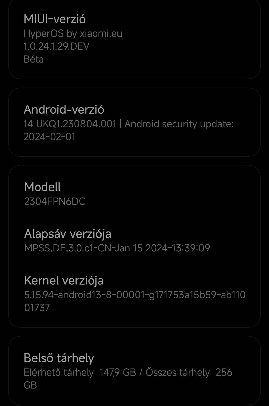

Hi, guys, I have the following / annoying issue: I'm having constantly problems with the Chinese hardware, and European software. The phone came from tradingshenzen with opened bootloader and twrp already installed. Since 2023 November Gpay has a chaotical behaviour sometimes tells that integrity check failed, somethimes it works. I'm bored with this, so I want to close the bootloader and install a stable working version of the hyper os instead of (actually installed) beta without taking any risks (bricked system). What steps do I need to do this?
Cheers: Mano
If you bought the Chinese version of the device, you can lock the bootloader only on the Chinese ROM.
You can install stock ROMs using Miflash.
