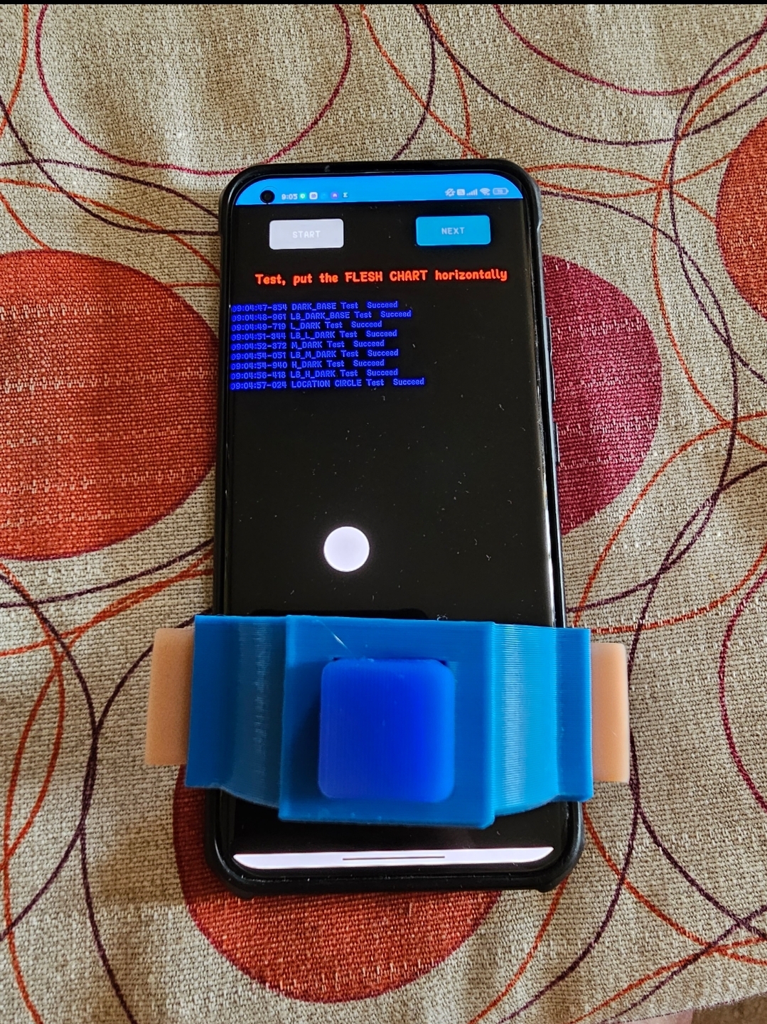

Hi everyone, I changed the display and tried to calibrate the fingerprint but I keep getting a decentralized circle on the third step, the "put the flesh horizontally" one. I have the calibration tool, the circle shows correctly for the first 2 steps then it is shown as a smaller one in the middle left of the screen, if I tap on next it reappears on its proper place but the test fails. Any help?

and, did you try to put the flesh colored stamp with the horizontal lines where the FOD should be and not in the location it shows ?

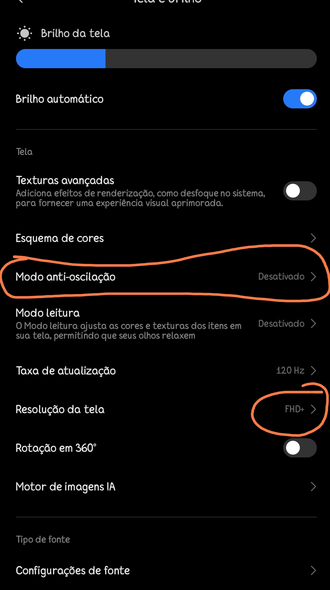

Coloque a resolução da tela em FHD+ e desative o modo anti-oscilação, deve resolver o problema do círculo no local errado.
