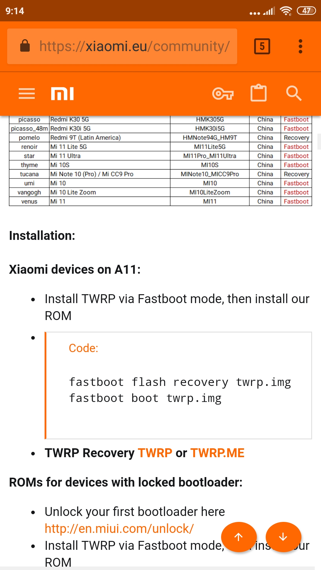

And for you answer, I made a screenshot, it says devices on A11, and gives only instructions to recovery flashing, below, not visible in the screenshot, devices on A12, and there they give fastboot instructions.

No need to keep old ROM. Not a good idea to downgrade and stock may stop you with anti rollback anyway.
Don't worry about twrp, there is no A12 twrp yet for this phone. So unless you are stating A11, leave it for now.
All A12 downloads are using fastboot versions, so just download the ROM, extract it on your pc, connect your phone in fastboot mode and double click the update ROM bat file to update. Just leave connected until it reboots as some parts of the update take ages and it looks like it stalls, it hasn't, just wait.
