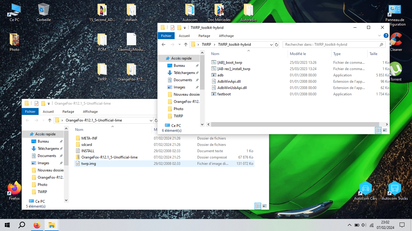

I'm coming back to you because I tried it tonight with your metods but I have a problem...
I do :
- ABD and fastboot installation PC.
- Installation xiaomi drivers on PC.
- Bootloader unlock et USB debunged.
- ROM stable ISHTAR on racine of Mi 13 ultra.
- Unzip TWRP toolkit
- Donwload TWRP (OrangeFox-R12.1_5-Unofficial-lime)
- Change name of Recovery.img on twrp.imget and put in on the TWRPtoolkit folder.
- Start phone in fastboot (power and down) and connect USB.
- Start installation with "[AB-rec]_install_twrp"
- After I have message : Installation down, disconect and reboot with Power and Up.
- But after, Phone boot on Miui Recovery 5 and not on TWRP.
Have I forgotten a step or missed something ?

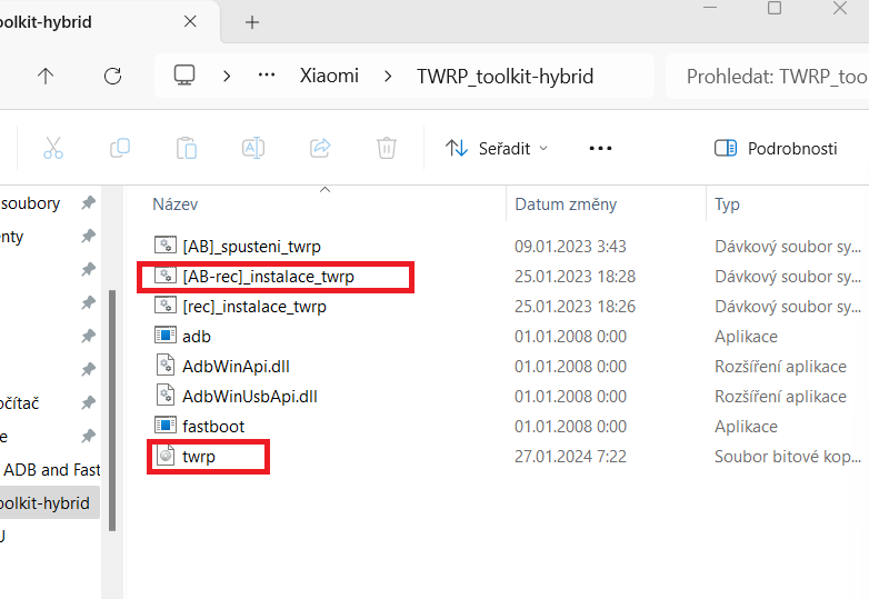

Which TWRP did you use?
Show me the TWRPtoolkit folder.
"Xiaomi.eu GPay Module download" is installed on the mobile as an application in the file manager.
Read the instructions in the manual carefully and follow them. Don't make up your own.
Does not follow instructions. You are mixing different procedures together.
You can use TWRP or Orangefox, not both (you used OF for another device).
Xiaomi 13 Ultra = ishtar
- Download TWRP for your model.
- rename to twrp
- put in TWRPtoolkit folder
- run the script "[AB-rec]_install_twrp"

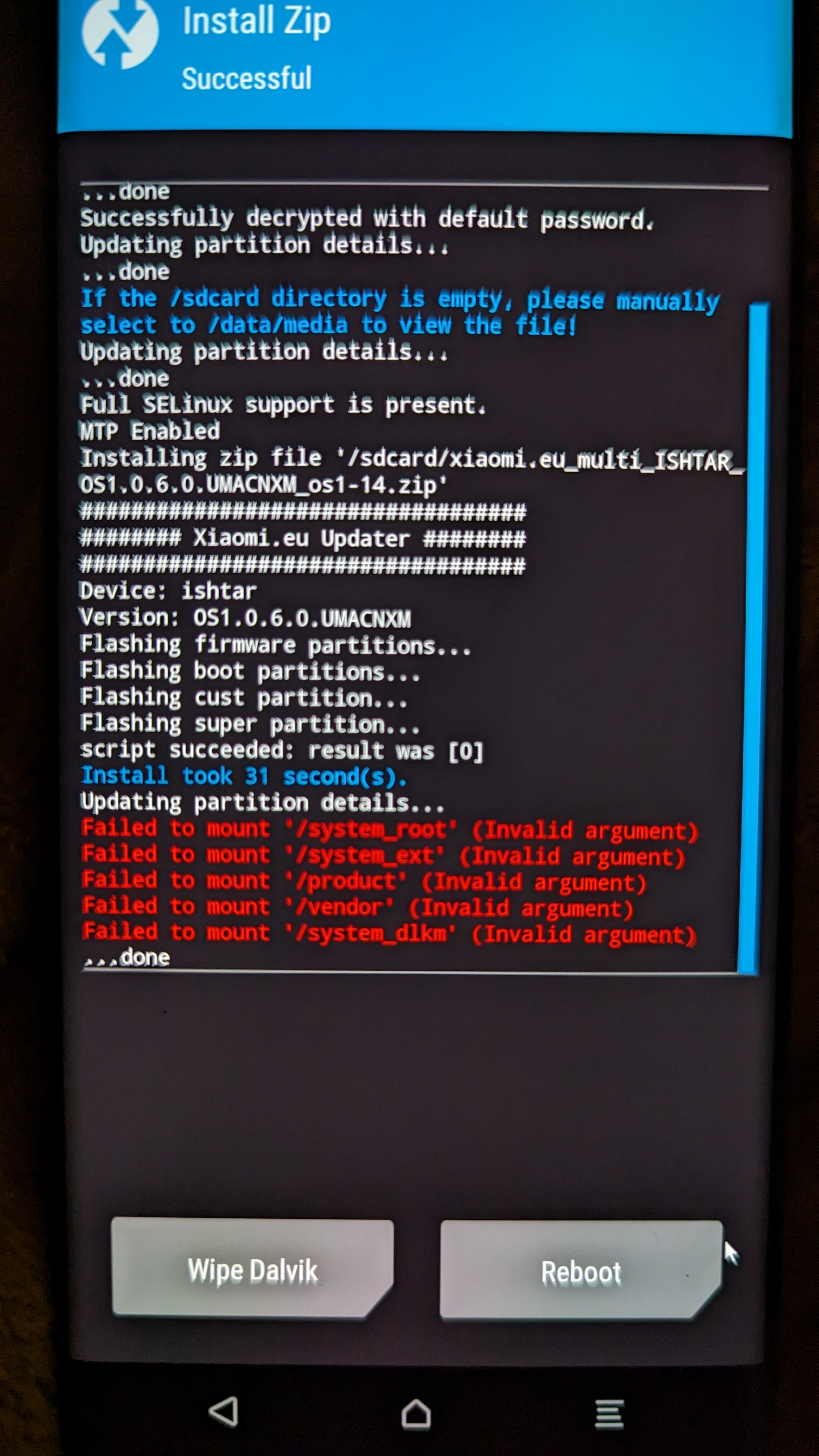

after instalation i have :
Failed to mount : (invalid argument)
system root
system ext
product
vendor
system dlkm
I choose Wipe dalvik or Reboot ?
After, I have to continue your tuto with Format Data, card/wip... ??

TWRP do flashing and after I have this :
The ROM installed correctly. (The error occurred due to imperfect TWRP)
Follow these steps:
- reboot to recovery
- wipe > Format Data > yes
- reboot to system
