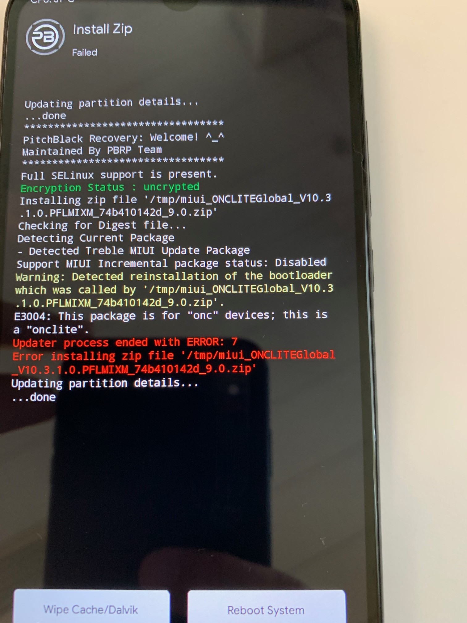

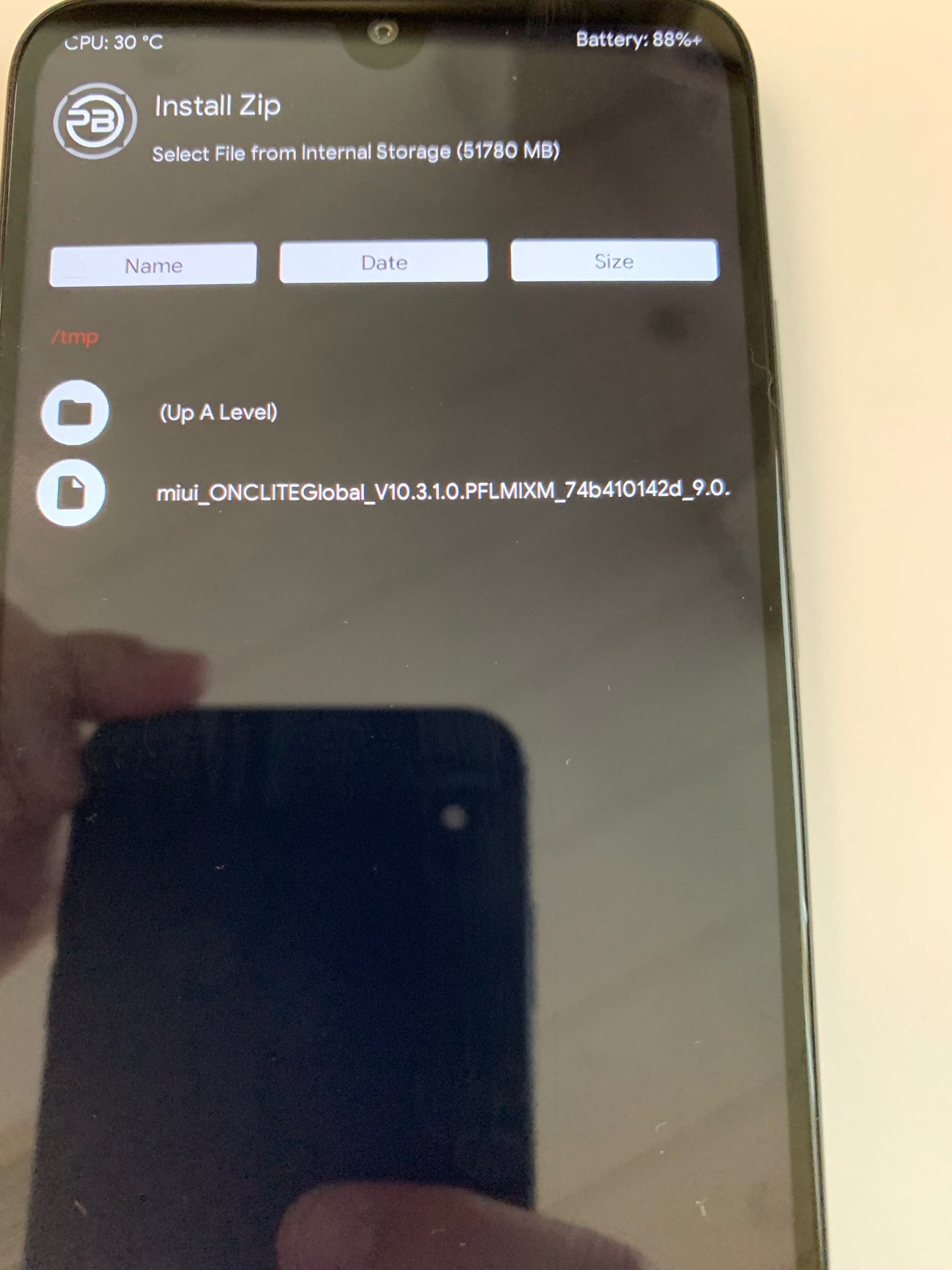

I finally managed to get Pitchblack recovery on my HM 7 permanently. However everytime I try to install a rom it fails with the remark ".... the rom is for onc and the phone is onclite" . No matter which HM 7 rom I try .
Anybody with a clue what is causing this ?
Tks
Tks
Just to make sure :) . I tried several versions of the onclite Roms. All with same result

The problem has been resolved :) changing twice the recovery from TWRP to Pitchblack and back to TWRP. And finally I was able to install the miuimix_ONCLITE rom. I used this one : https://c.mi.com/thread-2134048-1-0.html
Case closed :cool:
