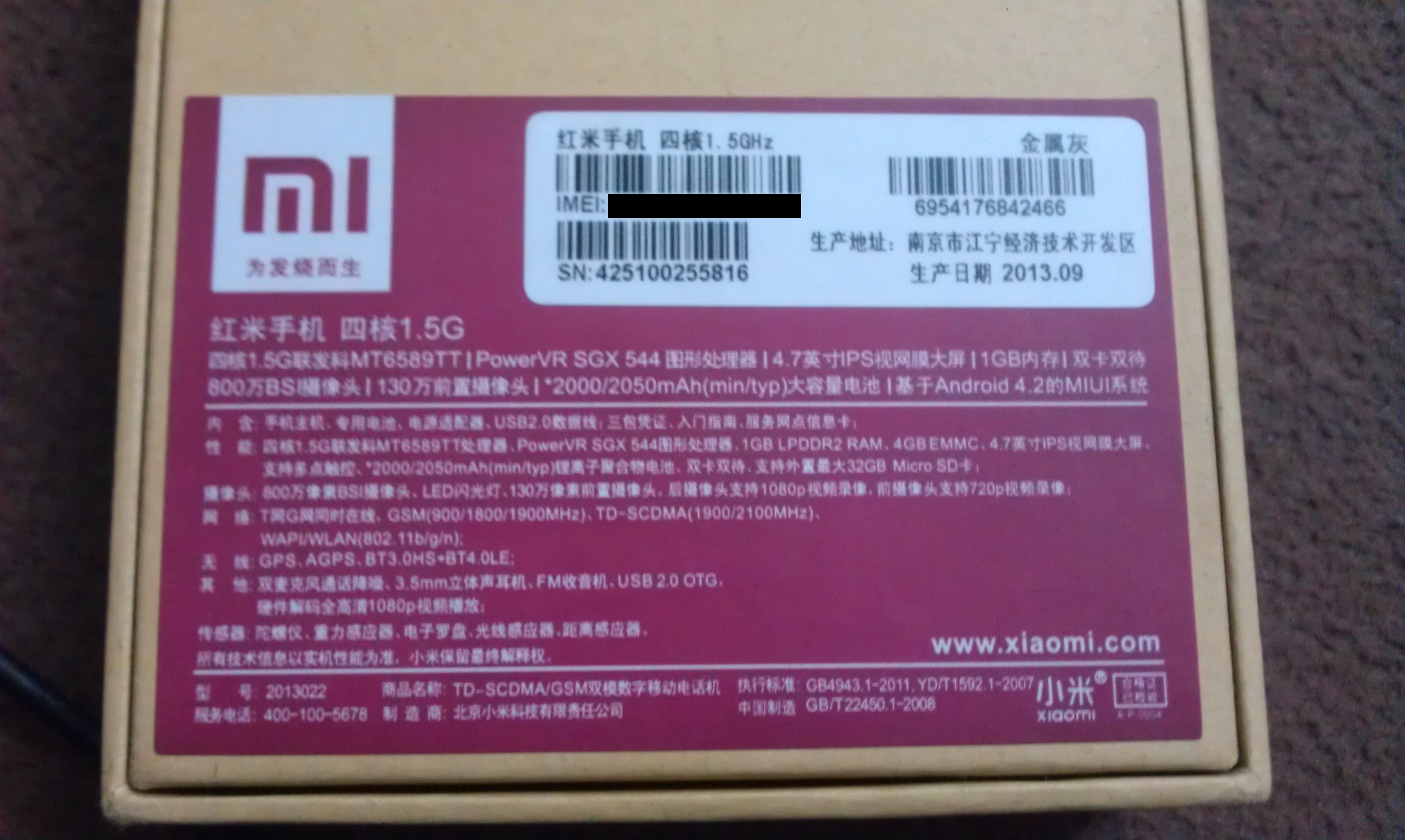

Where is the security code????? Cant find mine :(
I checked using IMEI and SN and it gives following statement
"This is a red-meter mobile contract version (gray battery cover)"
Help please!!!
On mine it is just above the website address at the bottom right corner.
You can see there is a bit of a gap on yours.

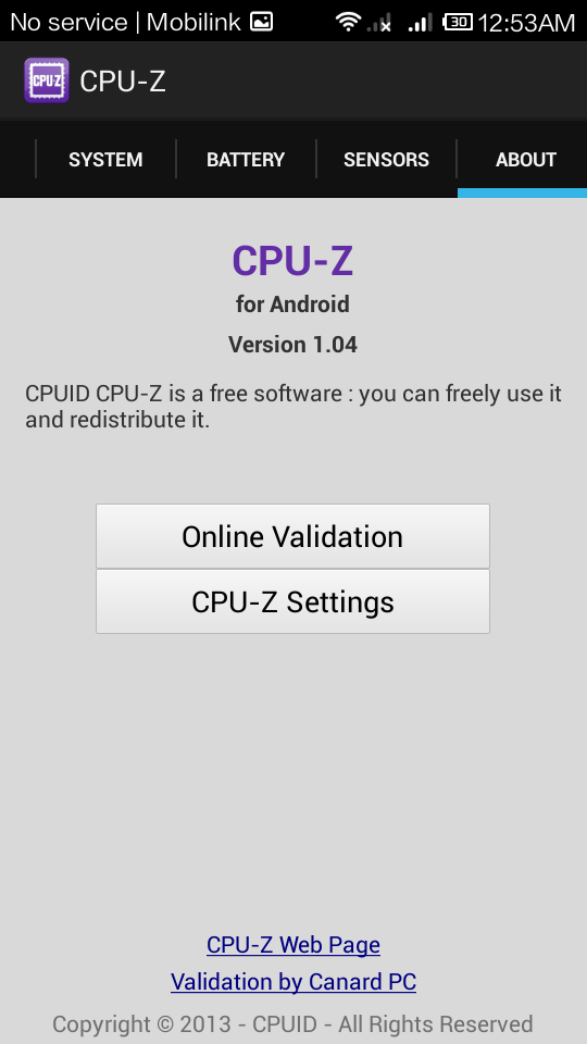

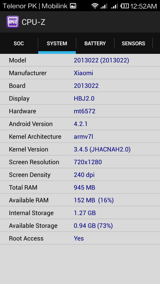

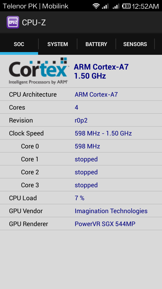

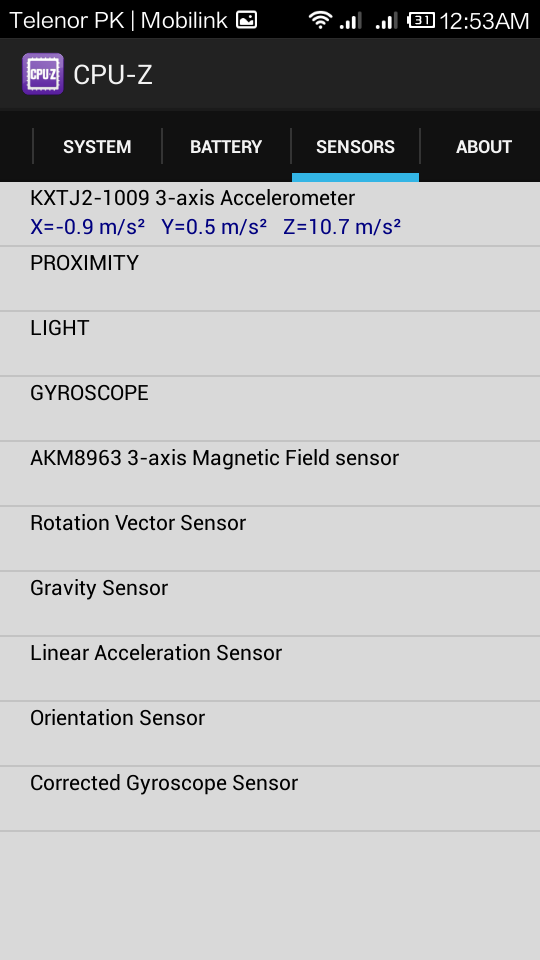

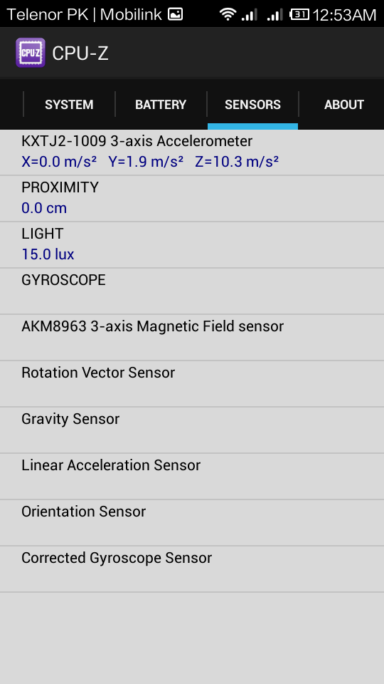

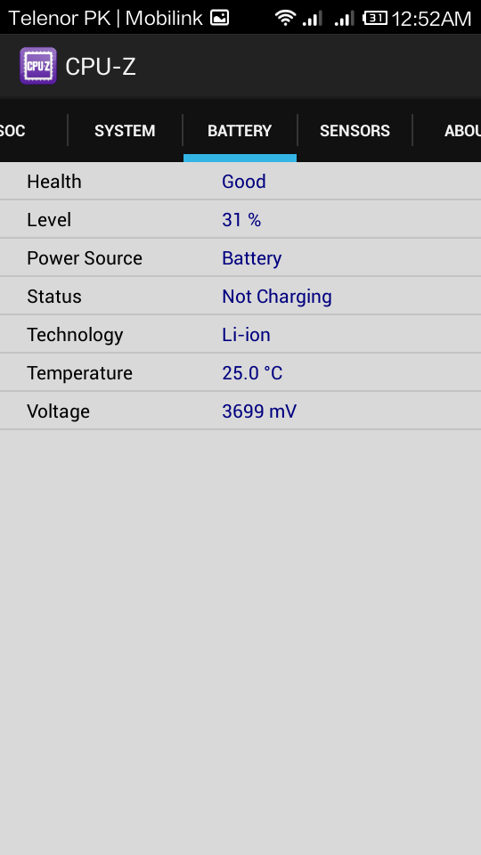

Tell me anyone is it real or fake.. I need to know...
Help anyone
I think it is fake. It is showing the wrong cpu.
But also compare score in Antutu. If there is antutu already installed, remove it because it will be also showing fake score. This can also happen when downloading from playstore. So it is not 100%.
