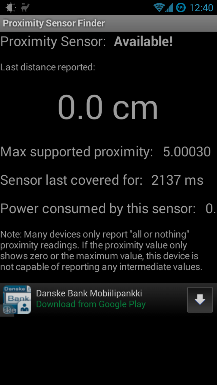

I have noticed the same behavior is tivac. As soon as I start phone call, the screen will go off. I tried to discover where it comes from and it's the proximity sensor.
I used app called "Proximity Sensor Finder" from Play. It shows 0cm distance always. If I put phone into very bright light the distance will show > 5 cm. So, it might be a calibration problem?

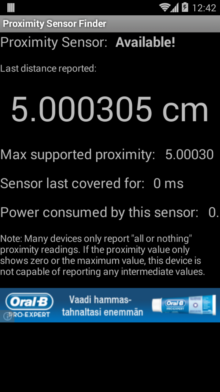

I have enabled TDB and installed Ivan's AOSP 4.4 on System2. Proximity sensor is working correctly with that ROM in any condition, so it's not a hardware problem either.
Could someone help with this problem?
The first screenshot is from CM10.2
and the second is from Ivan's AOSP 4.4.
- V-M

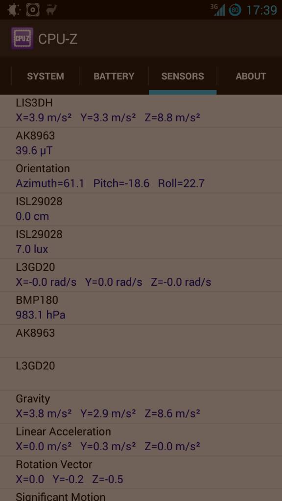

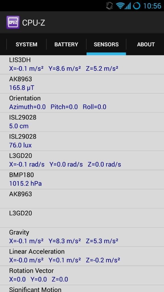

It's ISL29028.
Try CPU z
Sent from my MI 2 using Tapatalk
