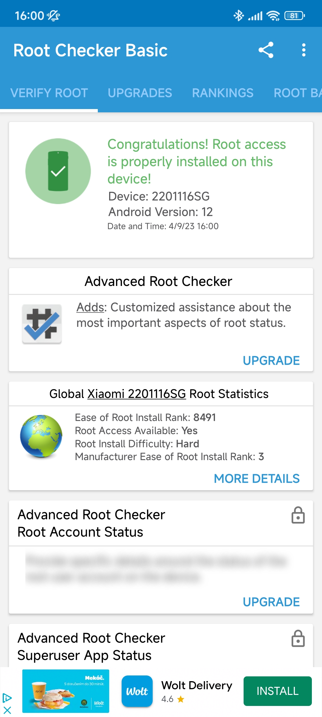

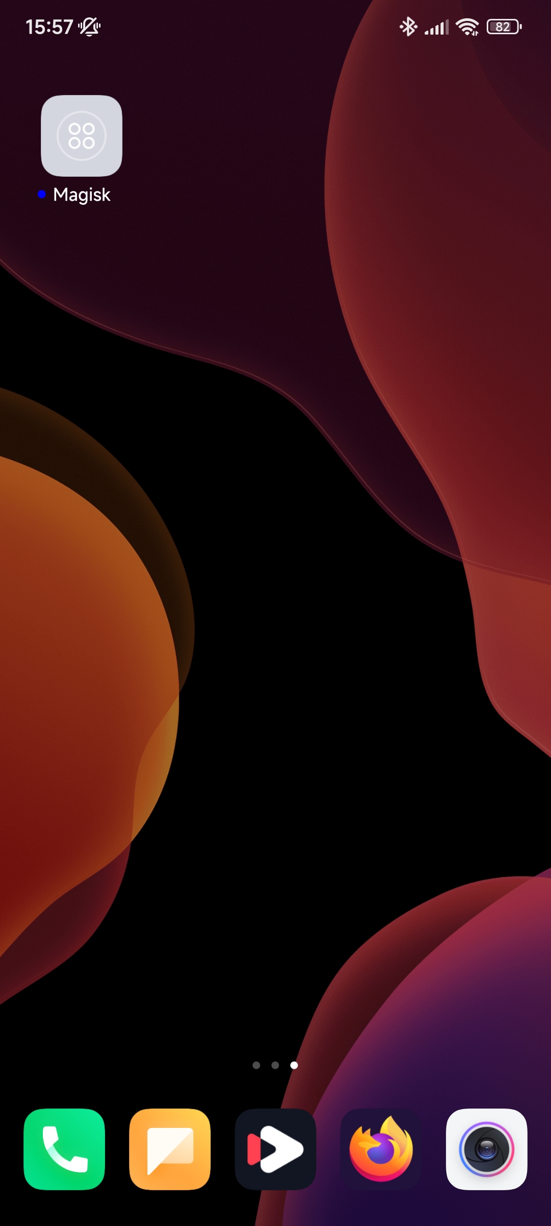

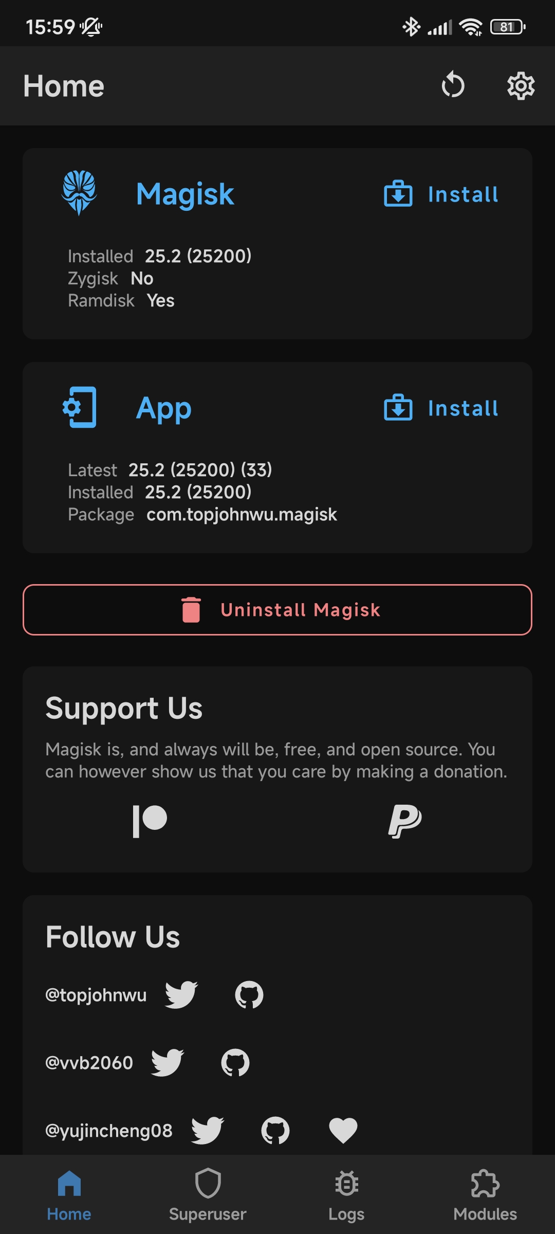

Just installed the TWRP and suddenly Magisk appeared and Root Checker says my device is now rooted

the official TWRP never installs the root automatically unless it is modified and this is the case here since it is named TWRP12_mod.img.
