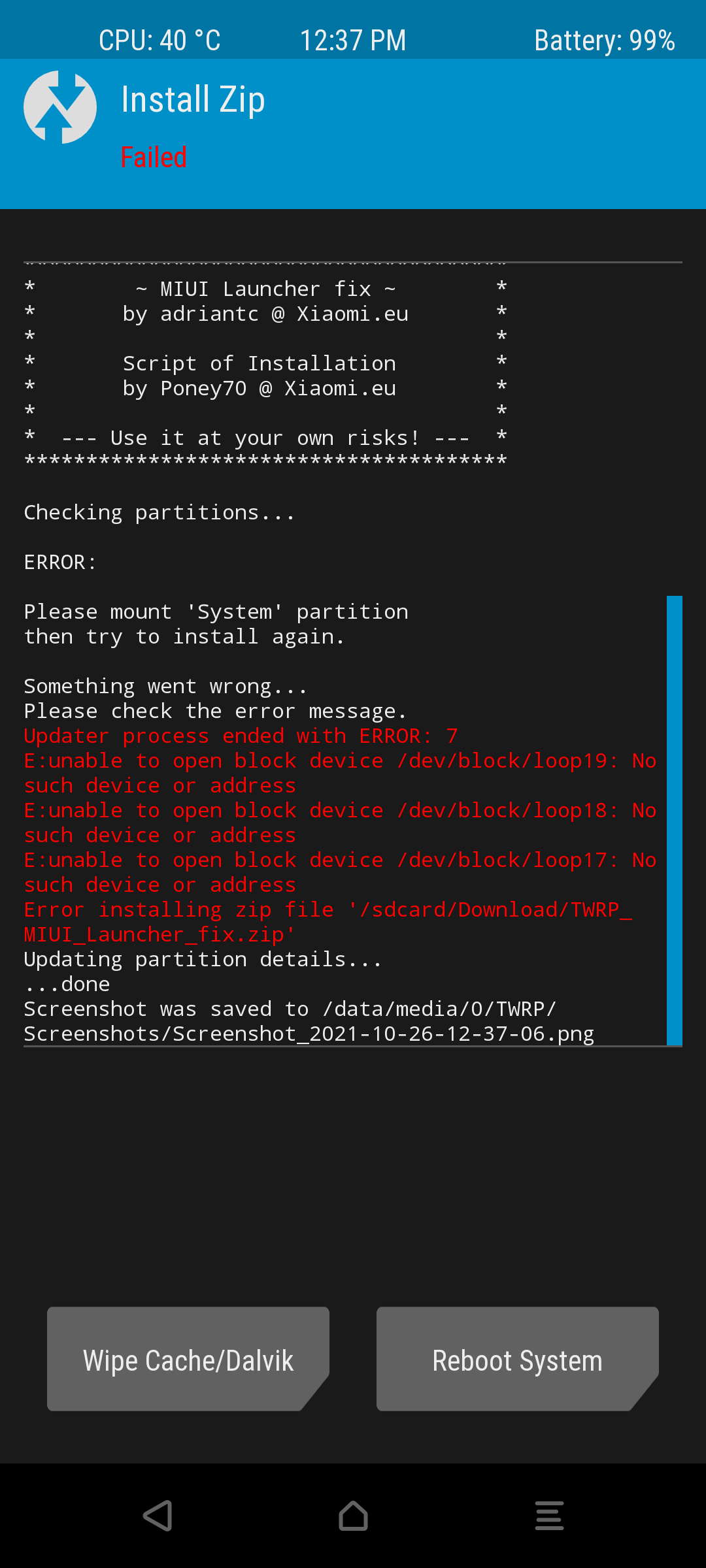

I have a problem with TWRP's version. Here's the screen with the error.
You have a recent device so it has the new dynamic partioning system => System partition is in forced Read-Only mode, TWRP can't modify the content of this partition... ;)
