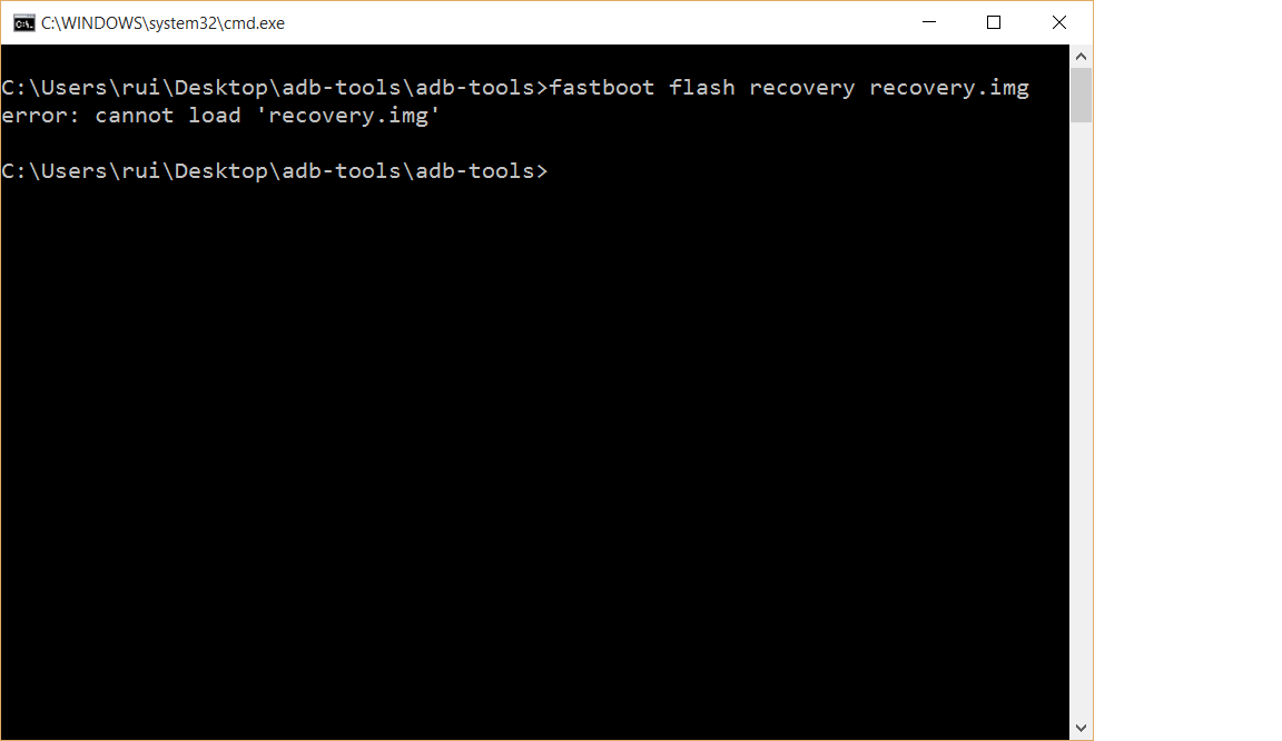

    i followed that guide and this appeared in the final step.

    Hello, you renamed the internal file? recovery.img

    When you type fastboot devices, the PC sees the phone?

    no, but i think i got it right with some tutorial and installed twrp but now i can't reboot my phone to safe mode, in neither way

    Right, trying to enter twrp makes my phone stay all black( i reinstalled twrp as recovery.img) and not entering it

    It wotked right now, im using twrp 2.8.7.0. So what do i do know?
