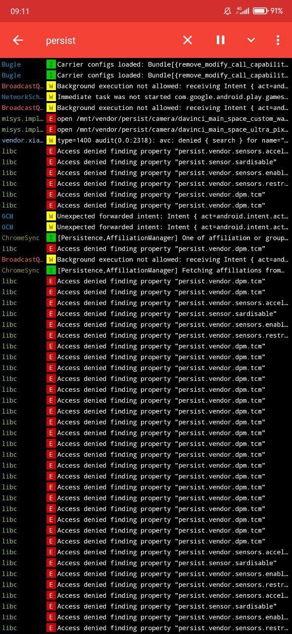

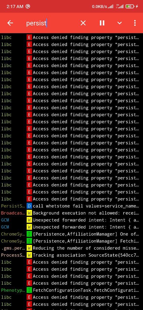

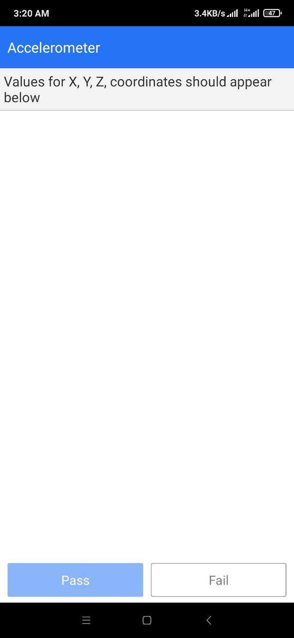

Clean flashed latest version on my global Mi 9T and sensors are not working.
FP does work, but gyroscope is not working for example, since auto-rotation doesn't work.
Persist partition was NOT wiped. I confirmed that already.
Attached is an error that might be useful for fixing this issue.
Thank you.

There is no issue on Mi 9T, you messed up something on your phone. ;)
Which TWRP version did you use?
I don't think I did... I'm using official TWRP. Clean flashed.
You may need to reflash fastboot official Global ROM to fix your persist partition.
I can't tell you exactly what to do, I never had this issue.
EDIT: Can you check Widevine level with "DRM Info" app? Still L1?
On .EU ROM?
