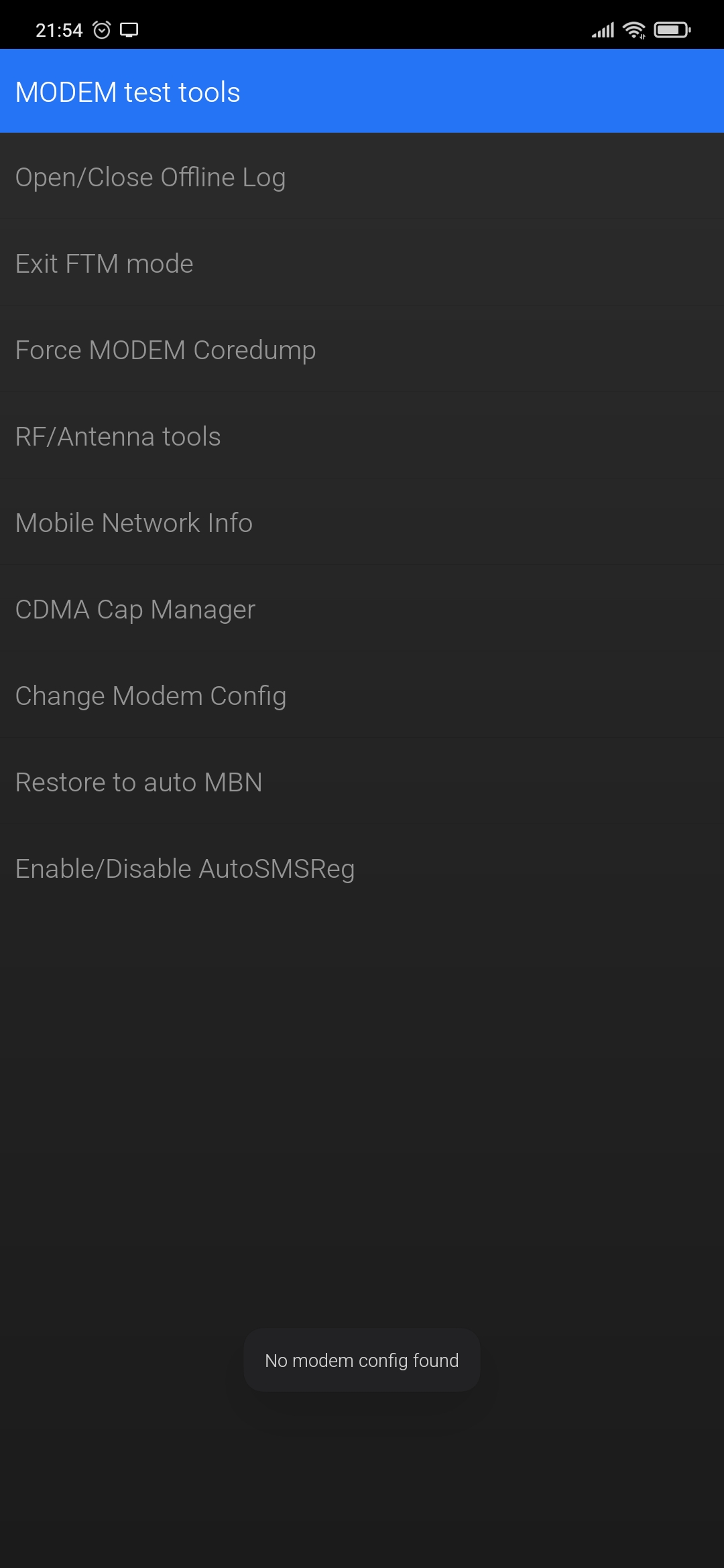

Issue persists on 20.5.21, based on trying to update the MBN on the phone (and the PDC tool method not working even after importing an MBN...) I think this ROM (either china dev or xiaomi.eu) must be missing the proper modem configs.

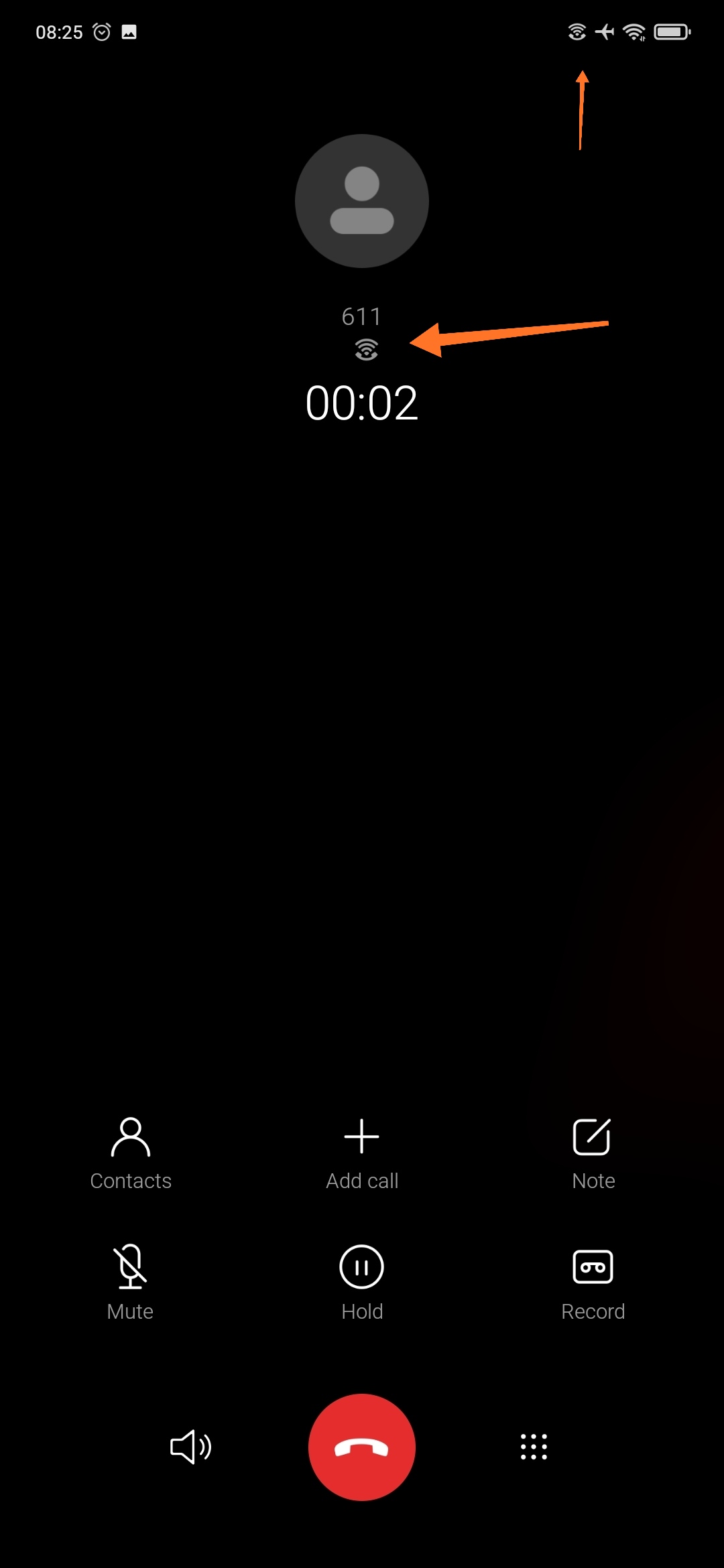

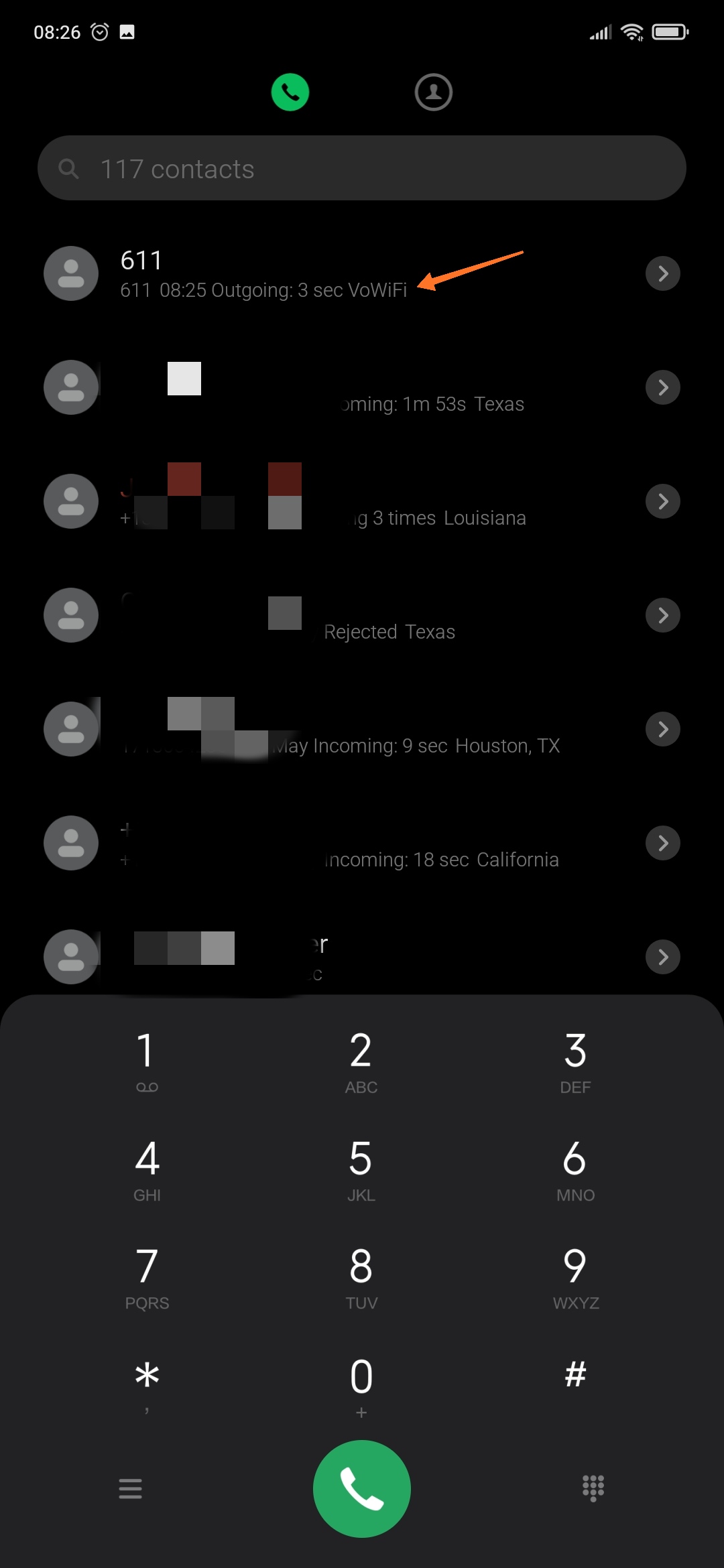

I was able to get a part of it working!
I was speaking with a friend and decided to flash some firmware from other versions of rom for my device, since when I first got the phone it was working, I tried the firmware from the version of the rom my phone started on as well as a couple other versions from EEA and Global variants. On the first boot after the initial firmware change, I saw the wifi calling icon appear! But, it went away and IMS registration reflected only VoLTE was available. No other firmware version got it all working, and in fact my fingerprint sensor stopped working so I took a backup of my modem partition and flashed back the firmware for 2.5.14, when I booted volte had stopped working but fingerprints had returned, so I restored the modem partition and aha! Now volte at least was working, though I don't have any status bar icon for it..
It seems what you are stating is the case, cause if this modem was working on the europe rom that came with the phone, it seems now reason it shouldn't work on the chinese variant.
Just coming back now to report I got it half working! But only in the most frustrating way possible
On a whim, I was reading through a thread and someone mentioned "the only way to know wifi calling is working is if you turn airplane mode on and turn wifi on and make a call".
I already knew this, but I decided to try and check anyway even though everything said wifi calling was not enabled on my phone.
After turning on airplane mode and enabling wifi, at first the phone call didn't connect, but after a few seconds the wifi calling icon appeared! And a call was able to connect! When I checked IMS status it showed wlan calling was available, but everything else was unavailable, the opposite of normal (shows not registered with all unavailable, or registered with just volte available after my modem flash).
Unfortunately after I turned airplane mode off, the icon went away, and IMS status returned to showing wifi calling was not available. I attached some screenshots for proof, seems wifi calling is working and available in the ROM it's just all wonky!

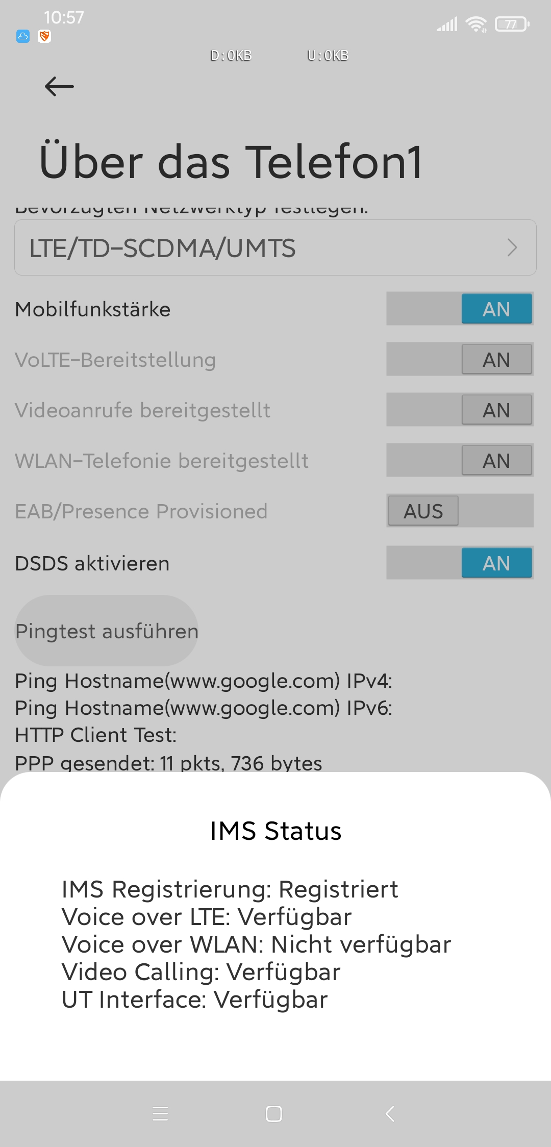

VoWIFI and VoLTE are both enabled through the dialer codes and the options got visible in the SIM settings. Unfortunately VoWIFI is "not available" in IMS Status. A reboot or waiting doesn't change anything. Interestingly after returning from flight mode the sliders in #*4636#*#* (VoLTE, video call and WIFI call) are turned off and stay this way until the next reboot.
