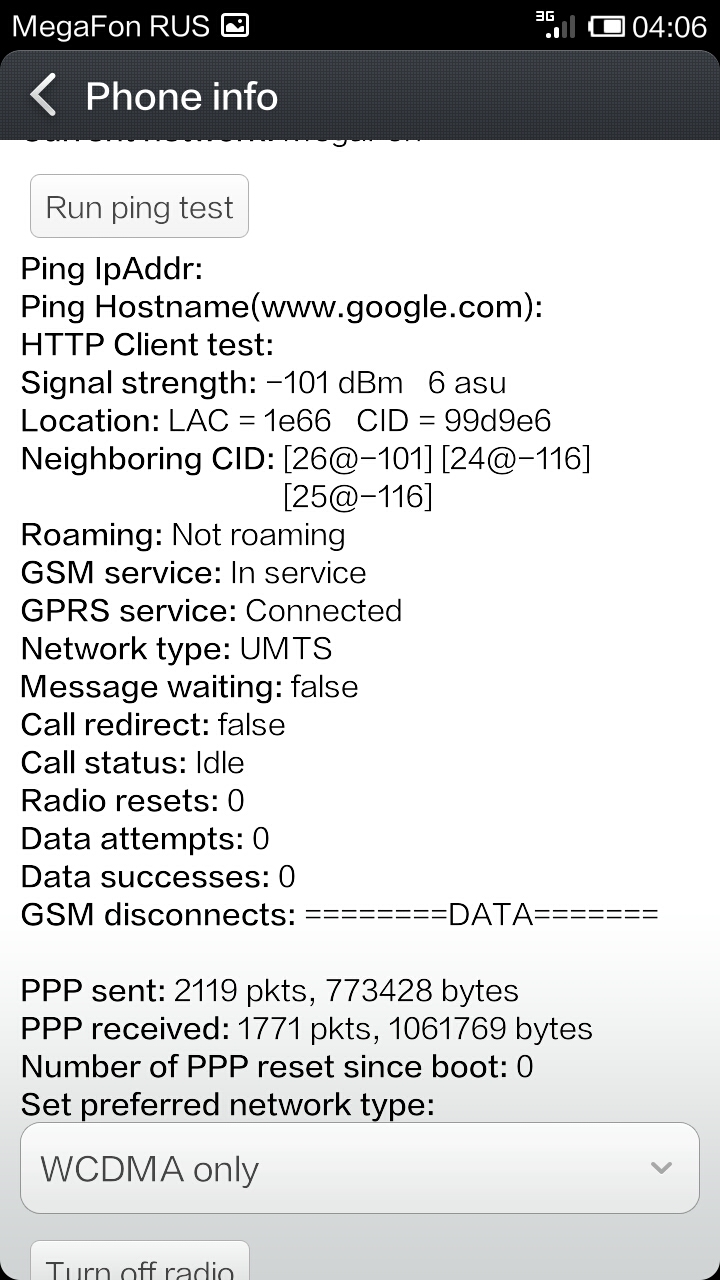

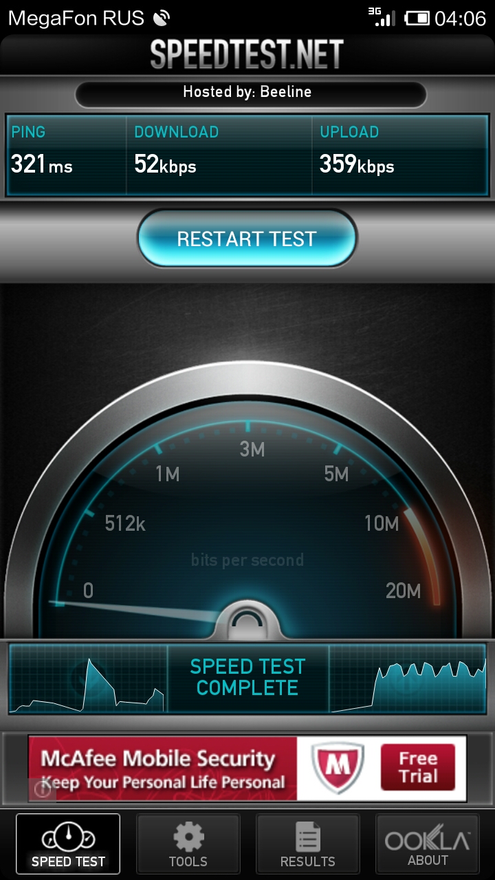

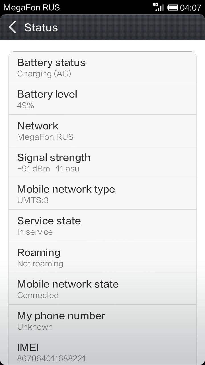

Hello. I got network issue yeasterday just after I replaced my sim card with another one. No H and H+ work, only crapy 3G (UMTS). Nothing helps - wipes, another roms, radio flashing... I begin to think that its a hardware problem, hope its not.How may I fix it? Where can I find help? In russian forums I founded 2 guys with same issues.
Thanks for any help.

I have the same problem after update to V5 3.3.1!
UMTS: 3 - and does not want to be connected to HSPA +
I do not know what to do!

Have you opened *#*#4636#*#* menu and choose LTE mode before that? Or just after flashing 3.3.1?

Just found out that switching to performance mode (instead to normal) activated the h+ again!
