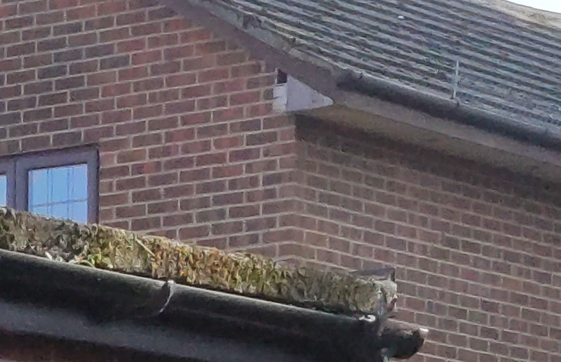

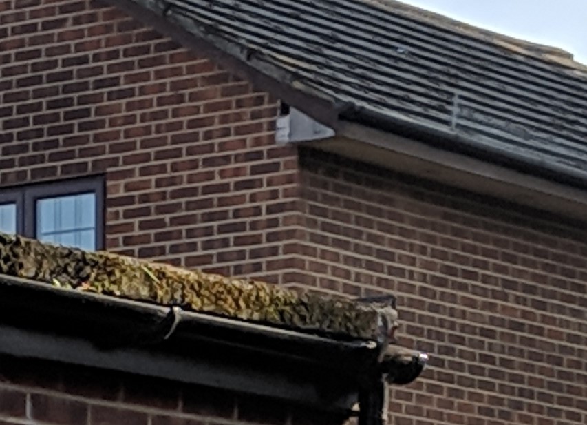

OK so try again. The original pictures are here:
*no-support-for-this-app-on-this-forum* 12MP
Stock Cam 48MP
The 12MP image was upscaled to 48MP (8000x6000) and both were cropped. The results were below:
The above image is the stock 48MP cropped image
The above is the 12MP upscaled image.
My point is that they are hardly different so it looks like the 48MP image is an upscaled 12MP image, not native 48MP from the sensor.

I downloaded both and opened them in the Simple Gallery app.
The 48Mpx photo can be expanded significantly more, and I find the details somewhat clearer, most easliy noticeable in the text on the fire extinguisher.
So there does actually seem to be a difference.
Hi did you upscale the 12MP image to 48MP (200%)?
Cheers
Steve
?? How do you "upscale" it?
All I did was look at the pictures in the Gallery app, and expanded them as much as possible to look at details.
Sorry I didn't explain it properly. In order to compare two images at different resolutions, you load the smaller one into a paint program and change the resolution to the larger image. I did this in paint.net and chose Image/Resize and chose 200% so the 12MP image is now 48MP.
Then you crop the same section out of both images and compare them.
I just tried this with the fire extinguisher and I think you're right. The 48MP one does have more detail than the 12MP one, suggesting the 48MP image is not just an upscaled 12MP one.

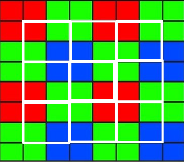

Well I may have answered my own question. I think you can get 12MP pixel binned as described above and, depending on which pixels you group together, you can get proper 48MP output. If you look at the following image:
If you slip one row and column of pixels, you can make a group of 4 pixels in the format RGGB, or traditional Bayer. Each white square above has R, G, G and B.
So it seems you can group like pixels together for 12MP low light shots and group unlike pixels together to get 48MP native.
No idea if I'm right or not :)
