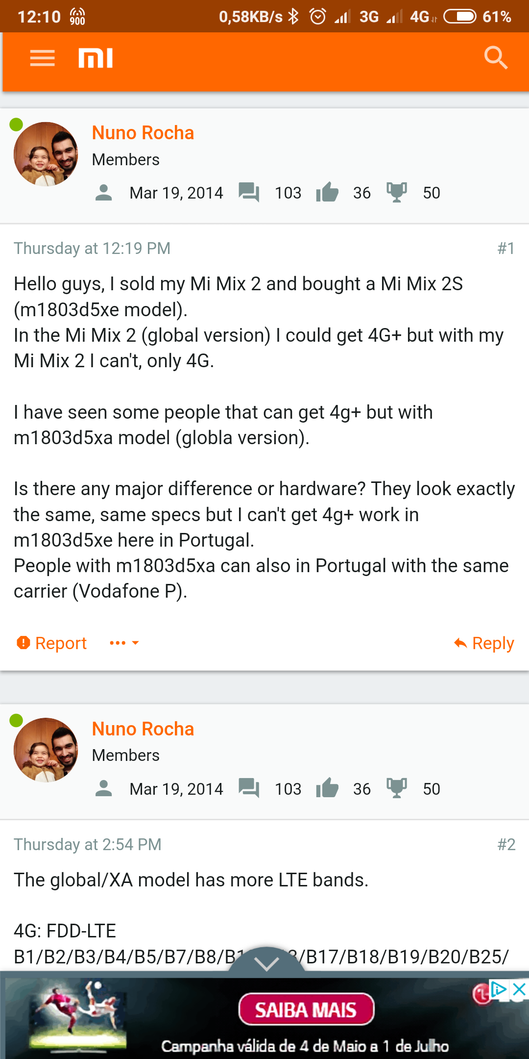

Hello guys, I sold my Mi Mix 2 and bought a Mi Mix 2S (m1803d5xe model).
In the Mi Mix 2 (global version) I could get 4G+ but with my Mi Mix 2 I can't, only 4G.
I have seen some people that can get 4g+ but with m1803d5xa model (globla version).
Is there any major difference or hardware? They look exactly the same, same specs but I can't get 4g+ work in m1803d5xe here in Portugal.
People with m1803d5xa can also in Portugal with the same carrier (Vodafone P).

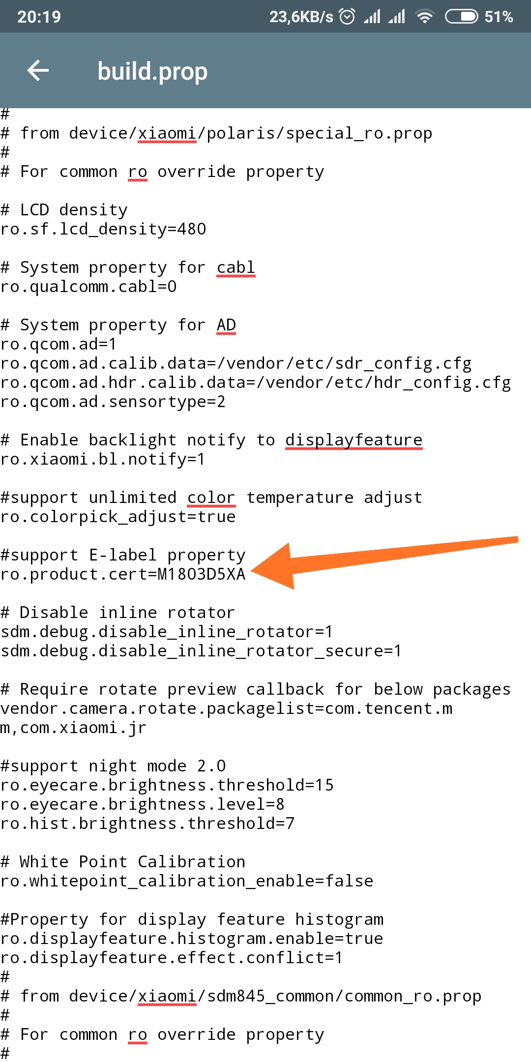

I managed to edit build.prop file and change my device from XE model to XA. Now I only need to know what to edit to put 4g+ working like it does in the XA model.
CEM someone with a XA model and with root share the build.prop file?
My device now says it's a XA model
How did you do this ?
Changing the build.prop from XE to XA won't get us better signal strength unfortunately.
After flashing a new Rom, it will go back to normal :/

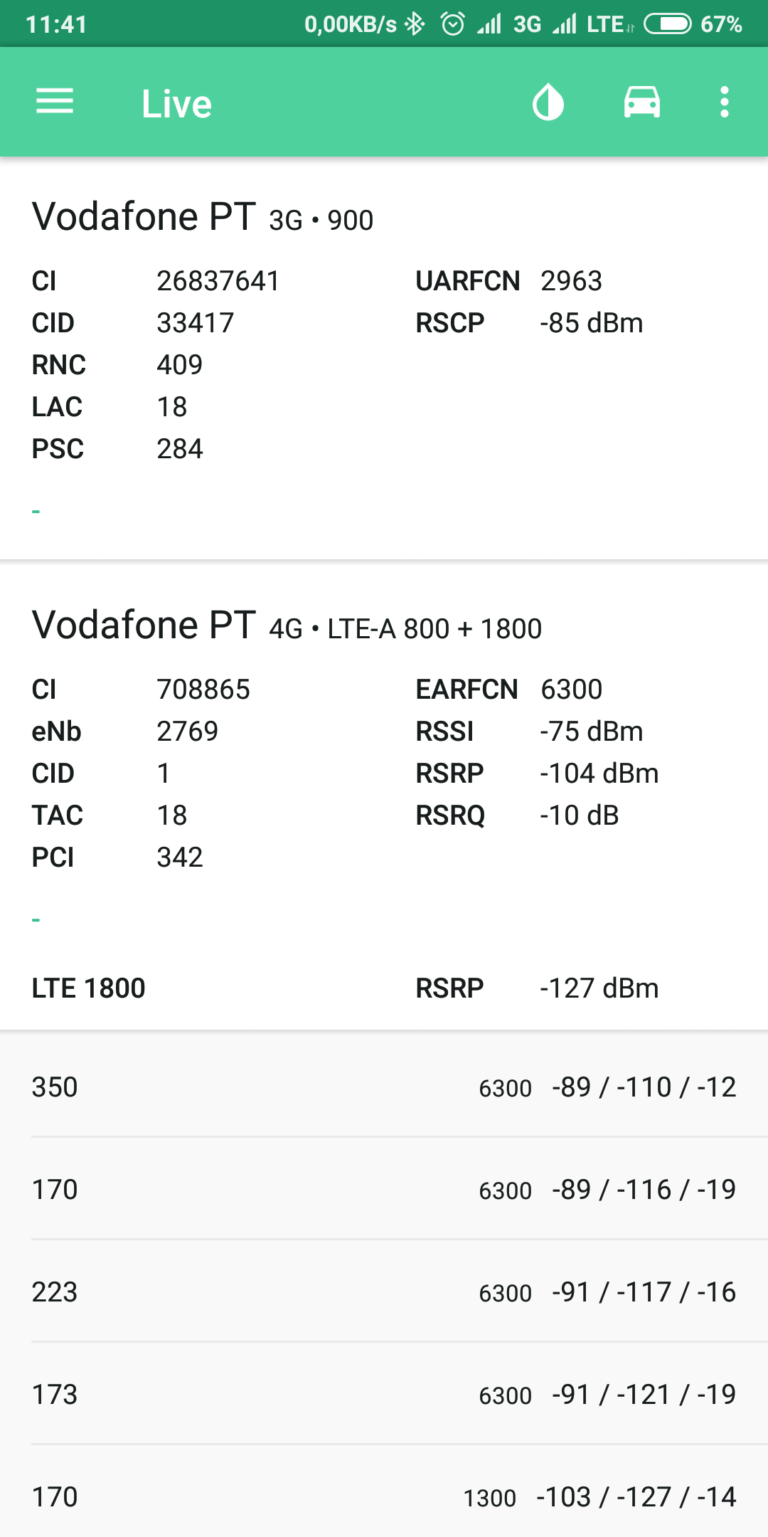

Using netmonster app I noticed XE model can aggregate carrier network so it's capable of 4g+.
Since xiaomi.eu Rom shows LTE instead 4G, maybe it doesn't shows when we are on LTE-A. I have changed the region in the build.prop now I can see 4G instead of LTE in the signal bars. Will see if it shows 4G+ when it gets LTE-A with 2 bands.
Since xiaomi.eu Rom shows LTE instead 4G, maybe it doesn't shows when we are on LTE-A. I have changed the region in the build.prop now I can see 4G instead of LTE in the signal bars. Will see if it shows 4G+ when it gets LTE-A with 2 bands.View attachment 18956View attachment 18957
