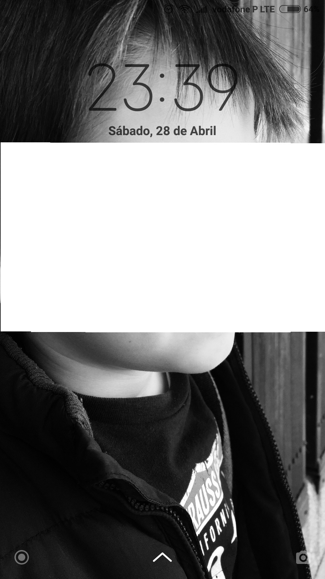

One think I notice was on the default theme, on lockscreen, with some pictures ( some darker ones), the time and date info appears black instead white?! I almost can't see this info with screen locked!
This happen only with some wallpapers / pictures (in dark). There's some config that I could change in settings, to have this problem fixed?!
Look the attachment picture, plz.
In previous ROMs I never had this issue, even with this same photo.

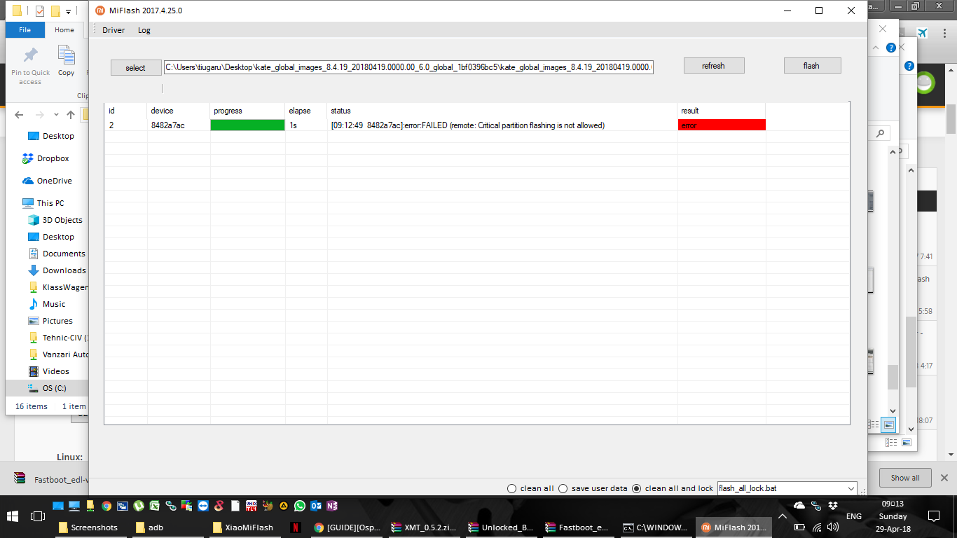

Just flashed the latest firmware on my Kate and got stock...
Unable to enter recovery, only fastboot and can't do nothing from there.
Tried to flash via Miflash, but got this error?
To Mi logo is shown from 1 second and the it shuts down.
Would be great if somebody has any ideas.
Your Bootloader seems to be locked again.
Try to unlock it and you will be able to boot in MIUI.
