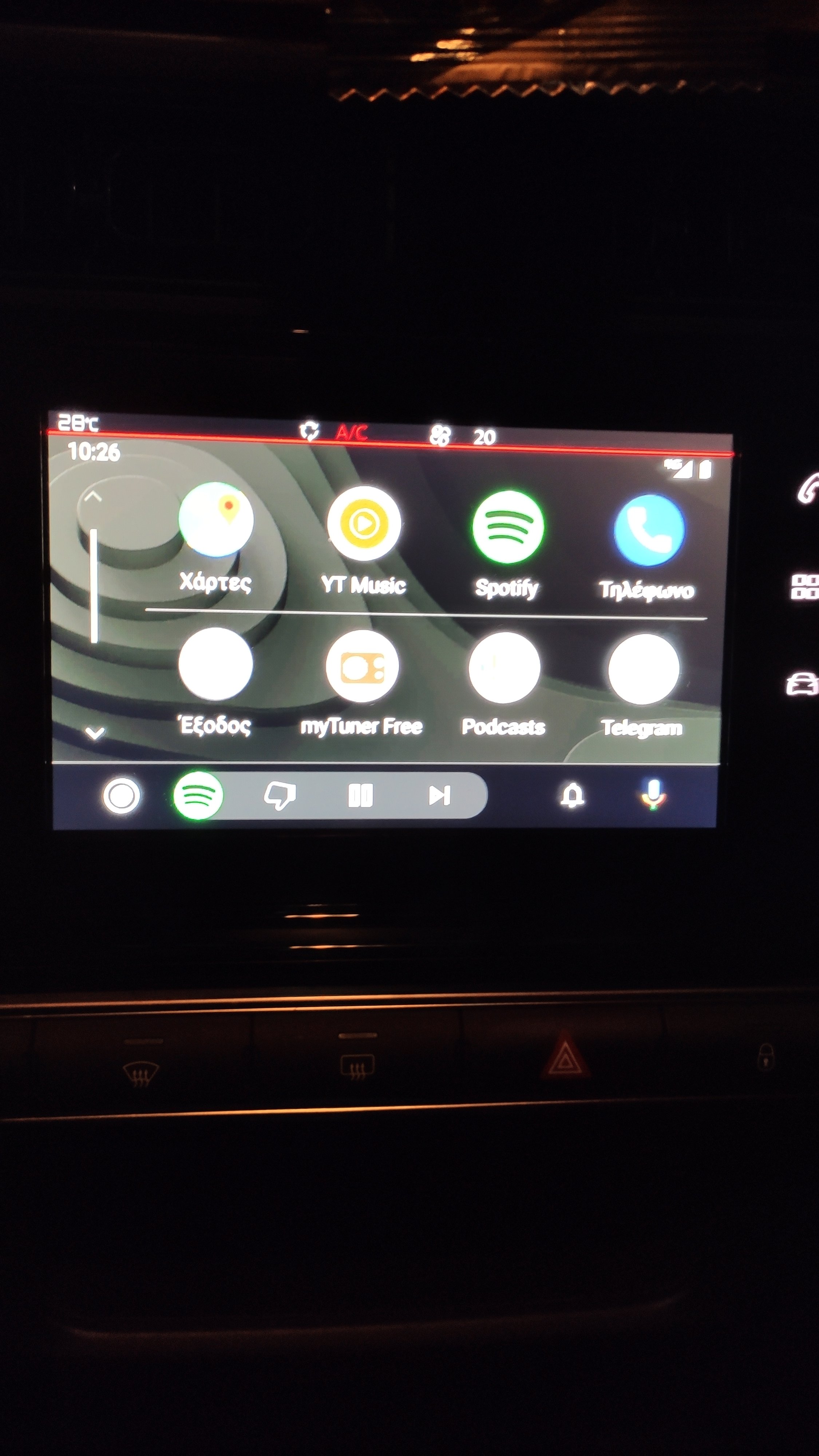

Problem solved before 3 hours by new 10.3.12 update of Xiaomi .AA new improved version works perfectly with my 9t on my citroen c3.
Very happy taking the right decision waiting fot update and keeping this perfect phone .

Having installing the latest version of AA , i just pluged the phone on usb port of my car.
Must give all permissions to AA , not having dual apps enabled on xiaomi and must enable usb debugging on developer options.
Android Auto will only work if you dont have dual apps activated, even if you have no apps running, if say you did use it once then deleted the dual app its still activated, go into disable and the system will say it needs to reboot to deactivate, do this and no more error 16 code, reinstall Android Auto and works flawlessly on all roms, offical global, eu and EEA roms.
