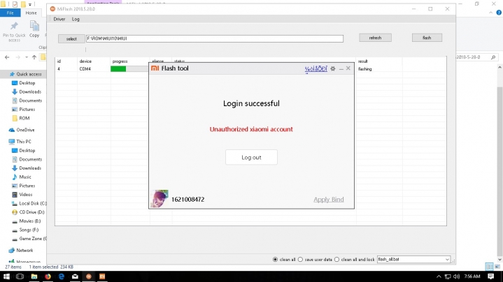

My Redmi Note 5 PRO was Bricked because of Anti Rollback Mechanism
There is no MI Service Centre in my area ,please help me
Please give me authorisation to my account to flash rom and revive my device
MY MI ID IS 1621008472
HELP

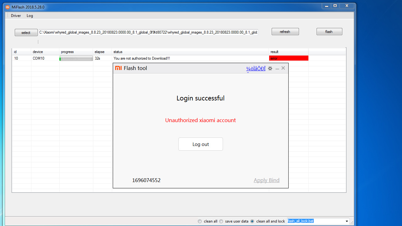

Not really If you can't get to recovery and reflash China version with PC suite 3 China version. Mi flash pro can do the same.

I don't really know what is going on, looks like Xiaomi makes it very hard now. If I where you I would try Mi flash tool but portable one. As far as I understand there are two kinds of problems. Soft brick due to ABR/ or hard brick due to relocked bootloader.

If you can boot to recovery than you can resolve your problem by flashing latest Chinese recovery rom. It has to be newer than that currently installed. Use mi flash pro tool or PC suit 3 Chinese version.
If you can put the phone in fastboot mode try unlock bootloader by using mi unlock tool.
Some people reported they got authorization after few days even though they were not informed about that.

Why do you need authorization account if your phone can't boot at all. You have to explain exactly what the problem is.
You can open the phone and trigger test points to get into EDL mode. Eventually you can buy special USB EDL cable.
