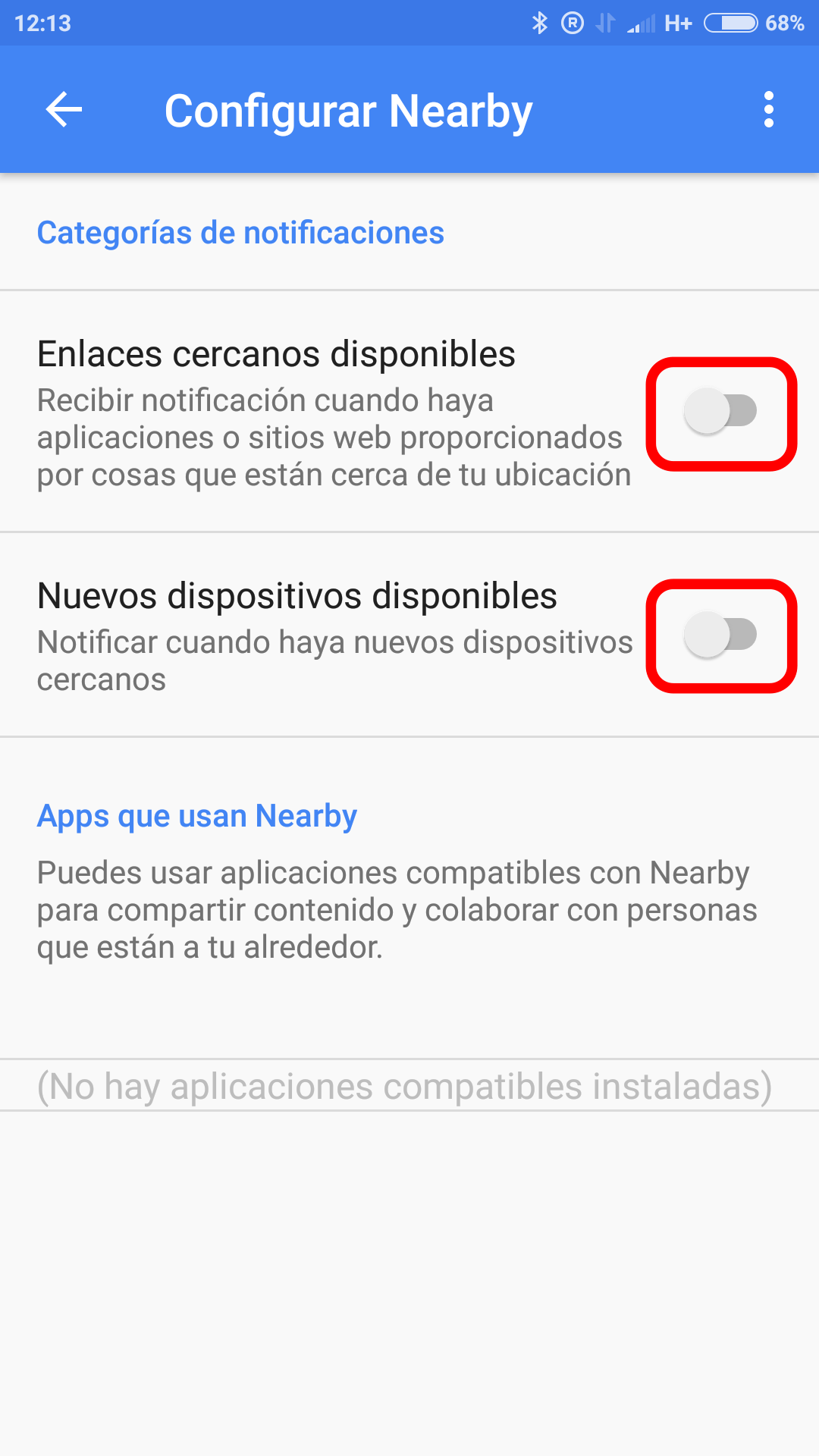

In case it works for you, within the Google settings I have disabled Nearby and stopped draining my battery.
