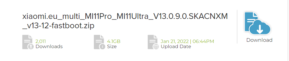

Our Xiaomi.eu ROM.. Look around a little..wich rom ?
HiInstall our ROM..

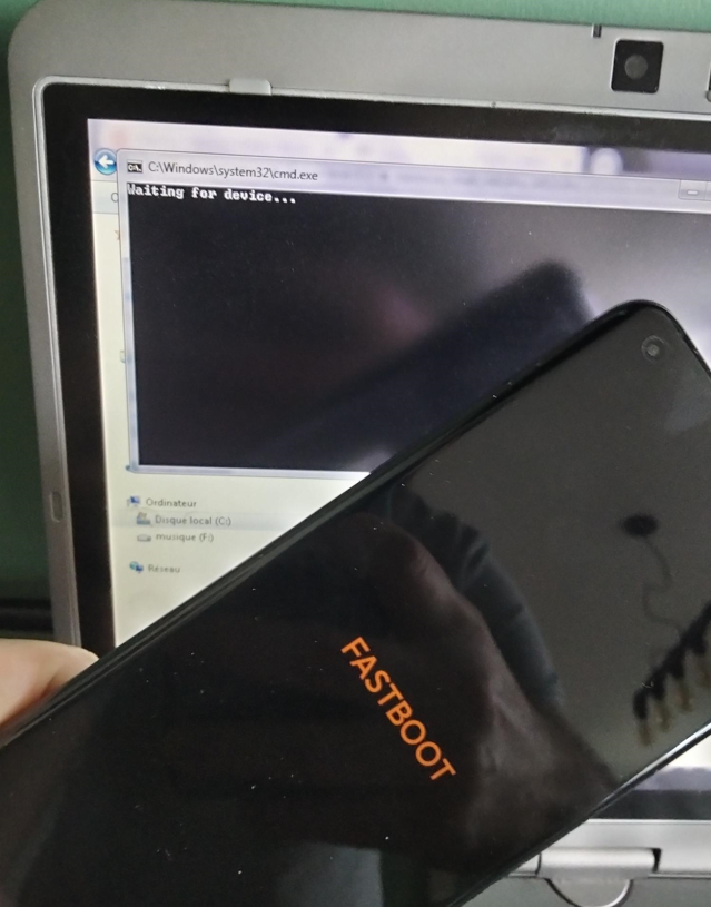

? Can you explain. ? I have instal adb driver. After no workingYes OK

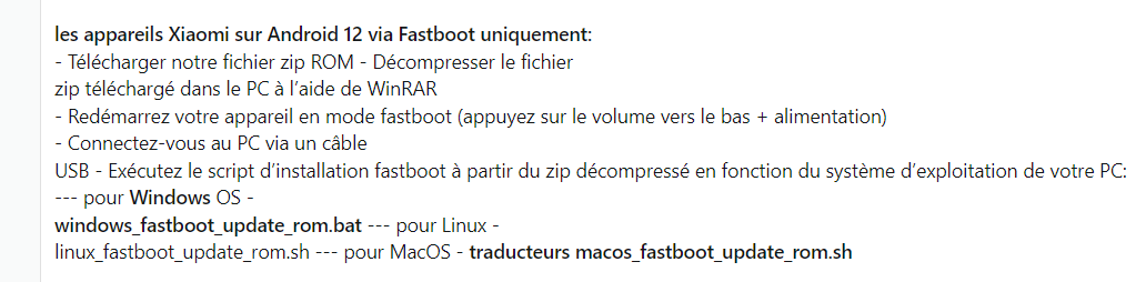

I finally managed to install the rom. works great thanks again for your help. I nevertheless encounter a problem with the installation of WhatsApp and the recovery of the archive on Google Drive it manages to import my messages but not the multimediaTry to install the drivers again. Be sure to restart your PC afterwards.
Install drivers, ADB and fastboot
install Xiaomi drivers
How to fix Fastboot Driver issue for Xiaomi Mi 11 Ultra
