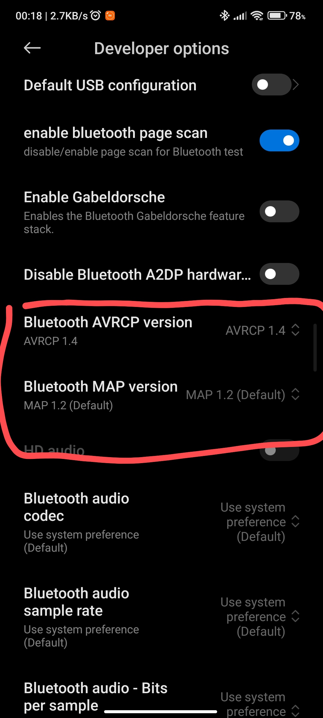

Please try changing these options in Developer options

I used to have connection issue with Huawei Freebud 4i until i found out that AVRCP was set to 1.5 by default on A12. I changed to 1.4 which was on A11 and i fixed my problem.

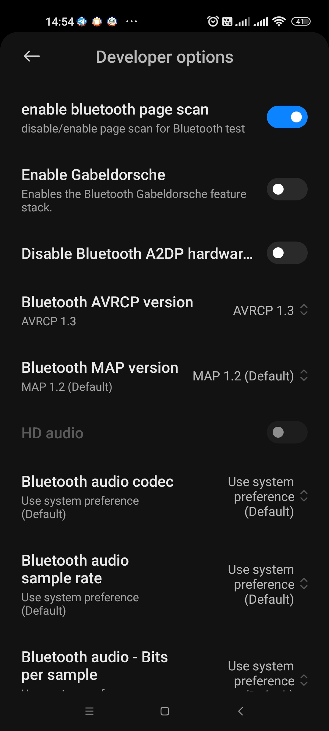

I have Xiaomi 11 lite, MIUI 13, Android 12. In Developer options I set Bluetooth to the earliest possible 1.3 and 1.2 respectively. See attached screenshot. My Bluetooth issue got resolved this way. I have 2 Bluetooth headsets. Both connect ok. One is Philips, the other is JVC
