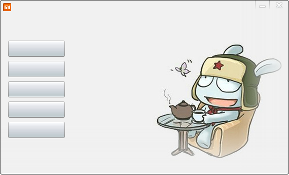

find and install miTool it has all drivers, then try plug the phone to PC again. If it's not working try other USB port.
