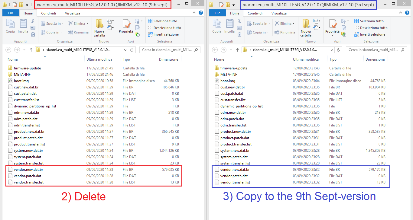

  2. Delete all three vendor files from the folder of the 9th Sept-version. (Image: 2-3.png)View attachment 31919
  3. Copy the three vendor files from the folder of the 3rd Sept-version and past them in the folder of the 9th Sept-version. (Image: 2-3.png)View attachment 31919

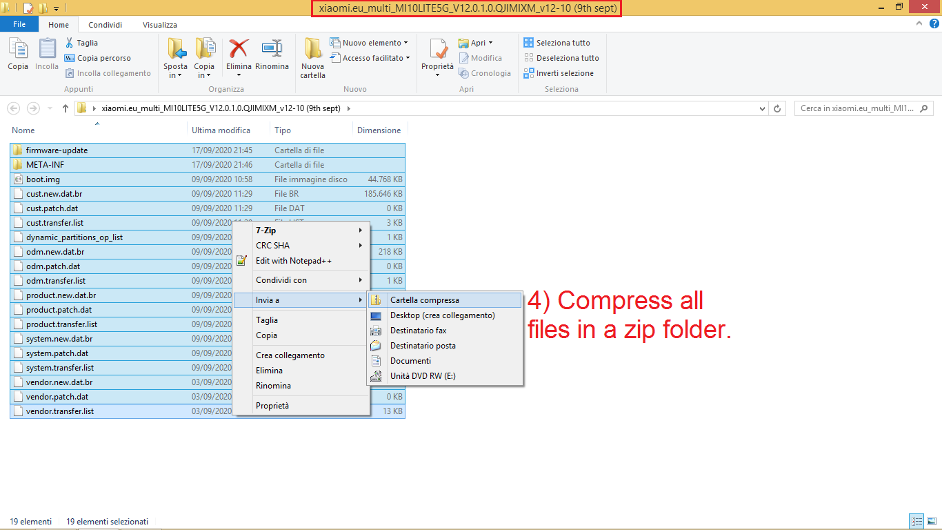

  4. In the 9th Sept-version folder select all the files then right-click and select “send to” -> Compressed (zipped) folder. (Image: 4.png)View attachment 31920

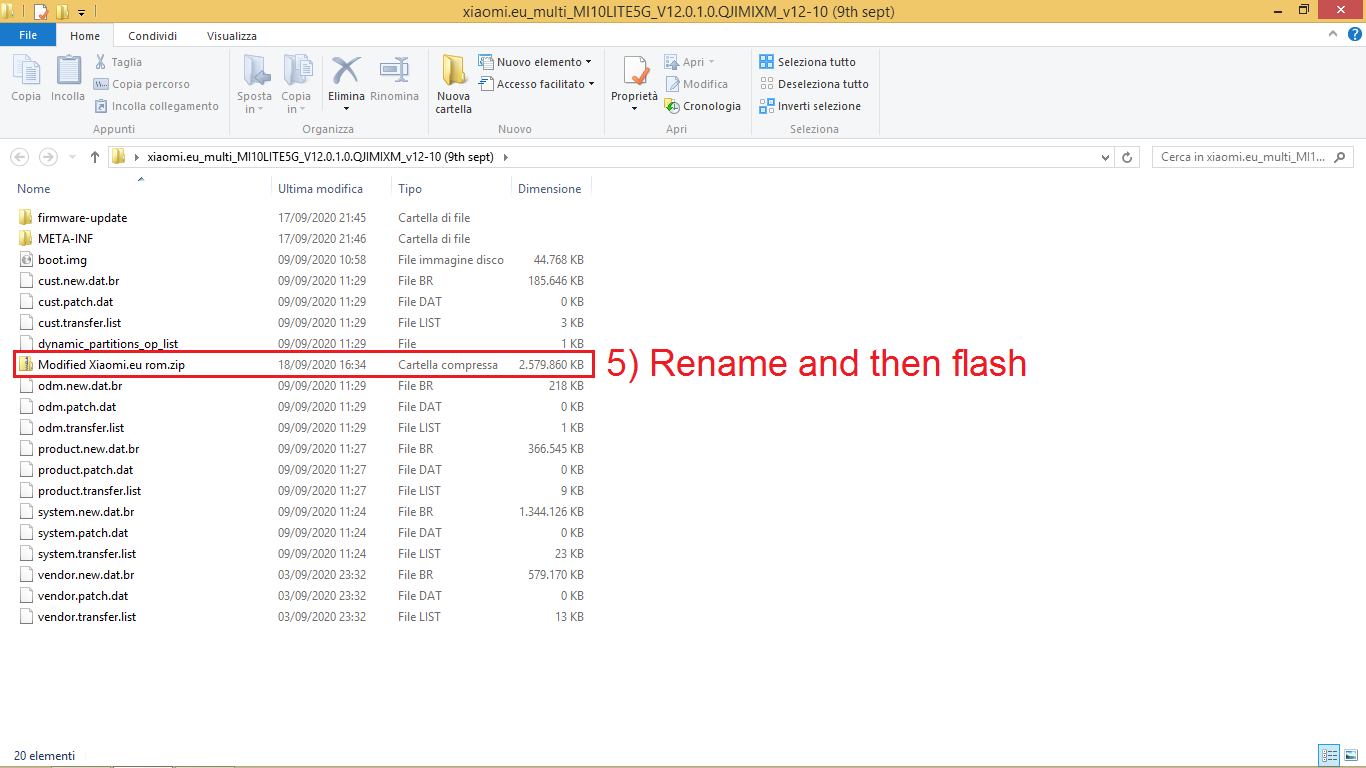

  5. Rename the newly created zip folder to whatever you like and your rom is ready to be flashed. (Image: 5.png)View attachment 31921
