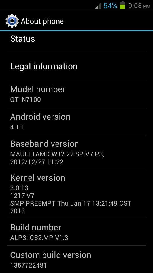

build number ALPS.ICS2.MP.V1.3
freshnote2
Feb 17, 2013
8
11
I Bought a international note 2 unlocked from someone on the streets and when i get home i see that it doesnt have "s note"nor most of the apps that ive seen other note 2's have .the model number is GT-N7100.so is this build number a part of a custom rom or might this phone be a counterfet?and are there ways that i can get the stock rom ?some one please help..btw when it starts up it just comes up saying "android" and not samsung.

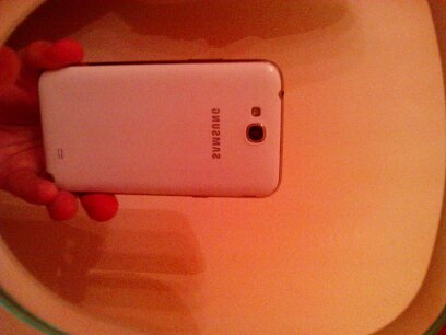

i wasnt sure what type of pics are needed but here are a few.

from your screens phone model is correct, but FW version and baseband is strange... it should be in format like N7100XXDLL7...

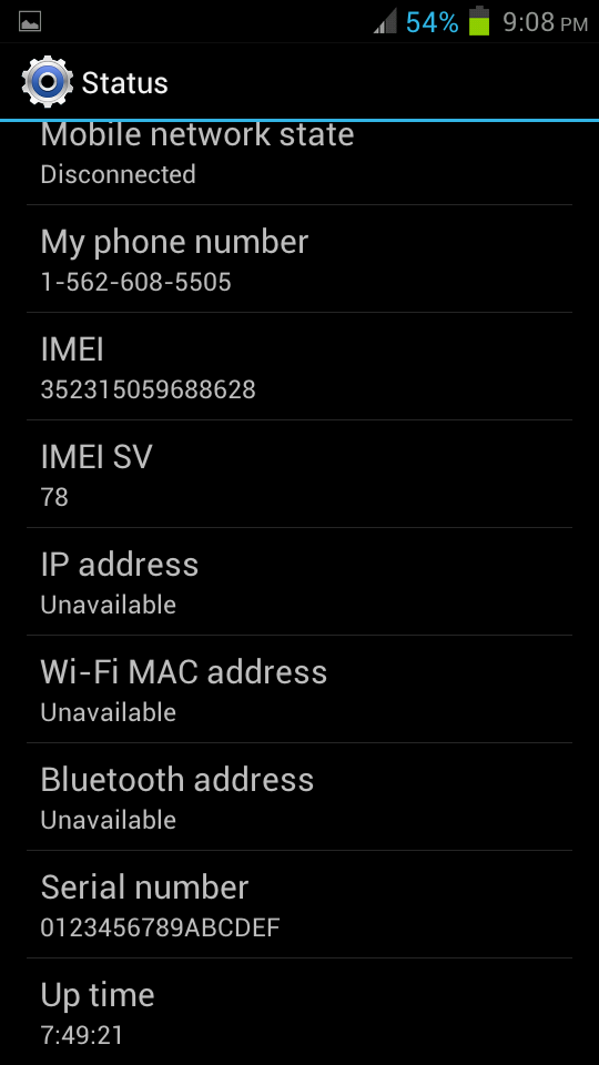

can you upload your backup firmware using mtkdroidtools>?? your phone not a real note2

something told me to take out the batt and look on the phone and it says
model:GT-N7100
SSN:GT-N7100GSMH
FCC ID:A3LN7100
IMEI:354666056770761
S/N:RF1C1266B1N

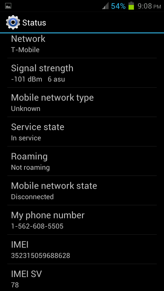

so im not sure which are the rite info because when i go to settings-about phone-status and the IMEI numbers are different and so is the serial number so im not which one is rite..the serial number in the settings part is 0123456789ABCDEF..
