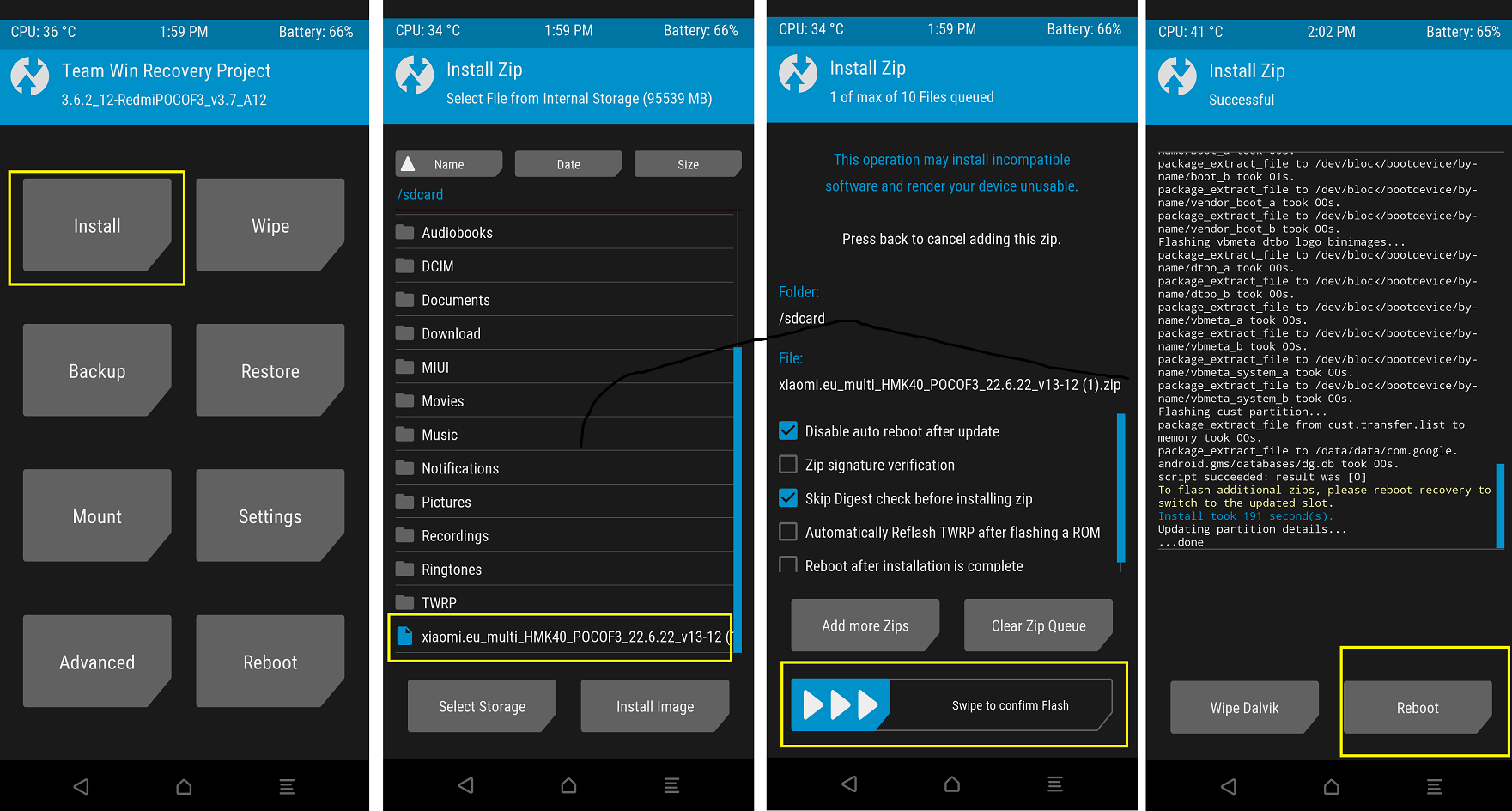

If you have an unlocked botloader and installed TWRP, you can try this procedure:
- download xiaomi.eu ROM to your phone
- reboot into TWRP
- Install the ROM
- do "Format Data" wipe > format data > yes
(your data will be deleted)
- reboot system

If it shows you these errors after installing the ROM, it's fine and continue according to the instructions.
