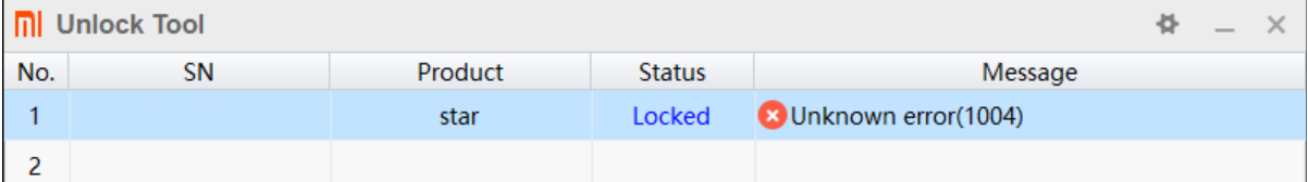

I got this error message all the time: unknown error 1004

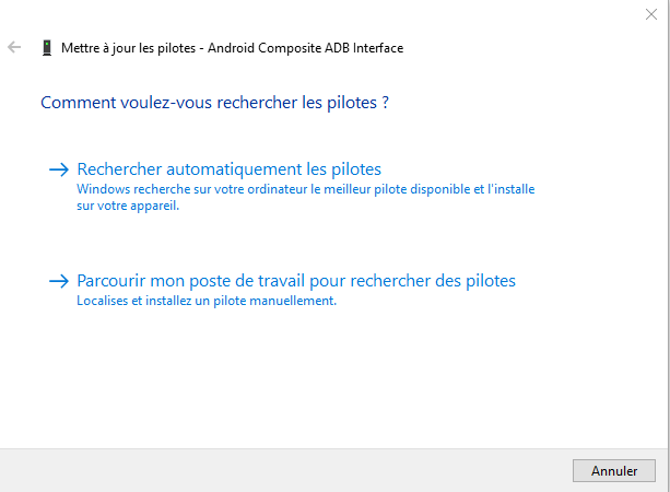

You should have this page : (in your language, and also i'm using a random peripheral for the exemple).
Just click the second option.

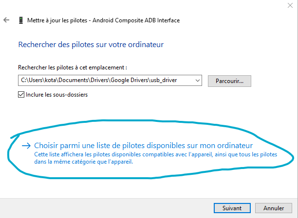

You should be at this page :
Just click the "Choose a driver" Option.
Then you should be there :

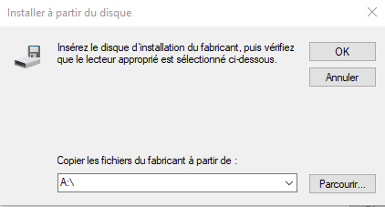

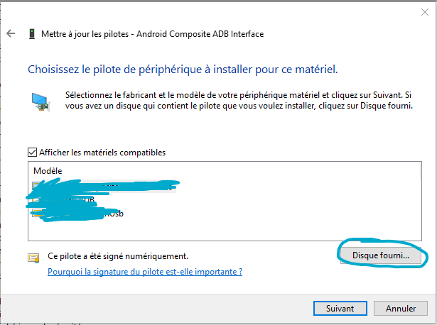

Just click the Bottom Right button.
Once again, Click the Bottom Right Button.

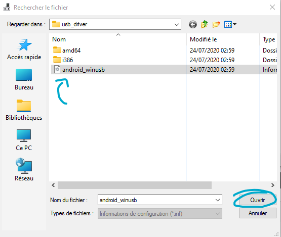

Then just go where you put the drivers.
Then you should have this
Click on the android_winusb file and then click the Open Button.
If there is a disclaimer, just press Ok.
