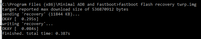

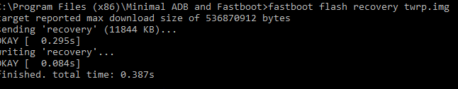

Went through so many guides online on how to install TWRP but somthing`s missing...
installed "Minimal ADB and Fastboot" and the other tools, downloaded TWRP img for Xiaomi,
adb reboot bootloader
fastboot reboot
28804
but after I enter recovery mode... I get the old chinese menu...
tried this like 10 times already.
please help.

You should end it with
Code:
fastboot reboot recovery
Sent from my Redmi Note 8 using Tapatalk
Yes twrp is in Chinese first,you have to switch it to English yourself,look at a YouTube vid on how to do it,the buttons are usually in the same place in all of the, first twrp run is always in Chinese
Only for LR.Team/wzsx150 TWRP version. Best chinese TWRP dev team/user. :)
