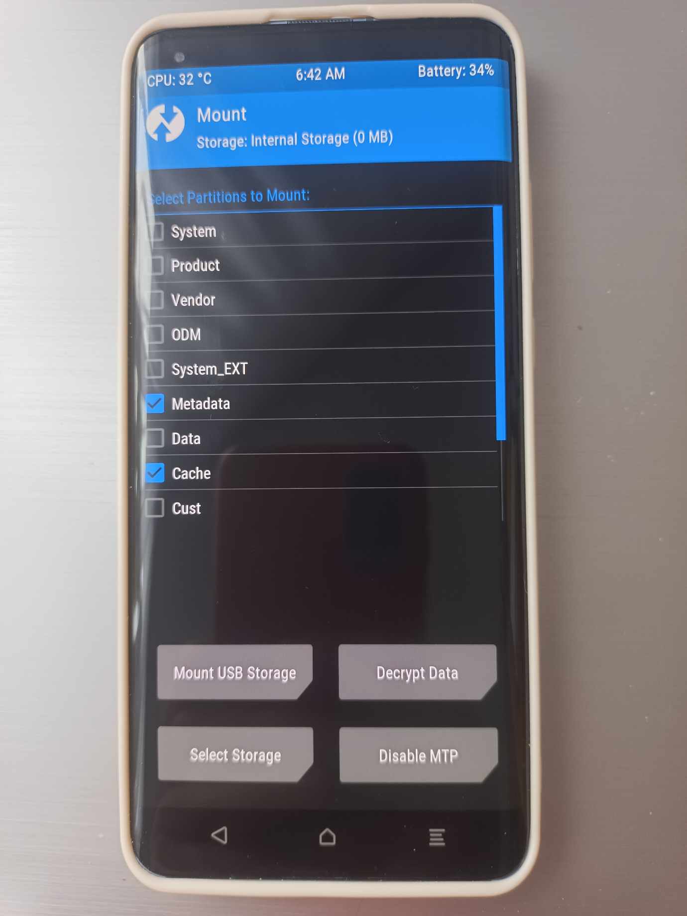

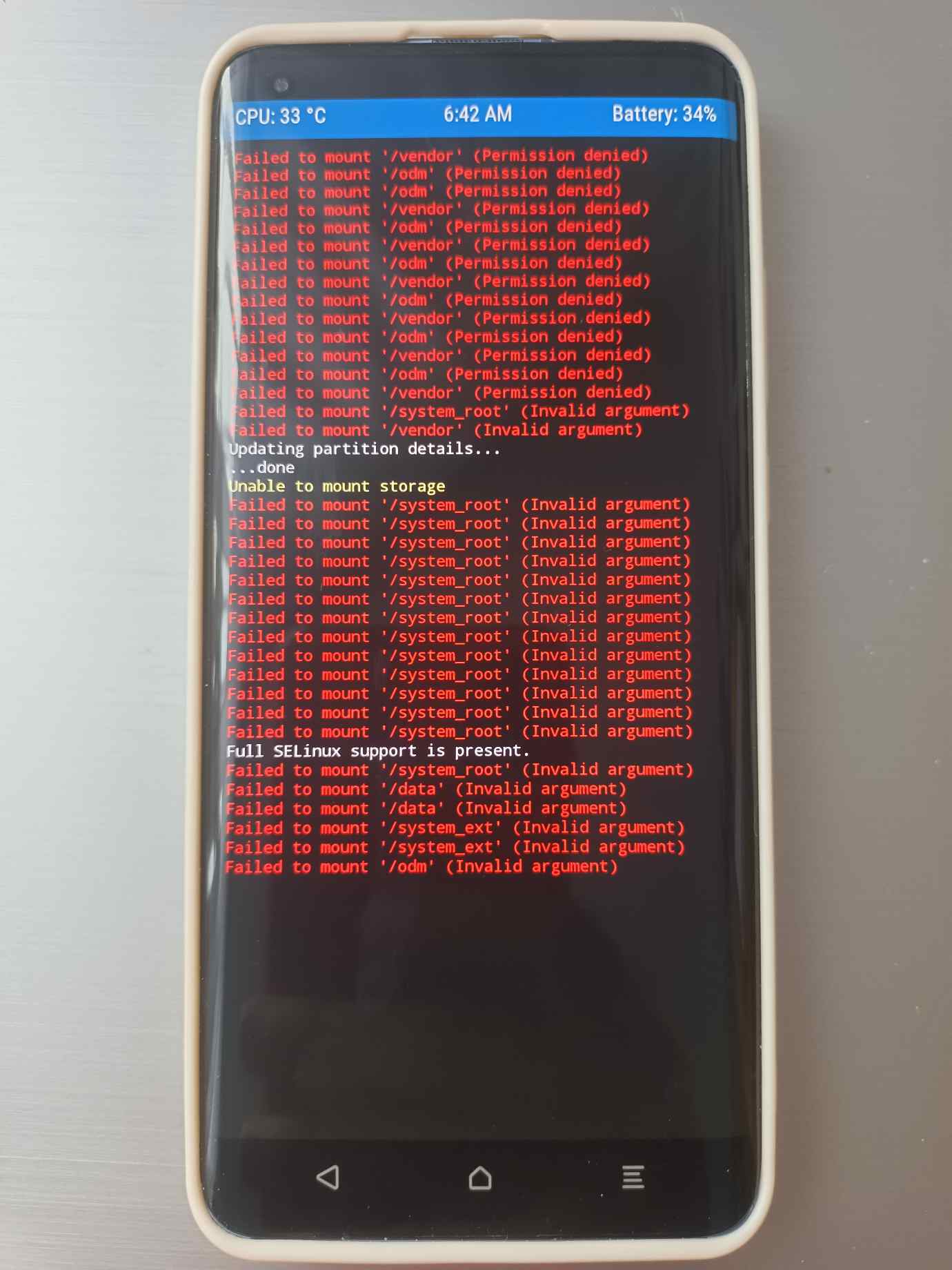

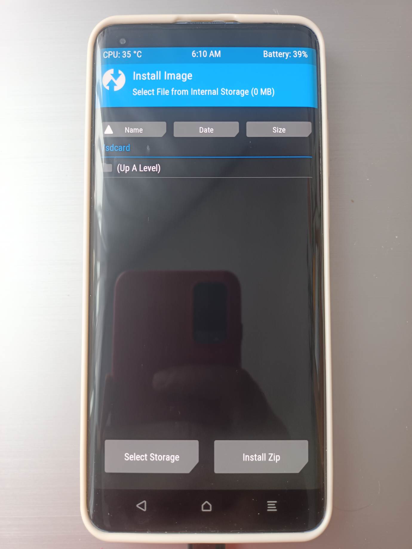

Noogman
I purchased used Mi 10. Decided to flash Xiaomi eu. Downloaded eu rom and twrp. As only I go to twrp many partitions is inaccessible. I see system, product, vendor, odm and others but only Metadata and cache are checkable. Problem is system, product, vendor andba few others aren't mounted. Anyone knows the problem?
