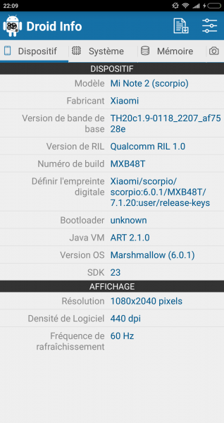

I received 2 xiaomi Mi Mix with Note 2 firmware inside.
One was come with 8.0.15.0 rom inside and i had put this one in EDL mode and i insert Mi Mix rom without probleme and all is ok.
The second was come with 7.1.20 developer rom and i can't find solution for put him in EDL mode (I tryed all, Fastboot Edl, Deep Flash Cable...)

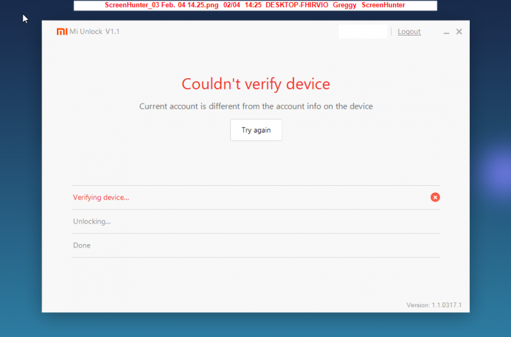

I tried too unlock the bootloader but impossible because i think Mi Unlock see is a Mi Mix with Bad firmware and all time 50% ... Couldn't verify device...

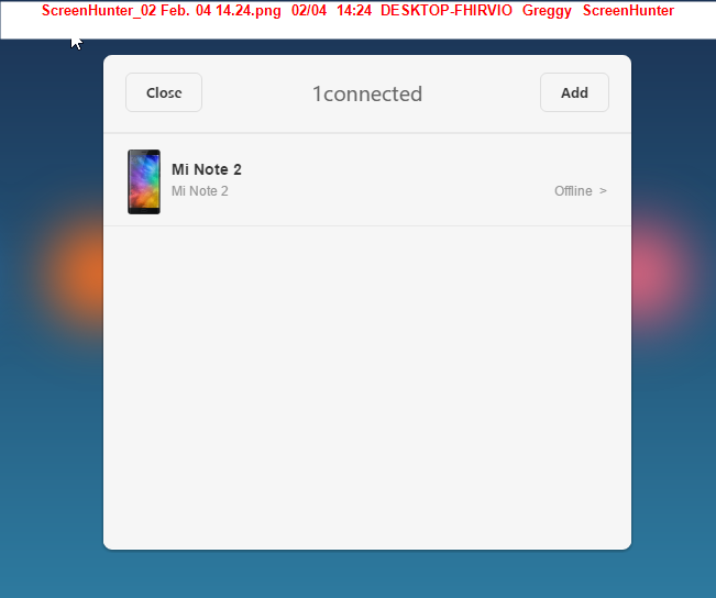

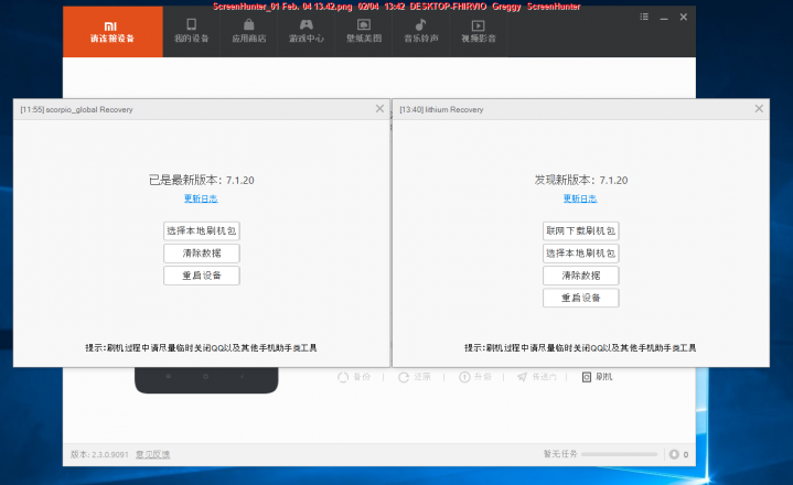

I tried too to flash with Mi Pc Suite China version but in dowload mode i have acces on this mix only at Scorpio Recovry and i can't insert Lithium recovry.
I tried too with Mi Updater App in the phone directly but application said can't verify update or can not flash with old rom....
It's for that why i look a solution for change MID because if i do that, after i can put My Mi Mix in recovry mode and insert correct rom with Mi Pc Suite china version. Mi Pc Suite will see him at a Mi Mix and note Mi Note 2.
