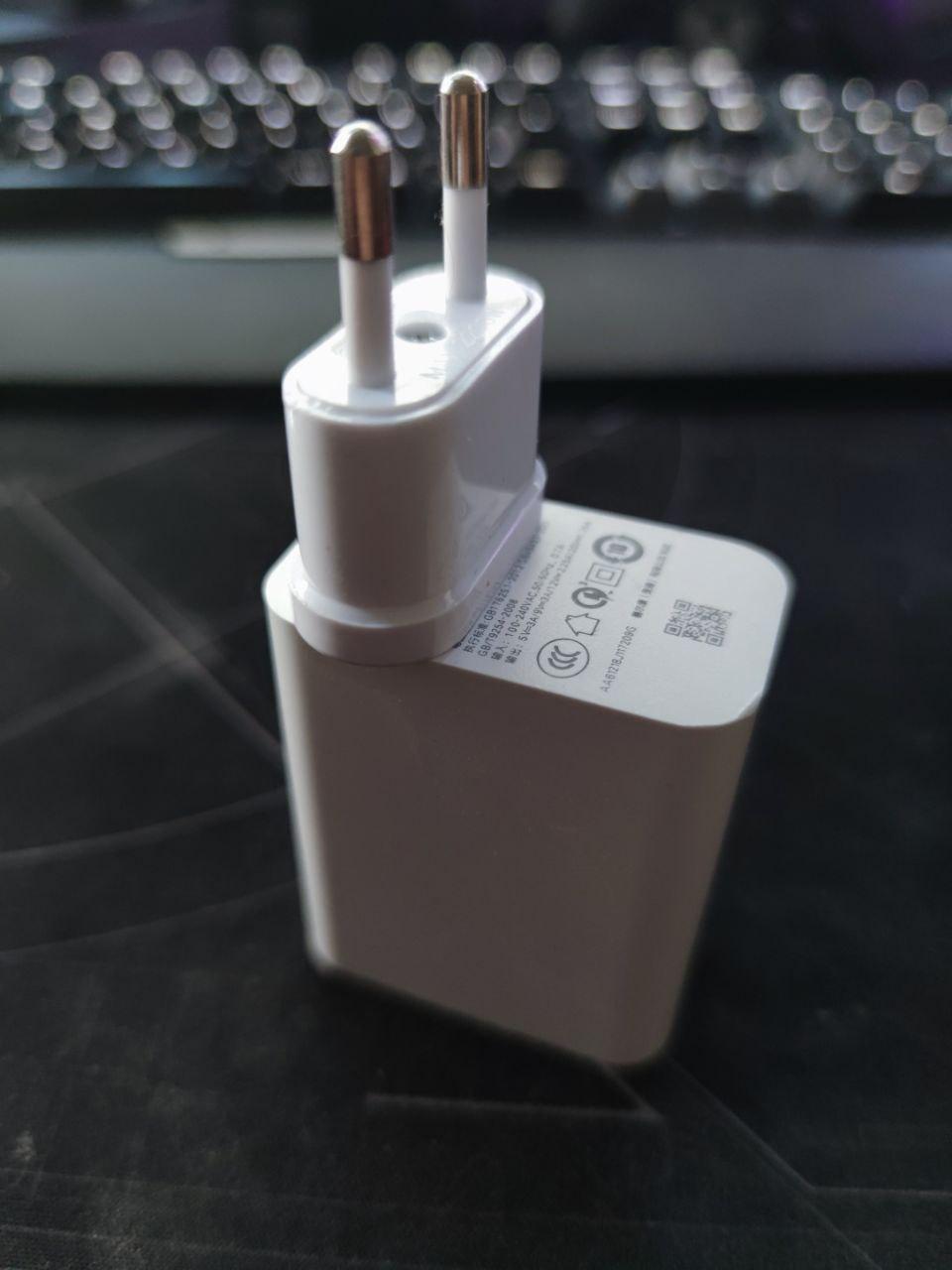

To be honest I would probably buy the Xiaomi 65w GaN charger, the small one with USB C. It only comes with us plug so for me it means super gluing an adapter to it :D
Keep in mind these chargers are also getting recalled for "security reasons" apparently they can be hacked.
Here is a picture of my "plug super glue" skills lol. it's about 4mm taller than the original EU plug so I'm happy with it.
The funny thing is the original mi 10 pro charger has "9v 3A 27w max" written on it but it charges my phone with 9v 5A! so I basically cannot say anything about which Xiaomi charger would work and which one would not. The only reason I'm somewhat certain the Xiaomi 65w GaN charger would work is that Xiaomi advertised it with mi 10 pro.
Another thing to consider is that the Chinese ones do not have CE logo on them and If you are in EU that could become a problem, specially here in Germany it's random but a pain in the rear end when it happens :D
