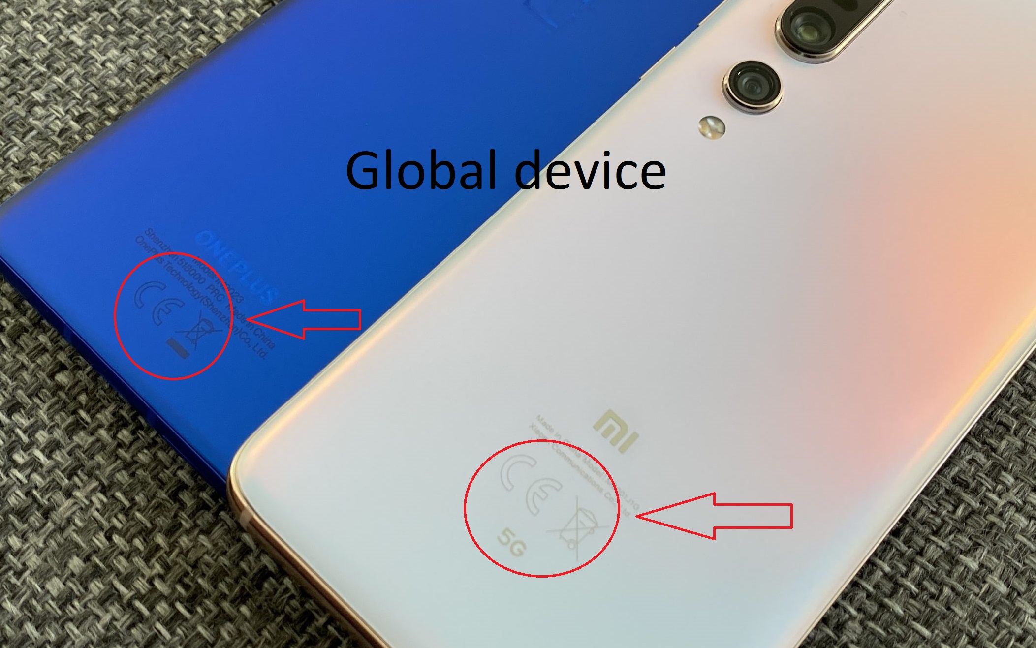

If you have a Global device you can use any Global ROM and lock the bootloader regardless of which market it was intended for. This means EEA , Global, RU, TR, India, etc.
If you have a Chinese device you cannot use Global ROM and lock the bootloader.

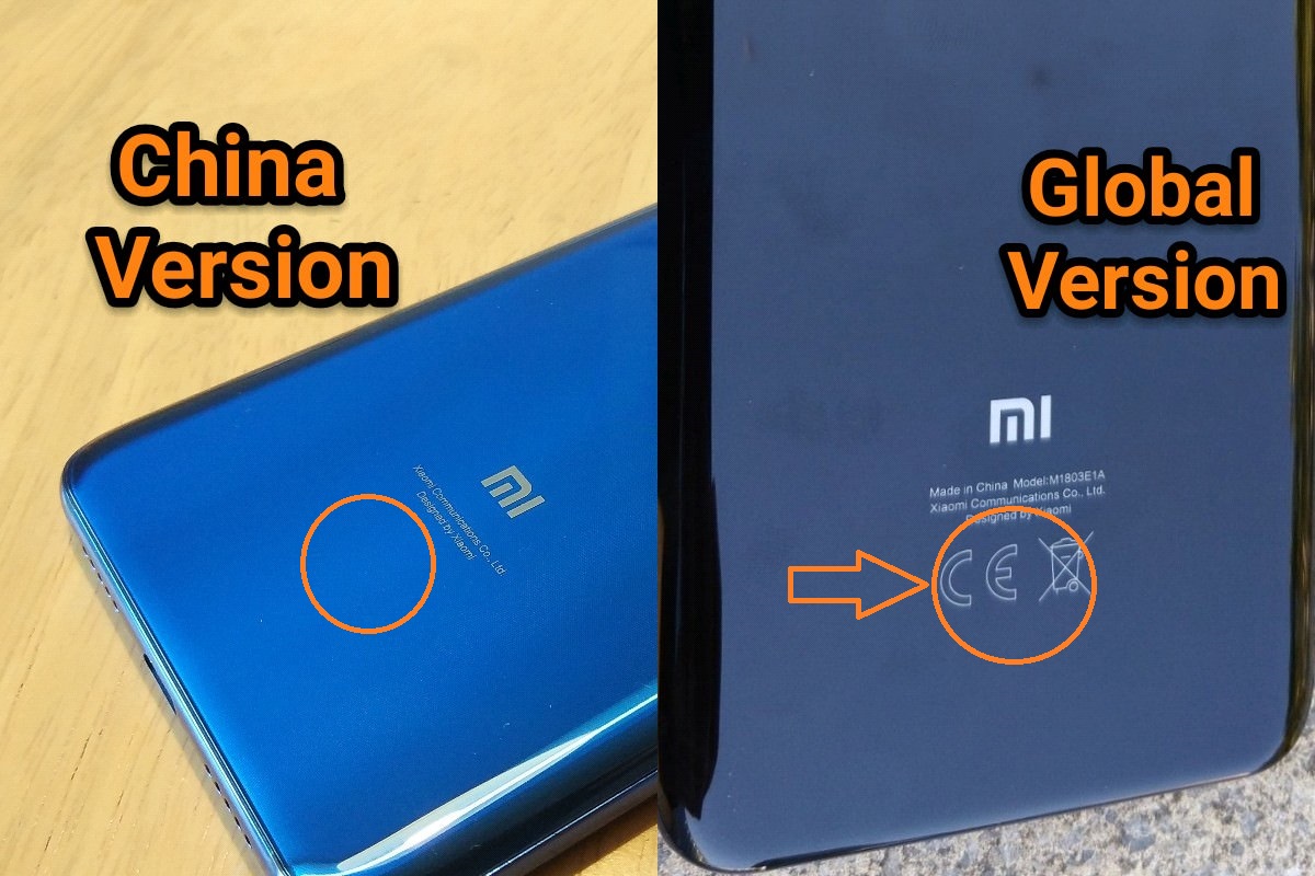

1) I bought the device on Amazon.it and I don't remember if it arrived with a global or EEA or Italian rom installed (if it exists). In any case, if I have understood correctly, I can use global stock rom indifferently (regardless of whether it is the international or European version) as long as the device has not arrived with a Chinese rom installed (and I am 100% sure that it was not Chinese rom pre-installed). Am i right?
Another question: should I use the latest global rom available or should I use the first one? Can you confirm the correctness of the link I indicated to download it?
Yes. You can install any Global ROM regardless of which region it is intended for. But only if your device is Global version.
If you have a Chinese device, you must not lock the bootloader with the Global ROM.
