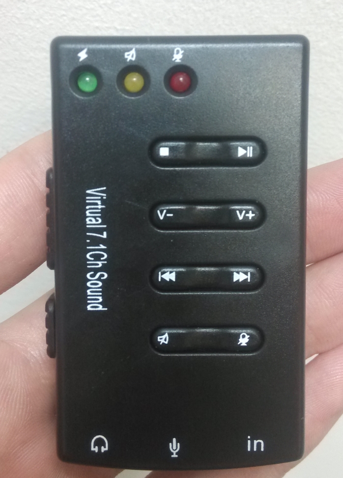

Hi guys.
I got this cheap DAC from DX with controls (image attached), my goal is to make an "One Cable Solution" in my car, so i can connect one usb cable to the phone that will charge it and connect the DAC and the controls.
So here is the interesting part... The control WORKS without any manipulations or special kernels!
Basicly it mean that MIUI already has USB DAC support, the problem is that it doesn't route the audio to the DAC.
We need some help from the very appreciated DEVS here...

Hi guys.
I was wondering to do the same, have you done it? did you use some special 3 ways usb cable or what?
