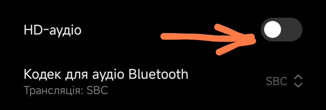

First of all, you have to check if the device you are connecting to supports LDAC. If yes, turn off the "HD-audio" button just above the "Bluetooth audio codec" switcher, and only then you will be able to switch the codec.

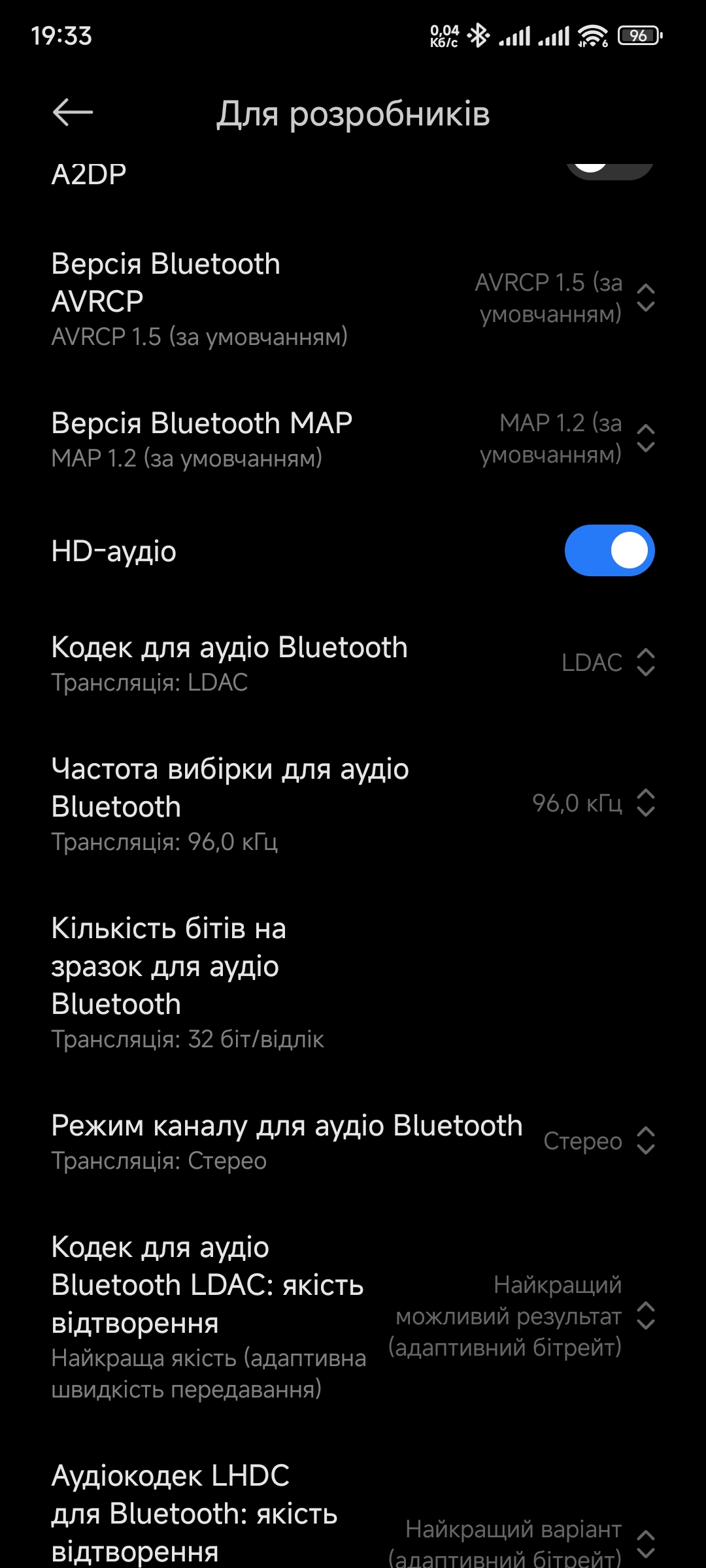

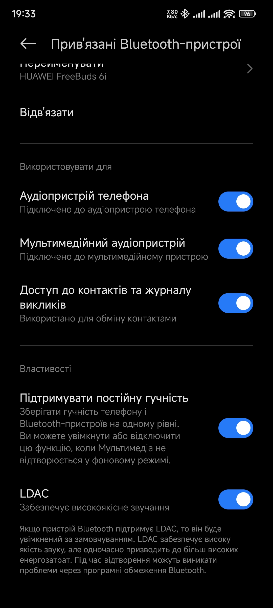

I've just bought 6i too! So here on screenshots how I turned on LDAC. In the developer menu and Bluetooth menu
