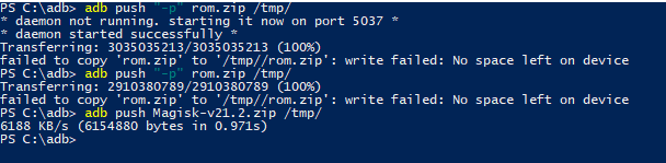

Hello once again I have a problem with no idea to the solution.
I updated to 28_12 rom- no problem
Updated magisk and entered a boot loop
Factory reset phone wiped data/cache/davik and try to install rom
but receive a strange error which I cant seem to get past
I have spend a few hour searching the forum but cant find an answer that works-any ideas
Have also updated adb and TWRP to 3.3.1-35

Hello again! ^^
EDIT: Latest Official TWRP is 3.5.0_9-0 => https://androidfilehost.com/?fid=17248734326145706361
You want to do a clean install? If yes, you should "Format Data" (in TWRP => "Wipe" menu > "Format Data" button). :)
After that, reboot to TWRP (in TWRP => "Reboot" menu => "Recovery") to be able to transfert files between your device and your computer. ;)
Do not forget you must flash Magisk v21.x on Android 11. Latest version is: Magisk-v21.2.zip
Yes looking to do a clean install-
So far
Use wipe menu format data button- then have to type yes
process begins
update partition details
...done
Full SElinux support is present
MTP Enabled
Formatting Data using mke2fs....
done.
You may need to reboot recovery to be able to use data again
Updating partition details.....
...done
Then reboot to recovery-swipe to reboot
Boots into recovery
Try to load 28/12 same error no space left on device
Try to load older rom same error no space left on device
This time however I did have an error appear in windows which said error unabe to mount image
Try to load magisk zip you sent just to ensure I am not going crazy and everything is working and that works correctly zip file appears in tmp
33729
For whatever reason I cannot load any rom

Have also just tried-
Change file system for data - changed to EXT2 and then back to EXT4
Also avdance wipe -wipe Internall storage
All succeeded with no errors- Try to load rom and no success-same error no space left on device
now trying
Success :) copied rom
currently extracting-extract success
rebooted- Took a long time- Now have to reactivate and setup but looking good
Once again I am very thankful for your help and extremly impressed with your knowledge
Thank You
For your information, the "/data" partition should be "F2FS", not "EXT4". :)

Just tried to change file system to F2FS
You can keep "EXT4", that's not an "issue". ^^
But I recommend to use "F2FS" for "/data" and "/cache" partitions. :)
Just tried to change data to f2fs but receive all sorts of errors

Reboot to TWRP?
You can also "Format Data" again too. :)

Just strated again
factory reset
reformat data
now data is OK in F2F
Reboot to TWRP?
No matter what I did having cache in f2fs always came with error unable to mount
So have data now in f2fs and cache nack in ext4 no errors
just reloaded rom
phone has booted now restoring back up but all looking good
Once again thanks for your help- really appreciated
