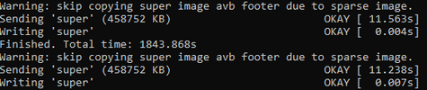

Xiaomi 14 Ultra EEA BL was unlocked.
I tried to flash .eu today but i got stuck at the 5th super for a long time so i decided to Ctrl+C it (1.png)
Then I tried to flash it again and it just reboots into fastboot.

I guess I don't understand you. Do you have the device in fastboot mode? If yes install TWRP.
Ohhh. My fault. You are in the Xiaomi 14 thread! I thought we were talking about the Xiaomi 14 (houji) but you have the Xiaomi 14 Ultra.
In that case, what I wrote does not apply to you.
Xiaomi 14 Ultra:
You can install stock ROM via Miflash (don't lock bootloader) and then re-install xiaomi.eu ROM
Ohhh. My fault. You are in the Xiaomi 14 thread! I thought we were talking about the Xiaomi 14 (hooji) but you have the Xiaomi 14 Ultra.
Xiaomi 14 Ultra:

I just installed EEA again without locking BL and ig ill give it another shot

But now everything works.
I also found out that i cant boot into that TWRP but just have to install it.
Ok, the error you got is it's because it's a REC not Boot version, to install it:
fastboot flash recovery_ab twrp.img(cmd)
or
./fastboot flash recovery_ab twrp.img(Power Shell)
***After flash use this command:
./fastboot reboot recovery (Power Shell)
fastboot reboot recovery(cmd)
Reactions: Devis234
or
yup i got that (see last comment) ^^
