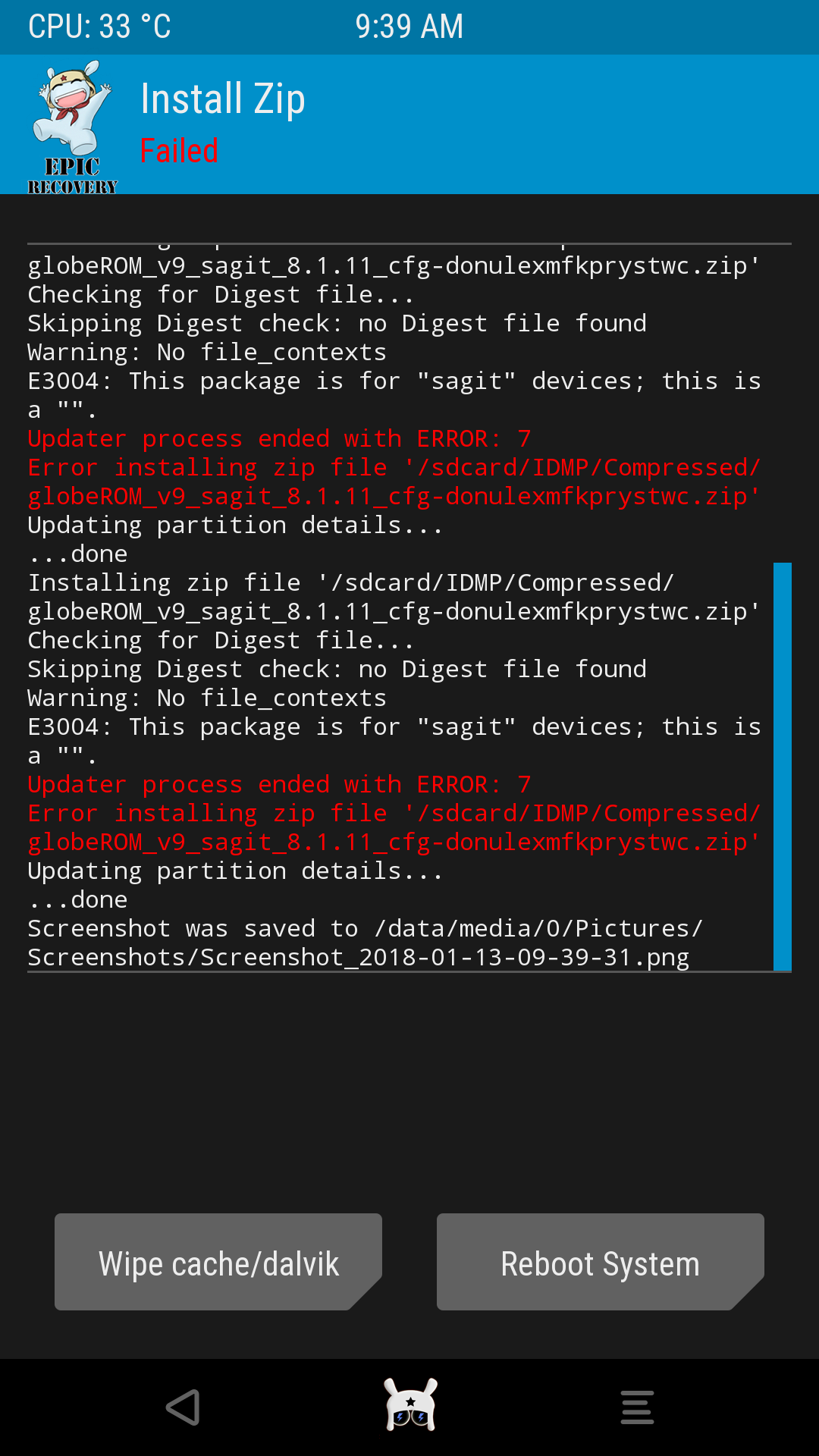

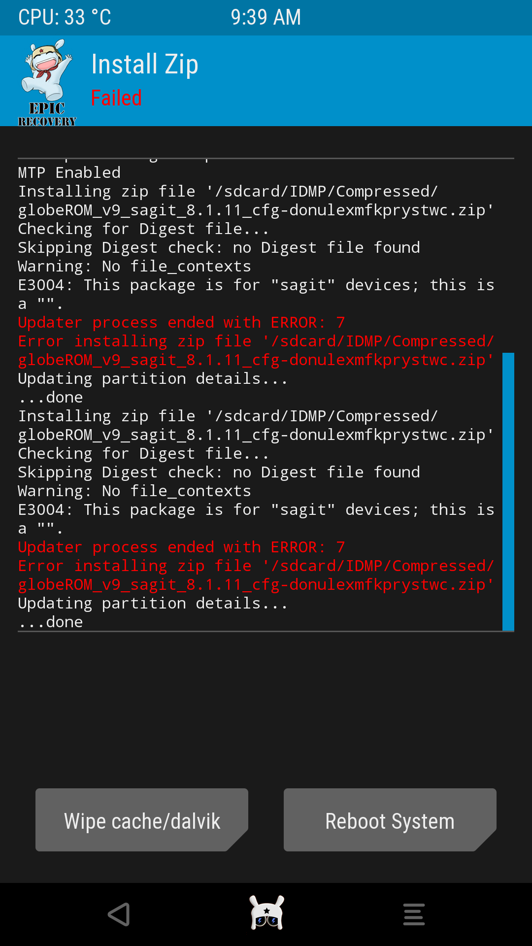

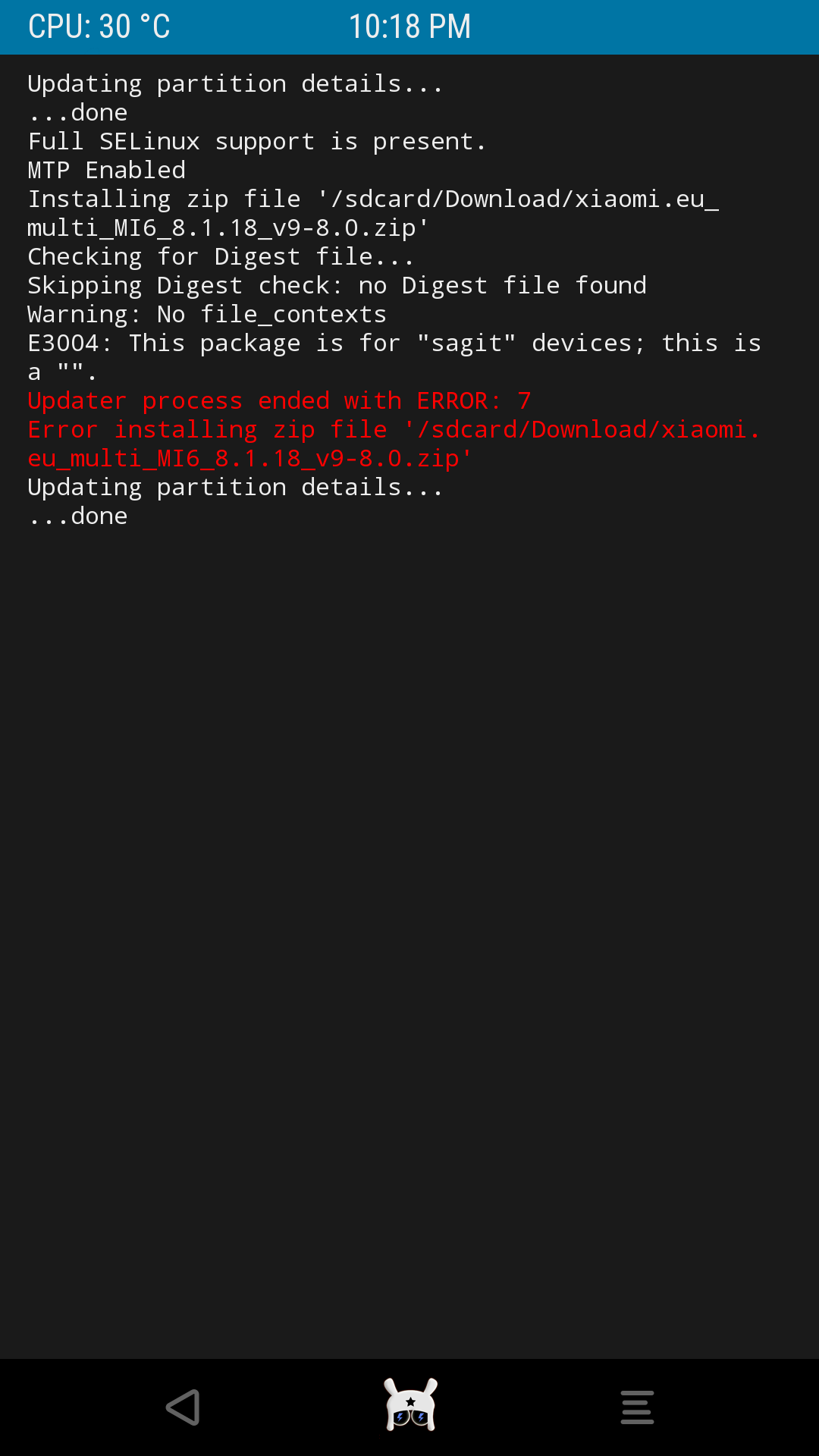

Can't update the ROM . It used to work either by twrp or updater.
N neale Members Jul 10, 2015 4 13 Jan 20, 2018 #1 Can't update the ROM . It used to work either by twrp or updater. Attachments Screenshot_2018-01-19-22-18-38.png 107.2 KB · Views: 574 Screenshot_2018-01-13-09-39-31.png 226 KB · Views: 601 Screenshot_2018-01-13-09-39-36.png 231.4 KB · Views: 589
ingbrzy Xiaomi.eu Project Leader Staff member Feb 11, 2012 11,601 322 Jan 20, 2018 #2 Even worse..! you cant read...!
N neale Members Jul 10, 2015 4 13 Jan 21, 2018 #3 ingbrzy said: Even worse..! you cant read...! Click to expand... ??? The two files are sagit for mi 6 . So explain?
MeiGuddet Members Apr 29, 2016 1,568 297 Jan 22, 2018 #4 @neale: Did you update your TWRP to 3.2.1.0?
N neale Members Jul 10, 2015 4 13 Jan 22, 2018 #5 No, I'm afraid it won't boot into OS without wipe. I don't want to install from beginning. Am I wrong?
MeiGuddet Members Apr 29, 2016 1,568 297 Jan 23, 2018 #6 TWRP is installed with TWRP itself or with fastboot, not with OS. Wipe data or even format data is necessary when your are on a different ROM than eu. You can make a backup of your data in TWRP before installing eu-ROM. Fastboot commands: Code: fastboot flash recovery twrp.img fastboot boot twrp.img Last edited: Jan 24, 2018
