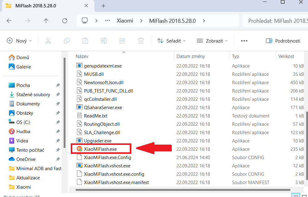

Try using this version of Miflash: https://www.mediafire.com/file/99tudj9roum1kpo/MiFlash_2018.5.28.0.zip/file
This version does not install, you just run it.

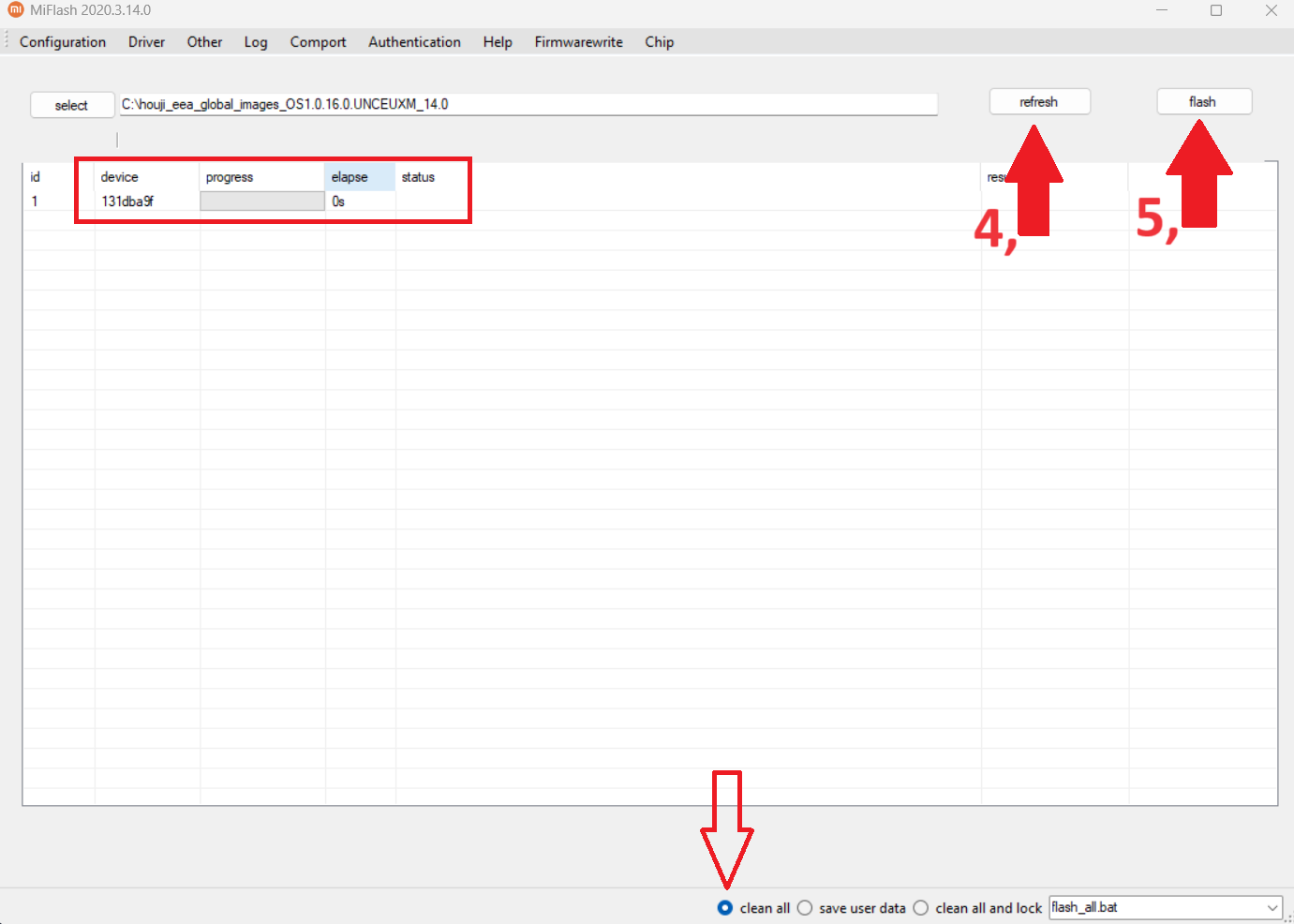

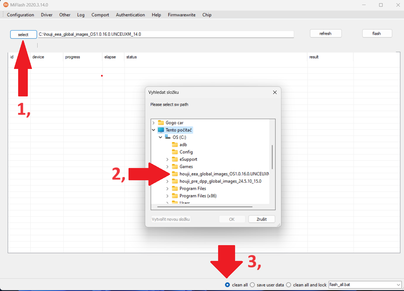

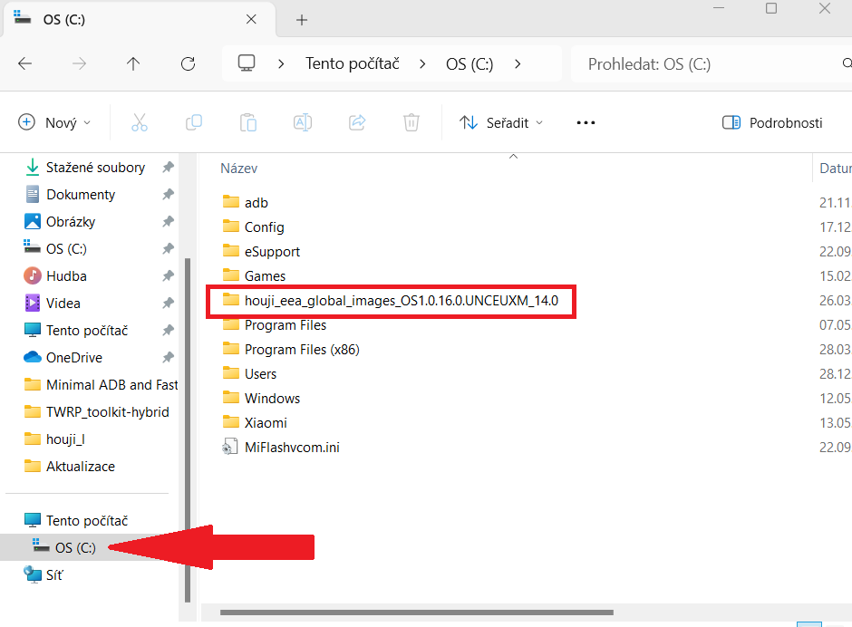

Snímek obrazovky 2024-05-22 132814.pngBez názvu.pngSnímek obrazovky 2024-05-22 131747.pngSnímek obrazovky 2024-05-22 132250.png

Hey, thanks for the tip ! Had a quick look, I don't find the log folder.. But anyway, the version proposed below does work. But thank you very much !
- Download stock fastboot ROM (tgz.)
- Extract and paste in the root of C drive.
- Run Miflash
View attachment 53490View attachment 53491View attachment 53492View attachment 53493

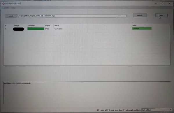

I did what you @gogocar62 kindly told me : extract the folder from the rom, placed it at the root of pc, selected it on MiFlash.. :
All looked right, flash was said by tool to be succesfull. BUT... the phone is in bootloop......!
