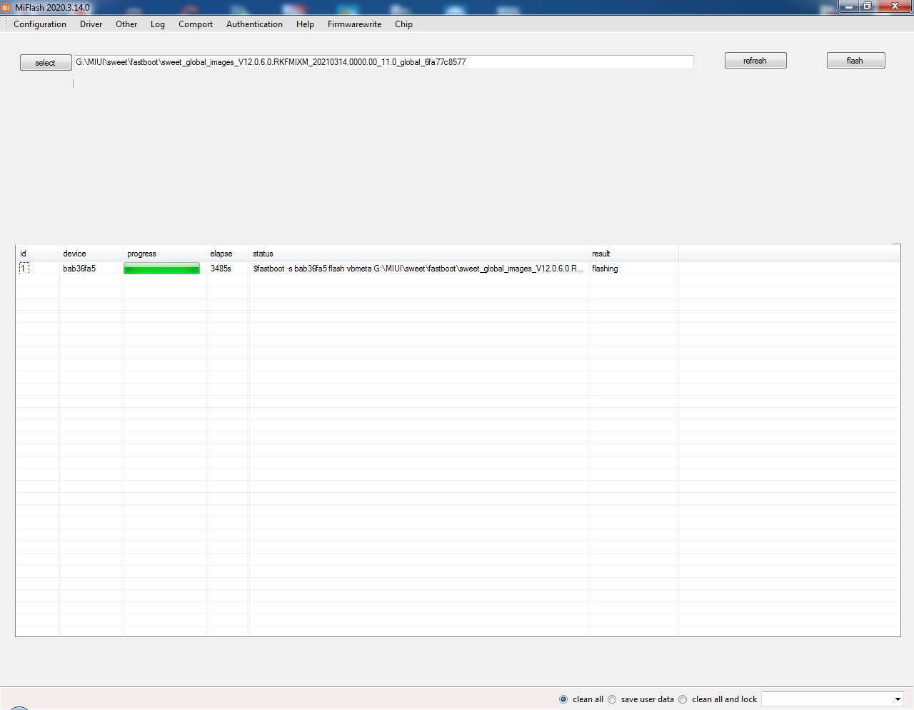

I`ve tried to install a fastboot rom but stuck on fastbootloop. Now I have downloaded the official 12.0.6 fastboot rom but MiFlash is 3000 sec and counting. How long will it take. I think it is stuck.
Is there any other way to revive my phone?
