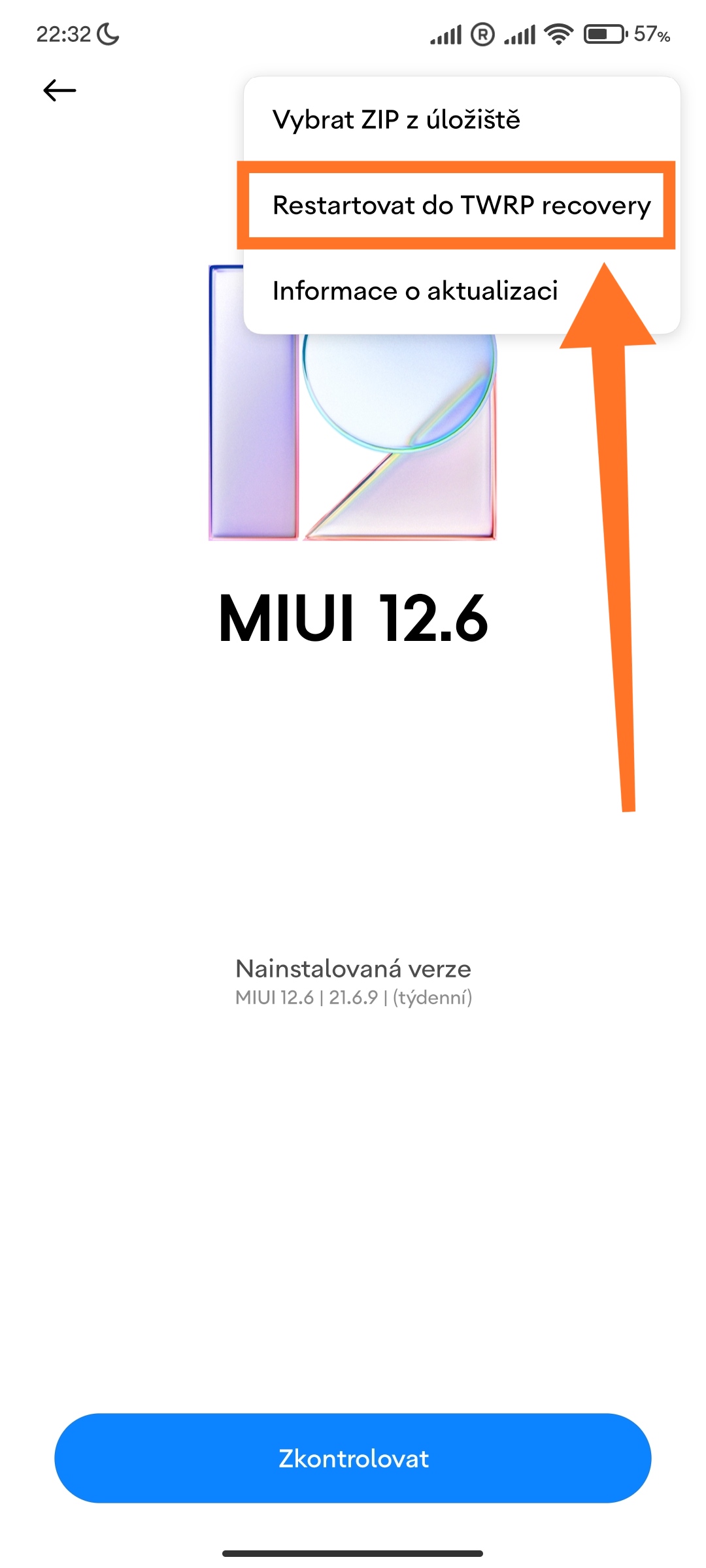

sorry one more question, for future ROM releases do I need to fastboot into TWRP everytime to do so? or is there another (simpler) way to boot into TWRP?
If you can boot to TWRP when you hold " Vol + " and " Power " buttons simultaneously, then you don't need to use fastboot. :)
If TWRP can't decrypt the /data partition (user 0), then try to use a pattern (instead of a PIN/password) for your screen lock, in phone's settings. ;)
no you do not have to
