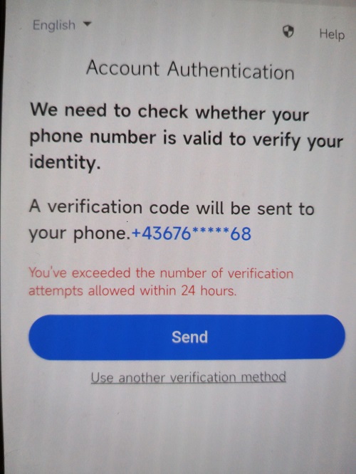

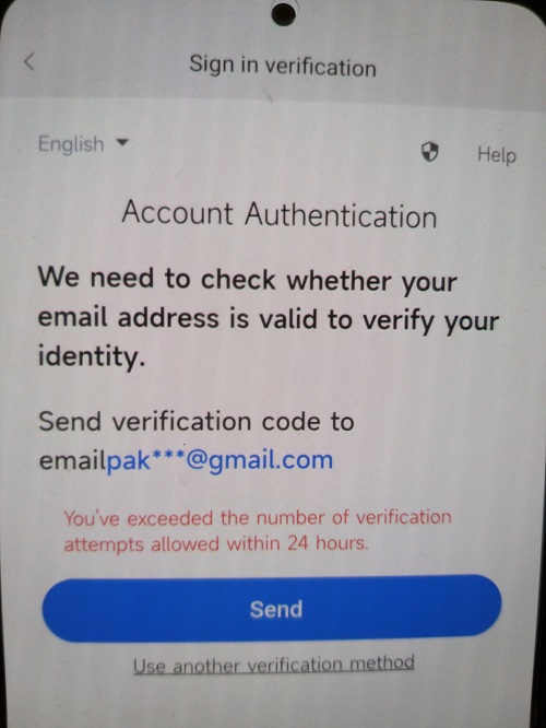

i installed xiaomi.eu hmk40-pocof3 stable fastboot. then i installed recovery skkk.I flashed xiaomi.eu weekly version via recovery.

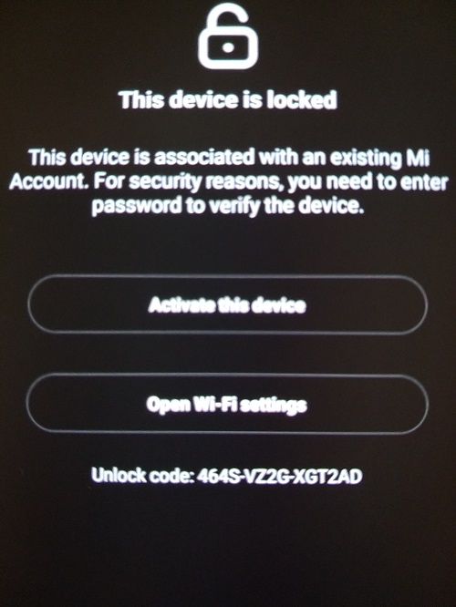

install weekly---format data---device booted---activate device does not work---enter password---screen goes back to activation---
enter password again---screen goes back to activation---many tries and now I have to wait 24 hours.

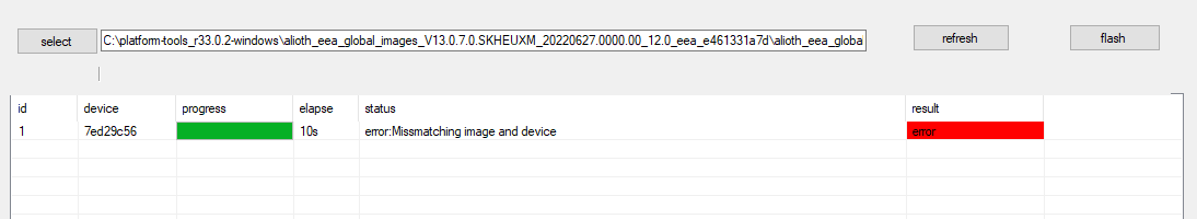

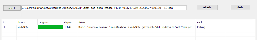

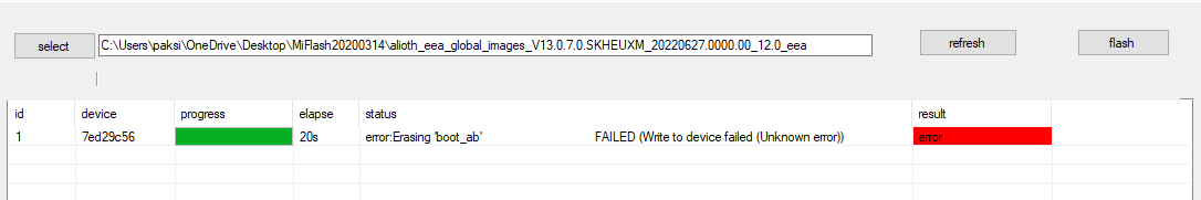

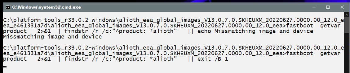

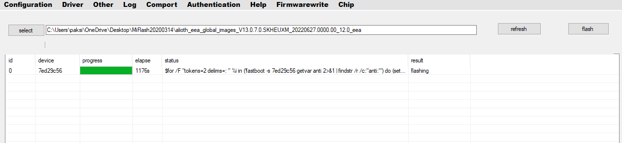

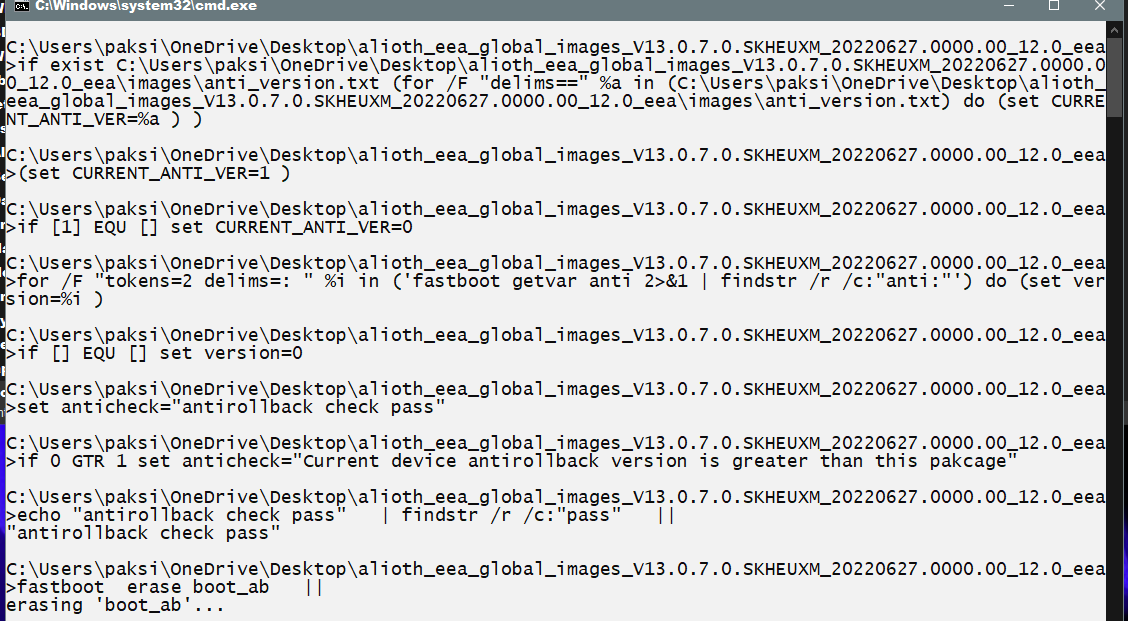

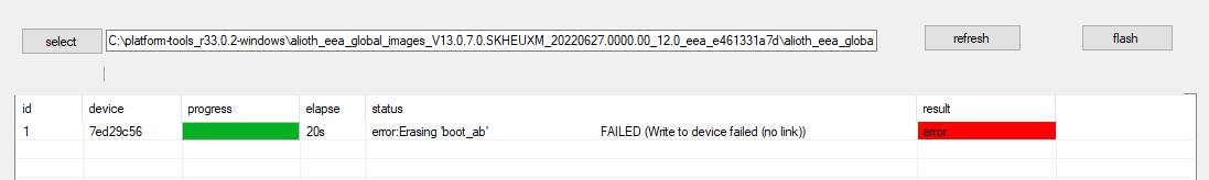

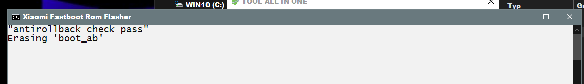

now tried flashing firmware miui 13---after many problems the flashing continues but never finishes.

Please, how can I finally solve this? Password sometimes goes wrong. Can this be solved forever? Permanent?
Phone number and email are yours?
If NO, this phone has been locked by previous owner or seller.
you must contact them.

I reinstalled everything on the PC. Restarted. Miui installed. Everything went well.
Phone starts and again ACTIVATE THIS DEVICE.Enter password-Perform authentication-Miui won't start-only available for a limited time SELECT LANGUAGE-and then screen jumps back to ACTIVATE DIS DEVICE
I'm desperate!
