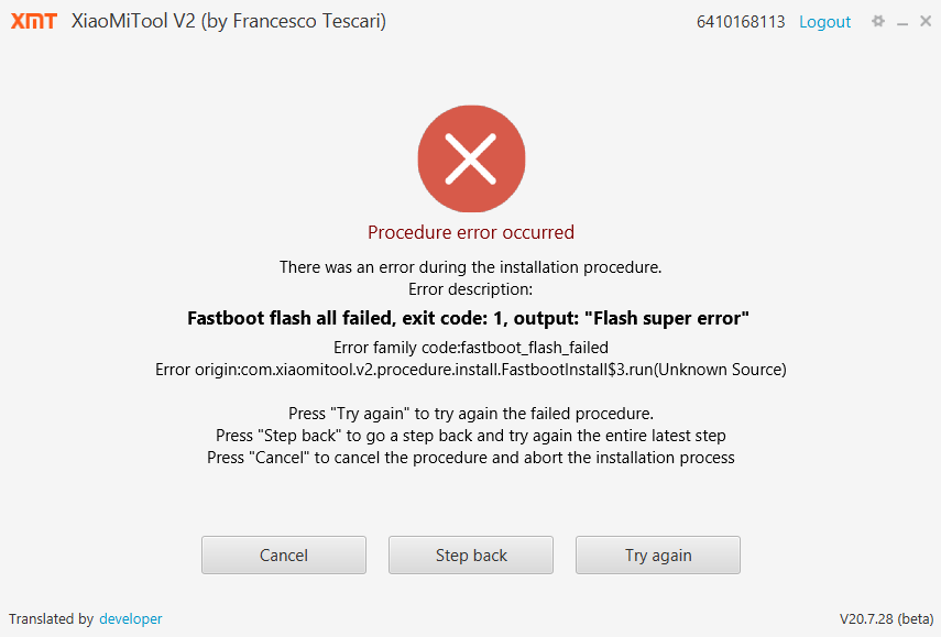

Hi, yesterday I tried to flash a new rom on my Redmi note 10 pro using Xiaomitool v2 By Francesco Tescari, but during the installation I had an issue, as in the image below.
38451
Somebody knows a solution for this problem? Thx very much

check if your bootkoader is STILL unlocked.
You have better to use MIFLASHtool that is simplest to do this job.

XIAOMI add some check point in the flash script and one of it is blocking the flash process for unknown reason.
It is just to remove the relevant instruction to let the flash going on.
Not very difficult, you just have to be skilled enough to do it.

Xiaomi Tool v2 a piece of s**t!
It may work properly with other phones, but not with Redmi Note 10 Pro.
I got the same error message when I wanted a firmware update.
Then I downloaded the latest ROM (Fastboot) and use the MI Flash application.
This is correctly installed the latest ROM.
