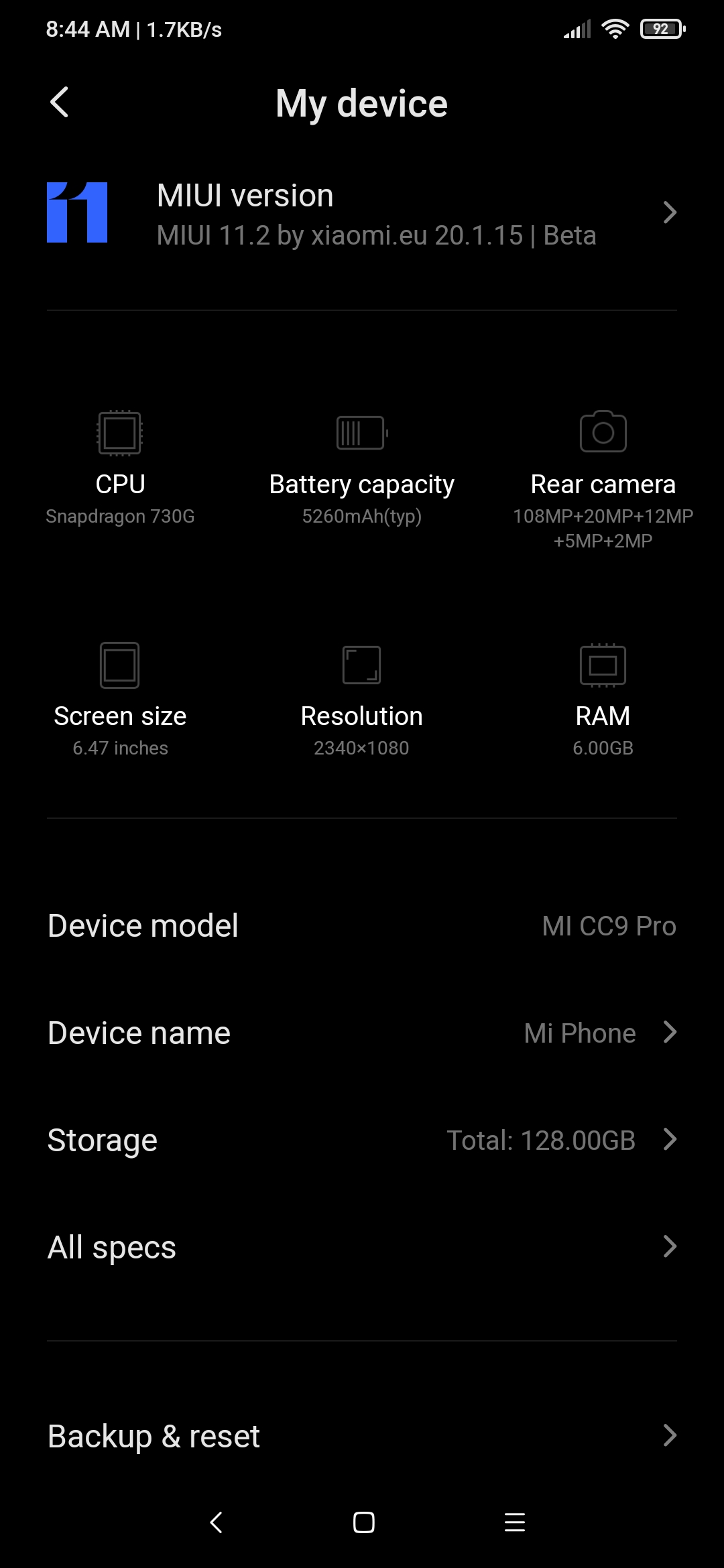

Latest weekly 20.1.15 is working good. 108mp processing seems faster. Battery life is better. Format Data before switching to weekly. Uncheck zip verification before flashing the ROM
