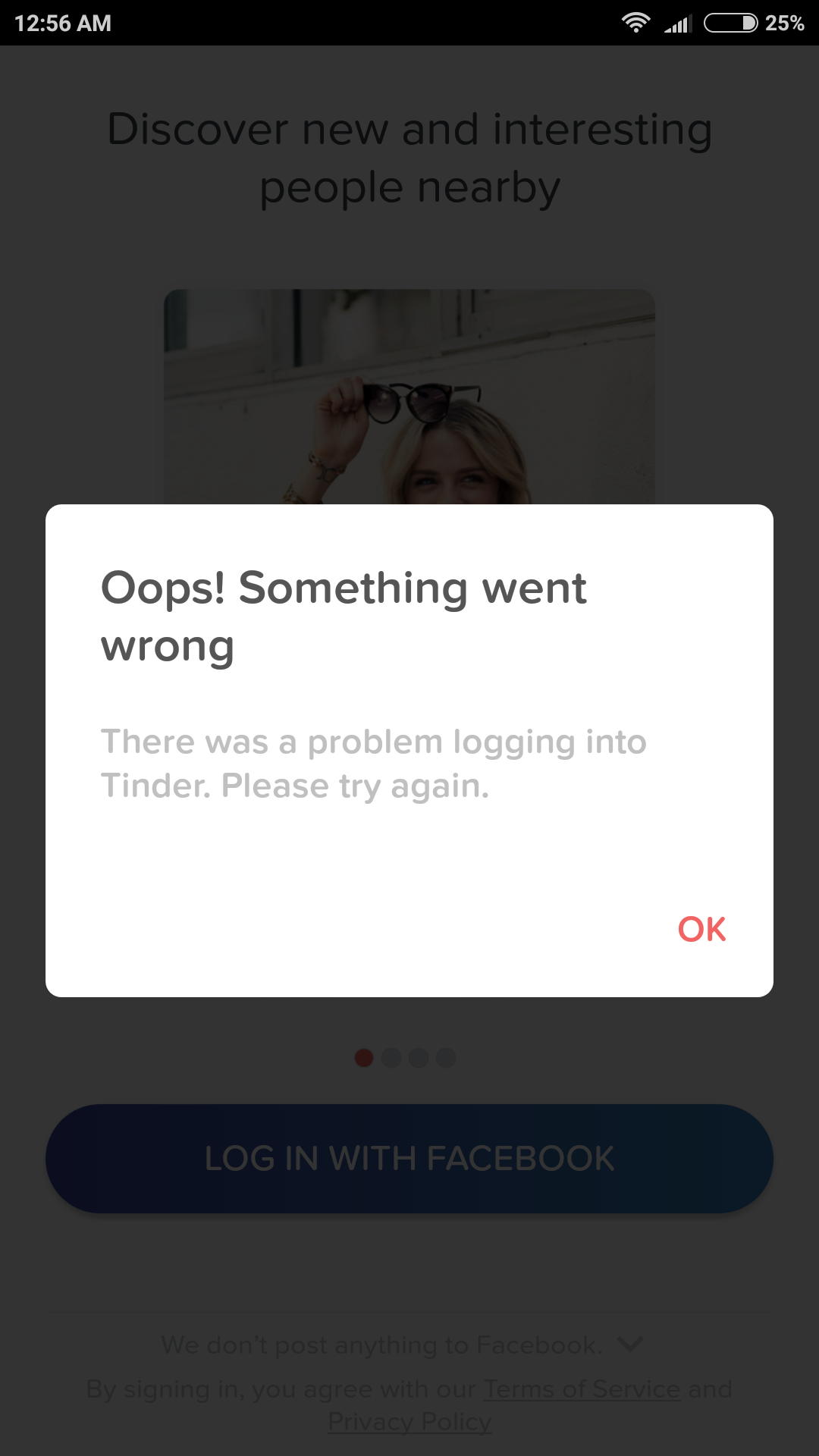

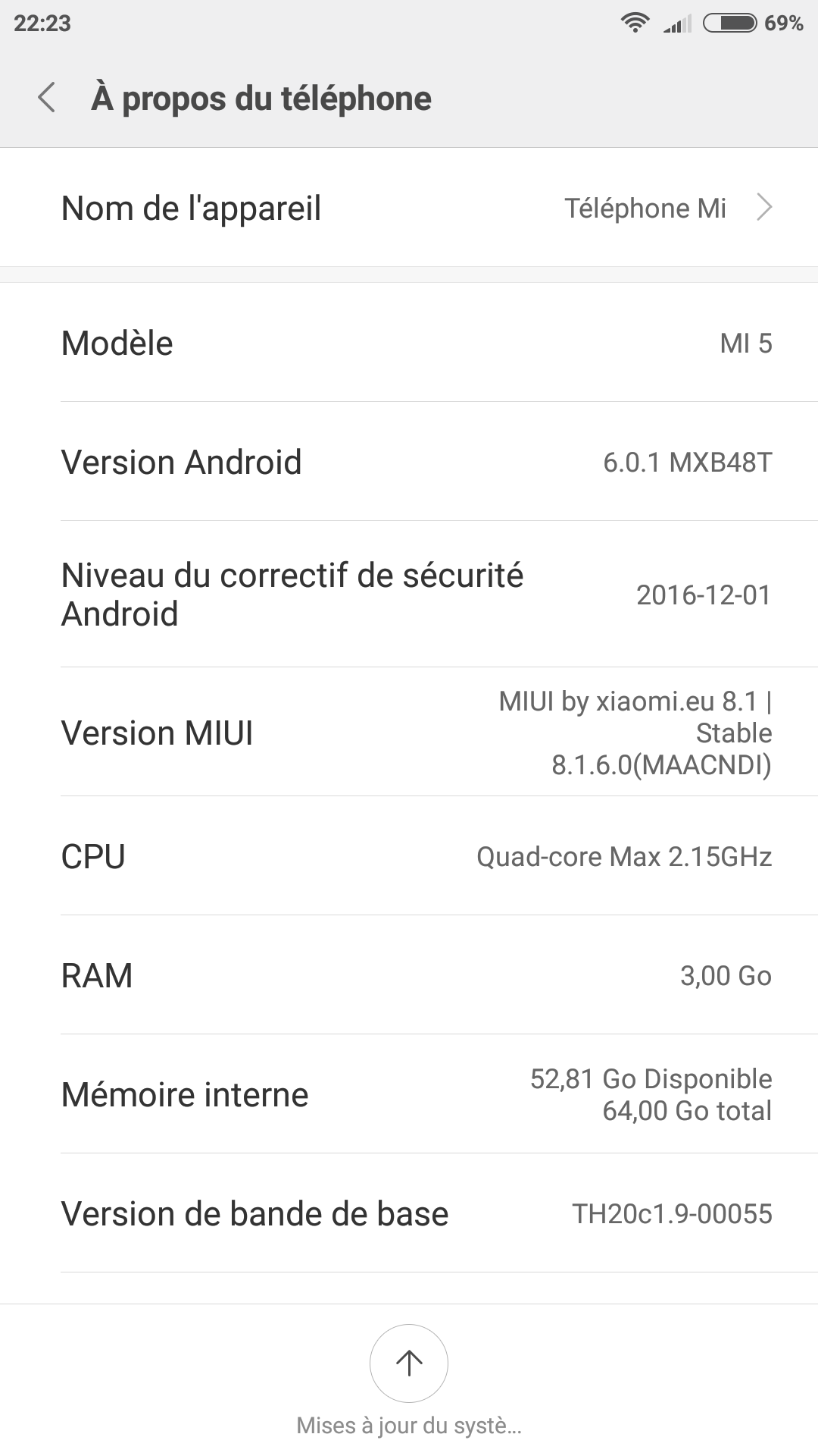

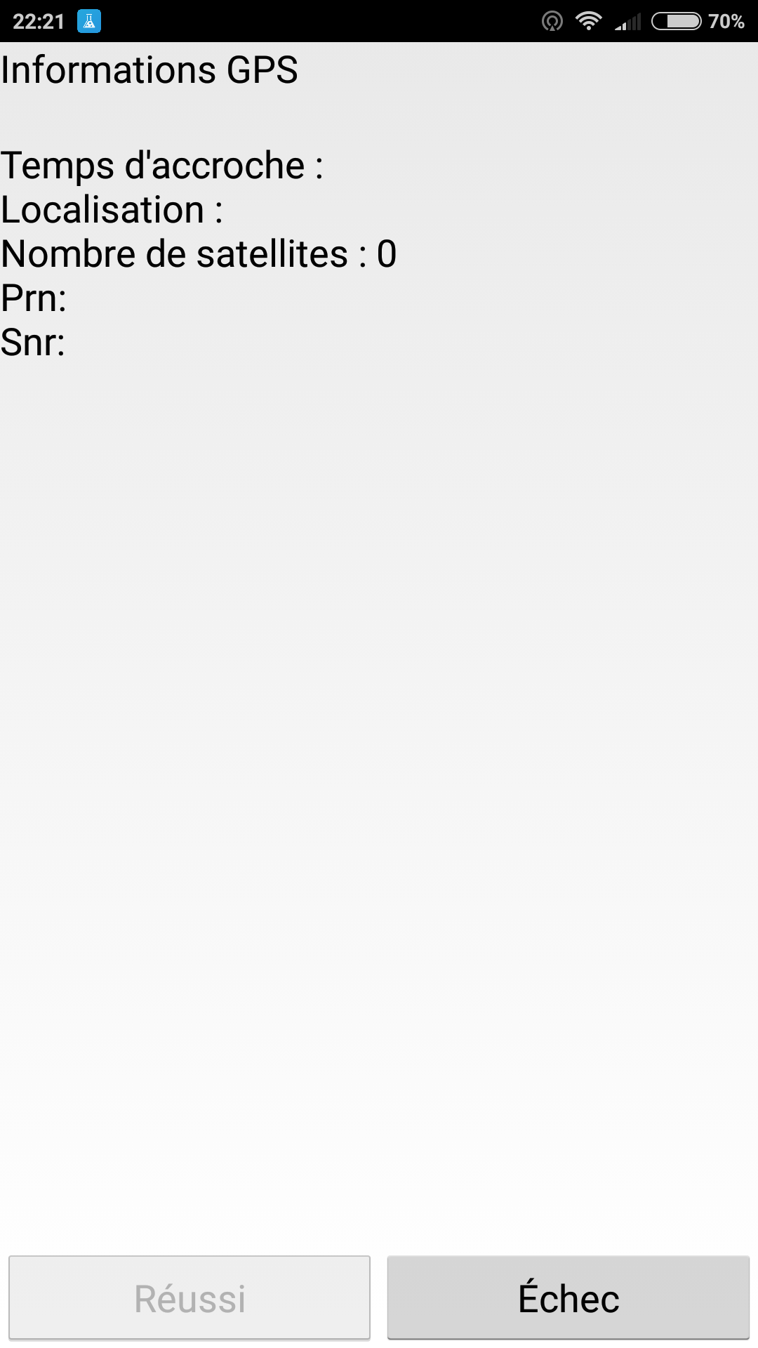

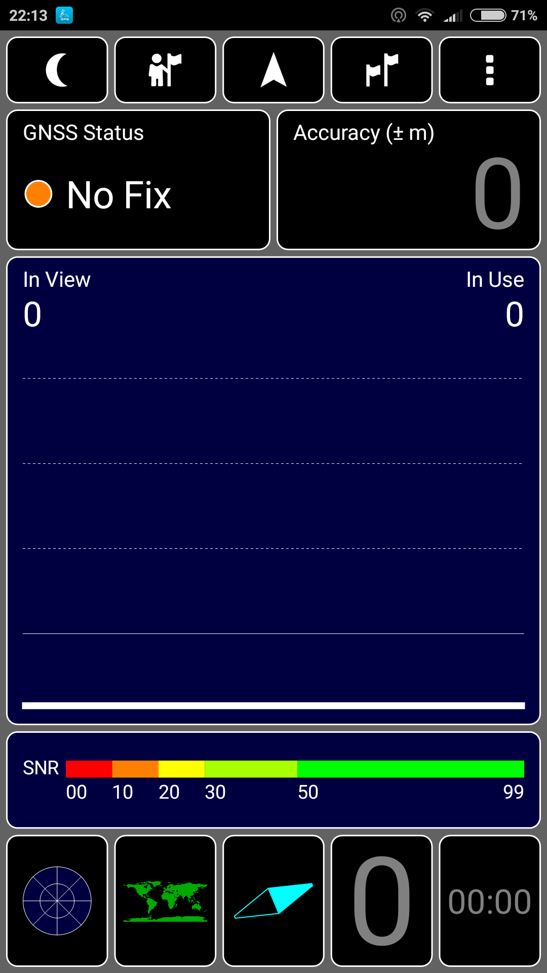

GPS doesn't work at all on my MI5, I tried everything and nothing happens, even tinder can't connect to the network when I open the app! Plz help, I am on MIUI.eu 8.1.6.0 stable!

Clear dav and cache with twrp.

I also had the problems with gps on navigon and gps status app, on the phone in the settings i first cleared data and cache, than i uninstalled it. After the new installitions for me it looks like that my gps problems are fixed
I have MIUI 8.1.9.0 stable, i installed this update with wipe cache/dalvik but the problem persists
Factory reset from the settings.. tinder work now fine, but the GPS it's sow slowly to connect, I think it's a real hardware problem from xiaomi because I never seen a GPS like this in my life!

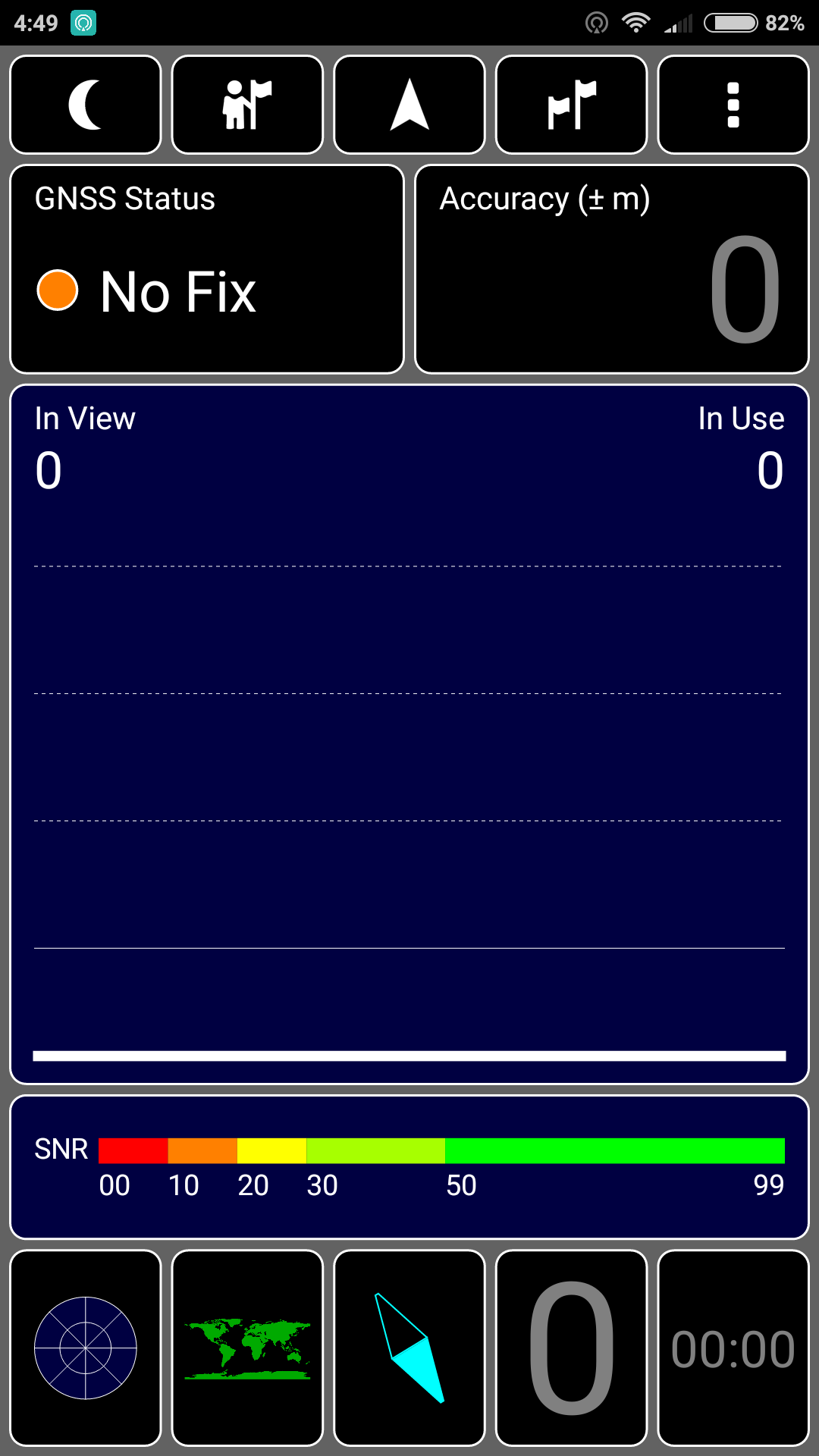

Being on the last Miui 8 7.2.9 seems to keep the problem of gps, even in the kernel menu, it takes like 3 minutes open air to catch gps signal and lock.
I have used a simply app and seems to work.
The app is GPS Status & Toolbox. The app clean and apply appropriate GPS settings and after that the fixing is fast. Tested only one time yesterday, but I think that it works always (the cleaning and the download of the GPS settings must be performed only one time, not all the times that you use gps).
